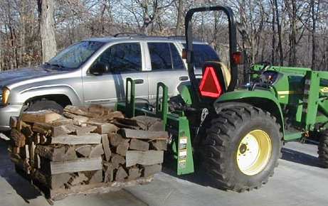

About 20 pallets per winter is what I go through. Covered with a 4x4' sheet of used rubber roofing. This load is a partial stack showing the iMatch and forks used, and so quickly can switch with the ballast box during winter. At 20 below, it is great to only have to spend 5 min. bringing in another 5 days of firewood for the boiler. (the split pieces are stacked on the pallet right when they come off the splitter, then stored outside for two years, two-pallets high)
