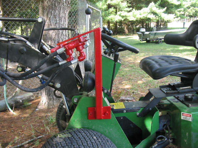

Controls on the PT.

Nice work on the valve placement and the ROPS assembly, now you have a place to mount new lights for splitting wood after dark and other things as well. Keep up the good work.

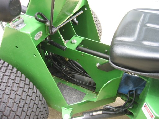

This pic kinda shows how the hoses are hooked up to the PTO

Thanks Highridge. I used the PTO and added a log splitter detent valve with 4 Hoses. The PTO is rated at 10 gpm. Although the auxiliary would simplify the task of making a log splitter it is only rated at 3 gpm and doesn't have its own pump. That would make the splitter much slower.

Excuse me for a dumb queation but, can you do that with the PTO? I thought the PTO needed a constant flow with the pump on or you would damage the pump?
I hear you are not to turn the PTO switch on when the tractor is running?

The log splitter valve has an open center. When the PTO switch is on the flow is just bypassing through that valve. You can leave it on no problem. Just when you kill the PT it won't start till you turn the PTO off. Then flip back on and you can leave it on the duration of the splitting session.

Just make sure the splitter valve, hoses and fittings are rated for the full PTO flow. You may also find that you get perfectly good performance (speed) at less than full engine RPM which would lower maximum flow through the system.

Good point Rip. I used 1/2" hoses with size 1/2" pipe threads. Although the valve and cylinder was ported with 3/4" threads this size seemed to be plenty large enough to handle the full throttle full flow of the PTO. At full throttle using a 4" X 24" cylinder the cycle time was less than 10 seconds. As you stated it was found that I was satisfied with the speed and power of the splitter at 1/2 throttle.
My reasoning for thanking that full throttle full flow was being handled. When the PTO switch was turned on the engine would strain some for about one second then go back to the same Rpm and sound that it was before the PTO switch was turned on. Thus there didn’t seem to be any back pressure.
