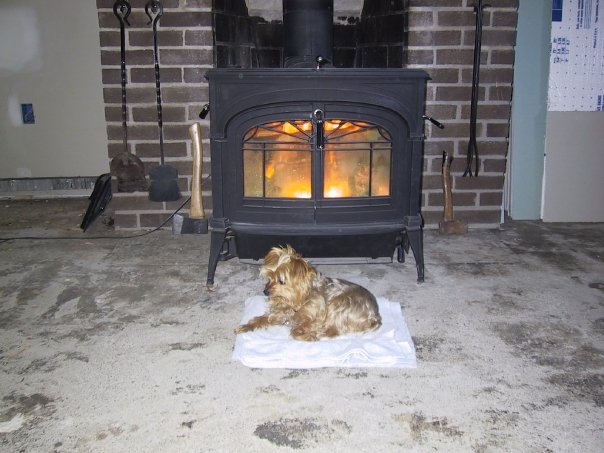

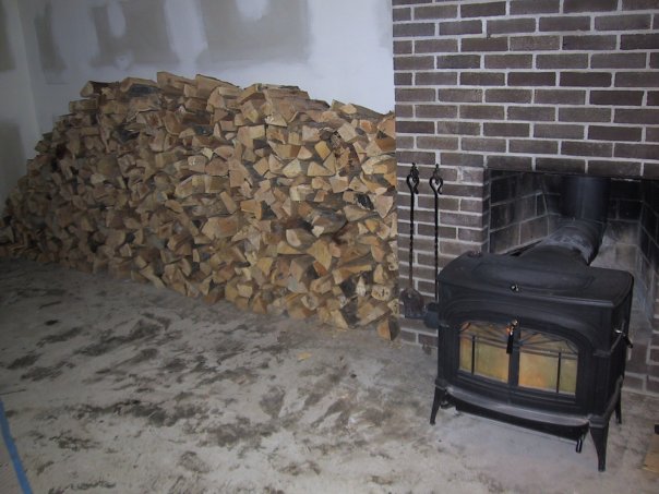

I had a masonry Fire Place like you in my basement.
I decided I wanted to heat my house with wood...not supplement, sole heat source.
I found a Vermont Castings Wood Stove on craigslist 3 hours away. I took two guys with me and we went and picked it up. It was all we could do to get it in the truck.
My local Wood Stove guy told me I could go old school and stuff the pipe up the chimney and insulate it with unfaced insulation. That's what I did and it worked fine though I will say that I had to replace that insulation every season.

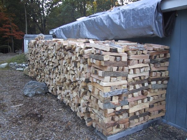

I converted my entire basement which was under renovation at the time - into my wood stove room. I had the stove in front of the FP and well off to the left I had a week of wood stacked inside. 4-5 cords were outside and I'd haul in a couple of wheelbarrows every day.
I am glad I went with a Wood Stove over a Wood Insert because you get a lot more heat from it, but the best part...I was also able to cook on it. Stove was always running so if I need to cook breakfast or dinner, it was ready to go. I also kept a wood stove steamer on there for moisture control.
If you have the room, go with the Wood Stove. If you don't, go with a insert that has a battery backup so it will work if you lose power.
