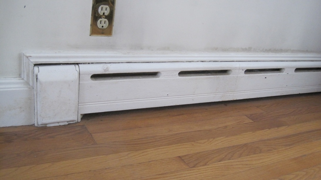

The house was built in 1950, it has a five year old oil fired boiler, the heat is transferred throughout the home via old style cast iron radiators. In the future I'm considering going with an outside wood fired boiler, but that's a ways off due to cost. Unfortunately with the existing fireplace I'm limited to an insert.
Those "Old Style" cast iron radiators...do they look like this?
I wish I had cast iron baseboard, no, the are the stand up style that sit on the floor against the wall.
