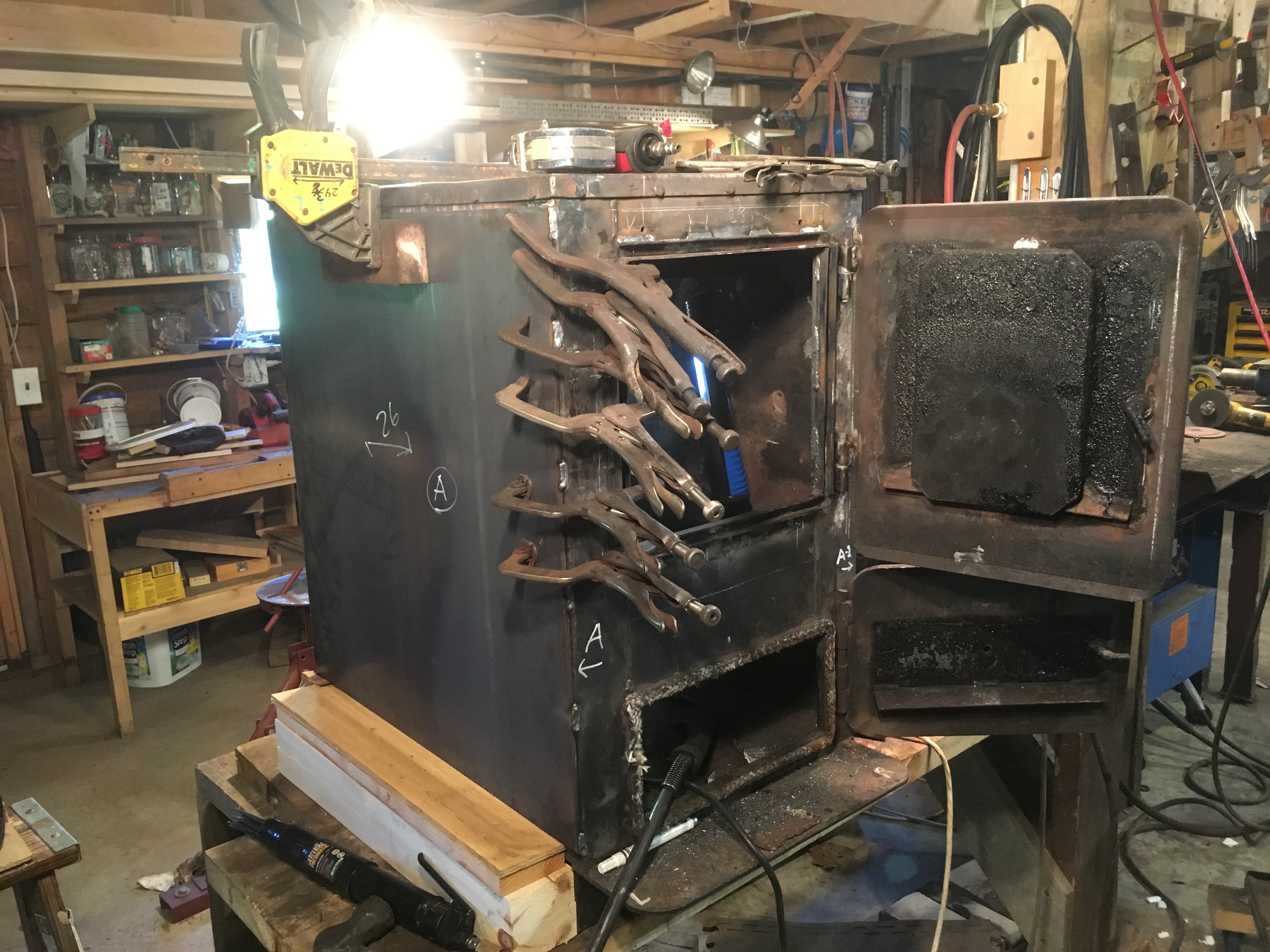

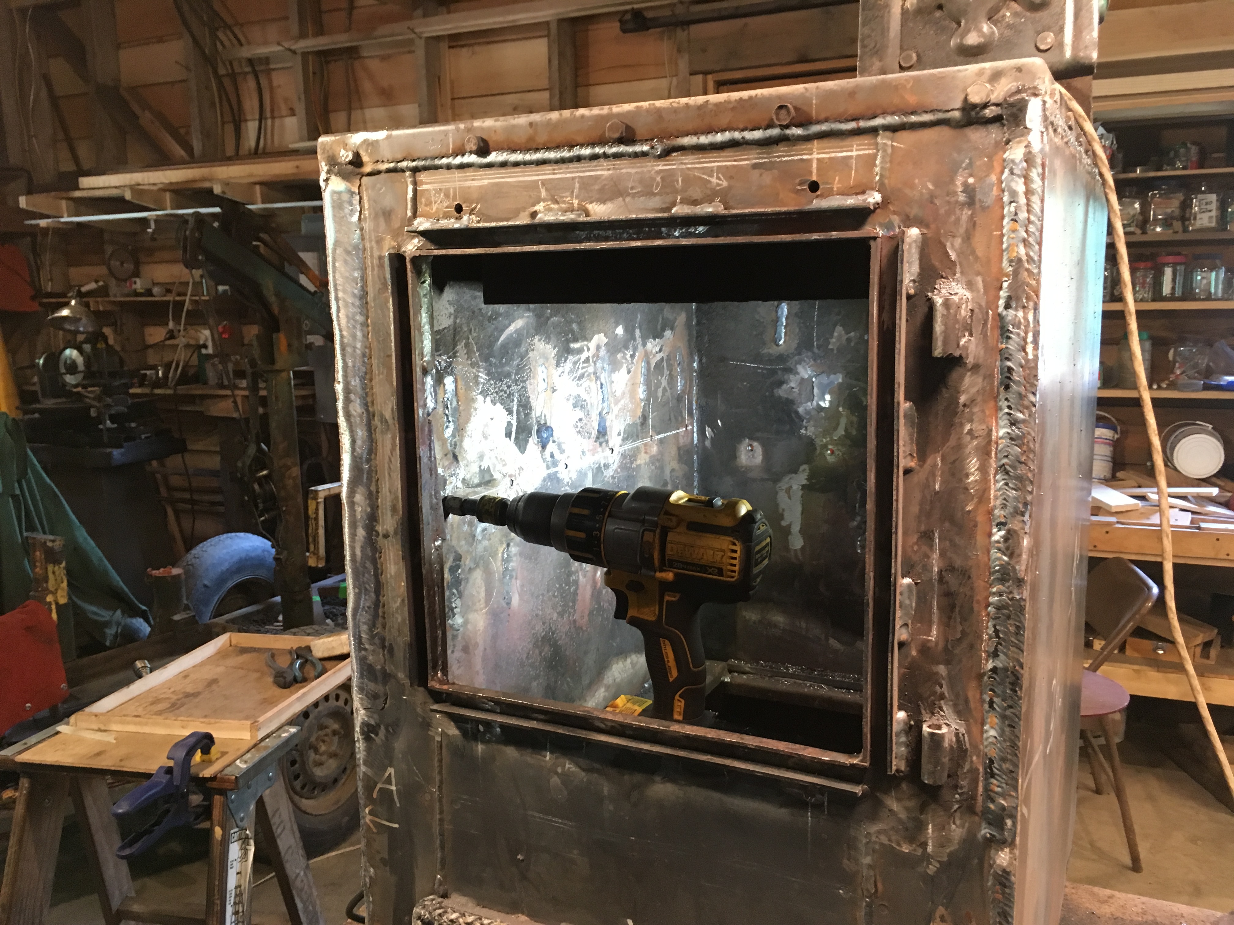

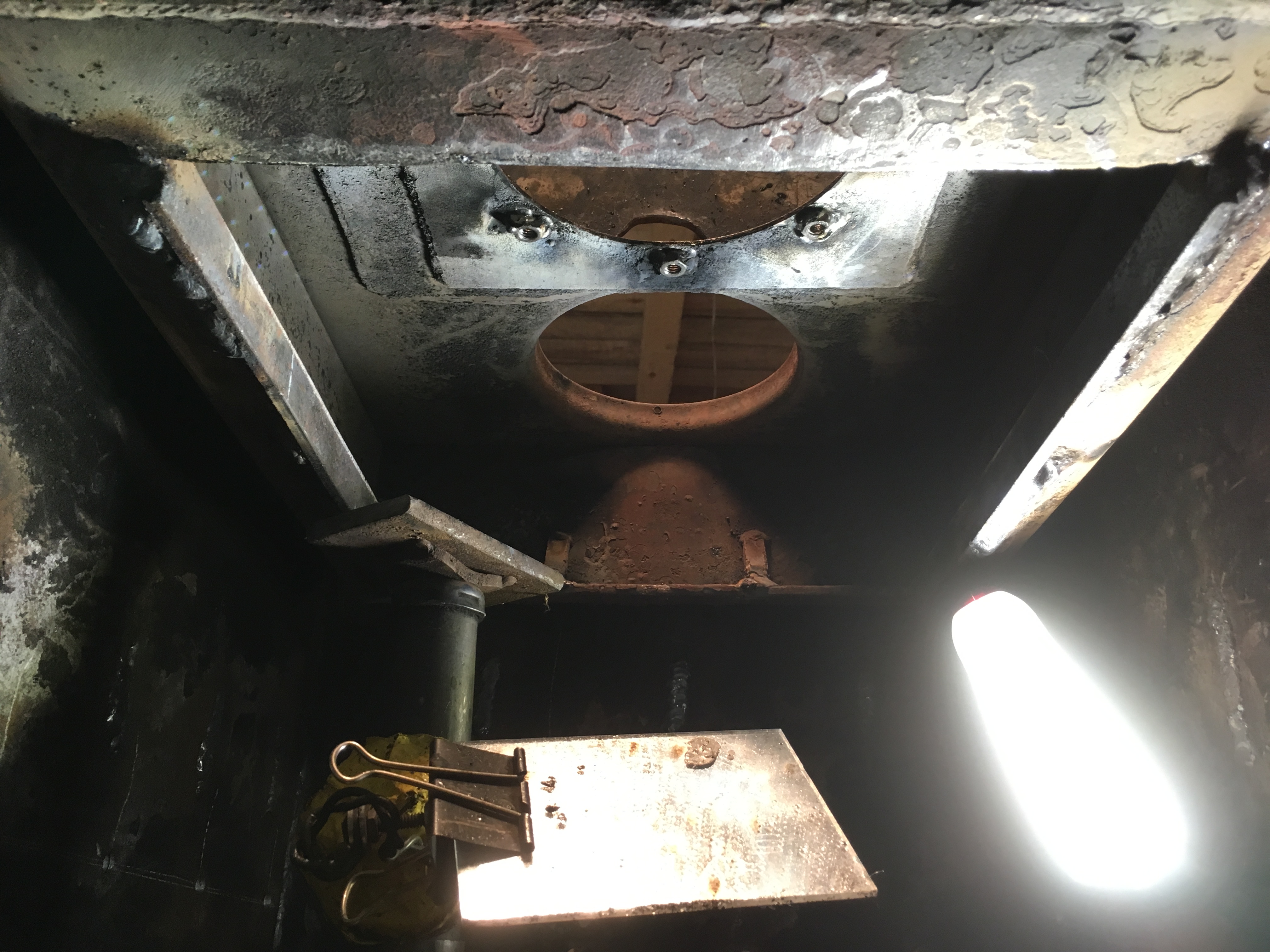

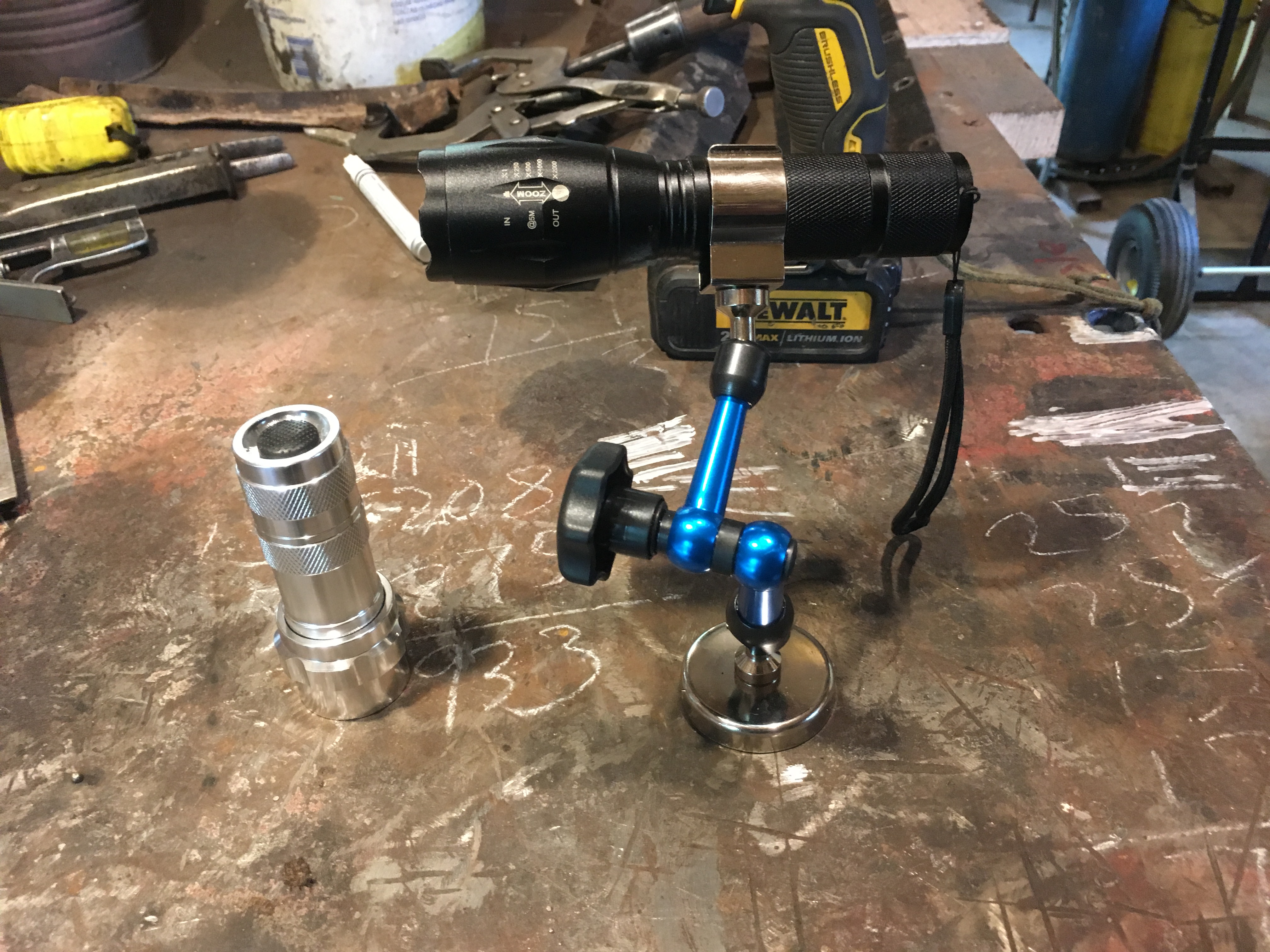

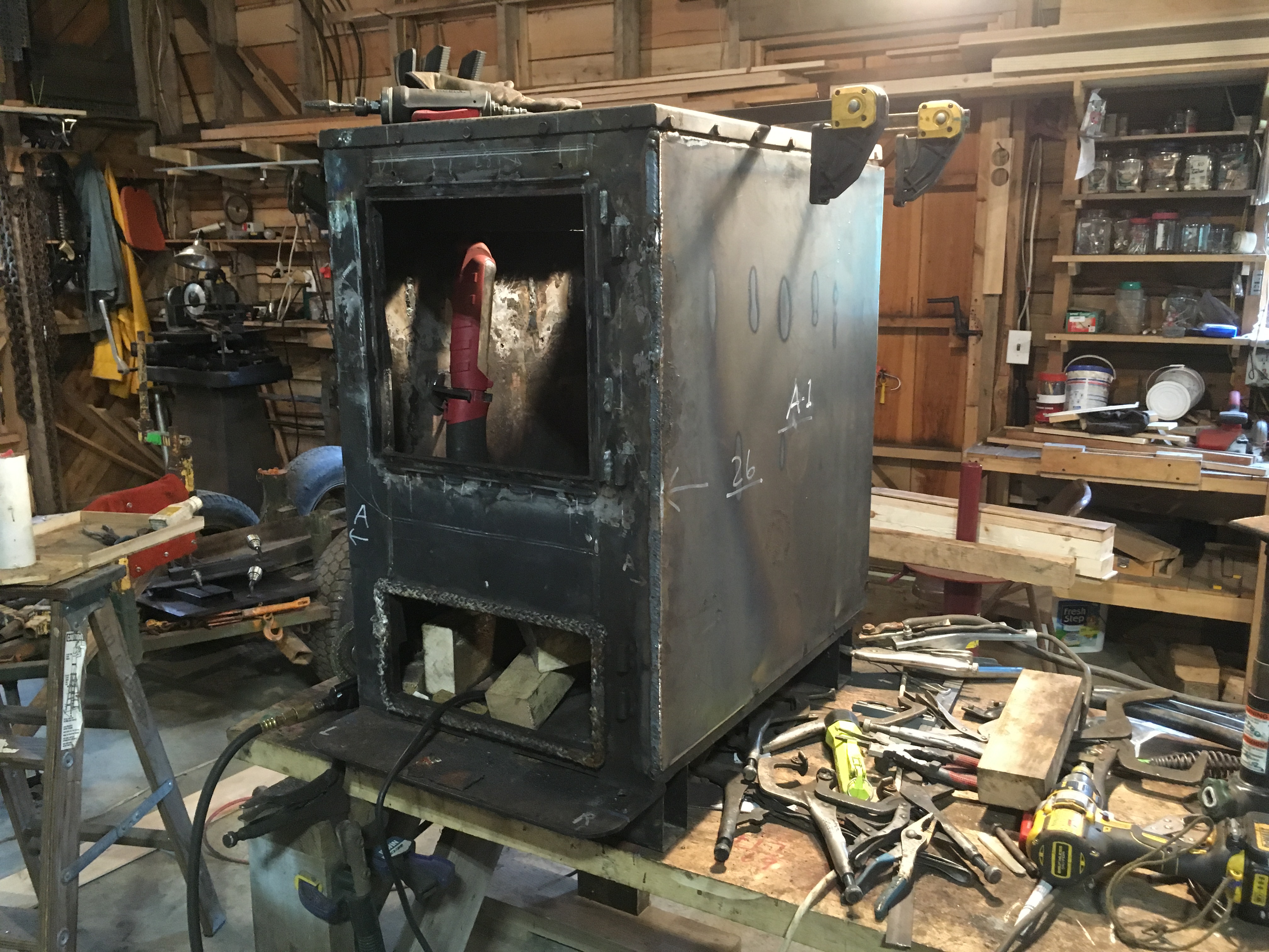

Made some headway this weekend, after struggling welding the inside front top corners of the stove because of the lack of pin point lighting, I search online from here to Timbuktu trying to find a magnetic flashlight holder with flashlight that can be articulated in any direction, I found one that fit the requirements cept the flashlight that the holder came with is not quite as pinpoint as I would've like so I swapped it with the one I had that has an adjustable beam, now I can see when doing mirror welding or any welding in dark places where a big light wont fit.

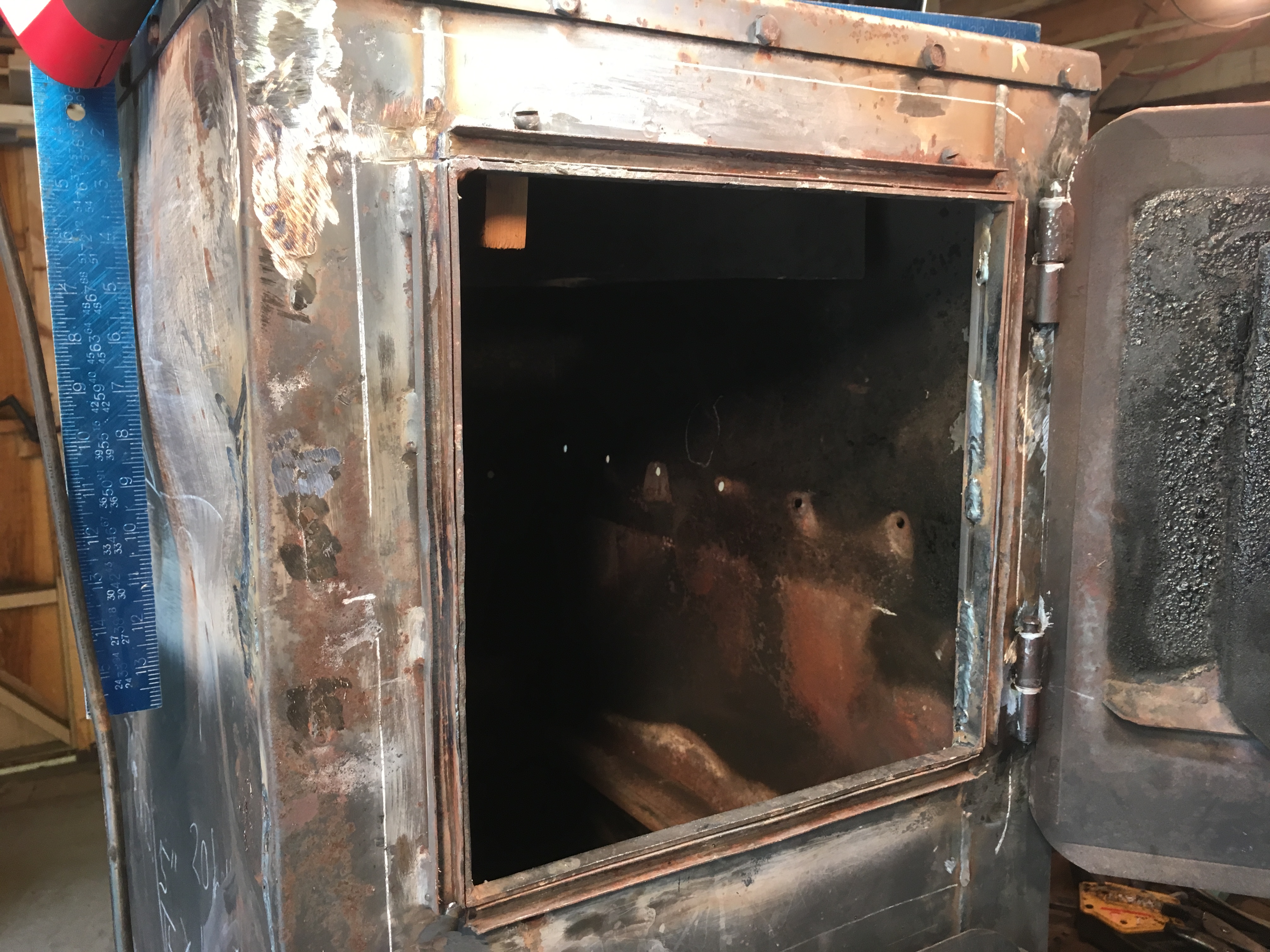

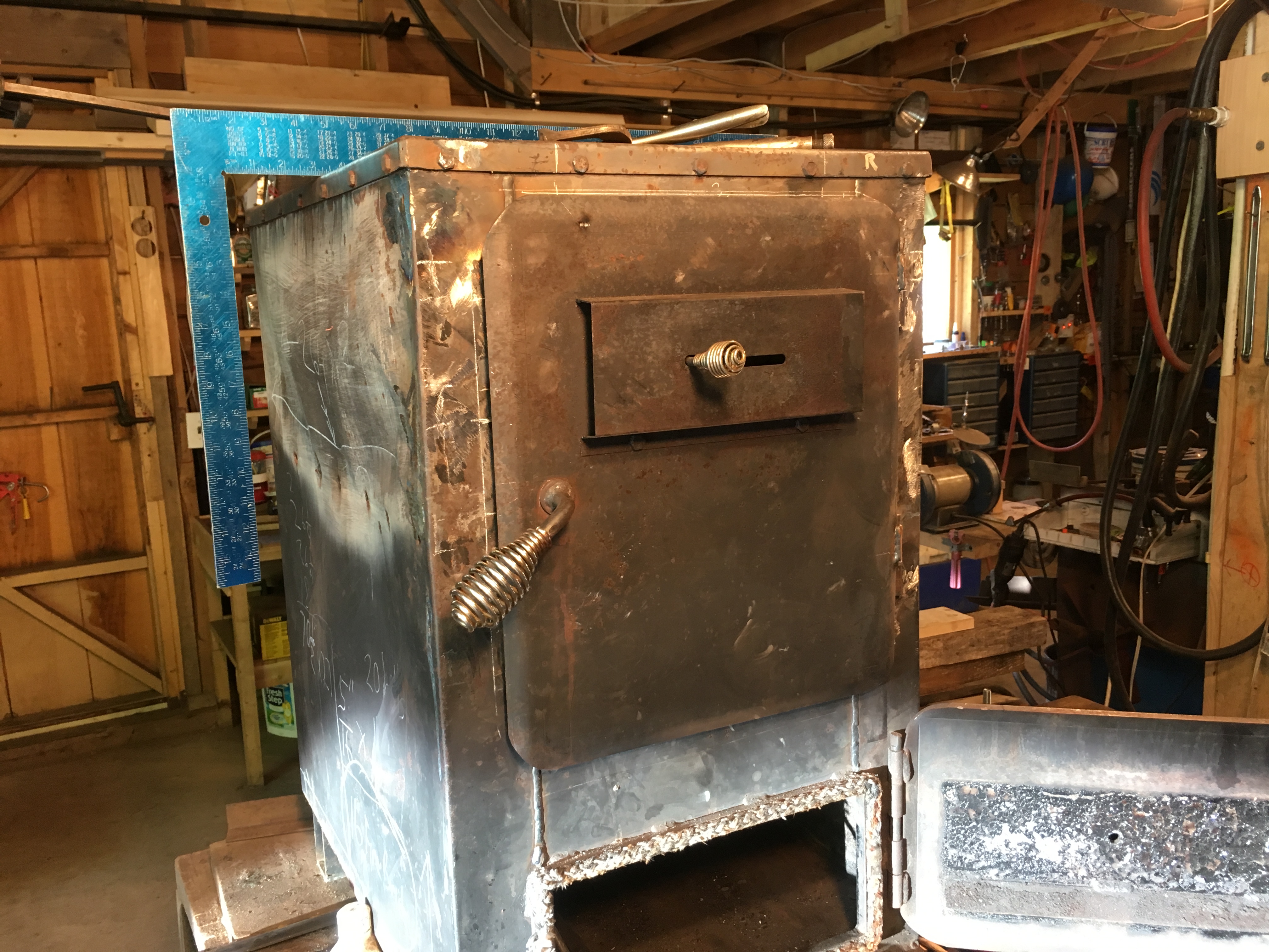

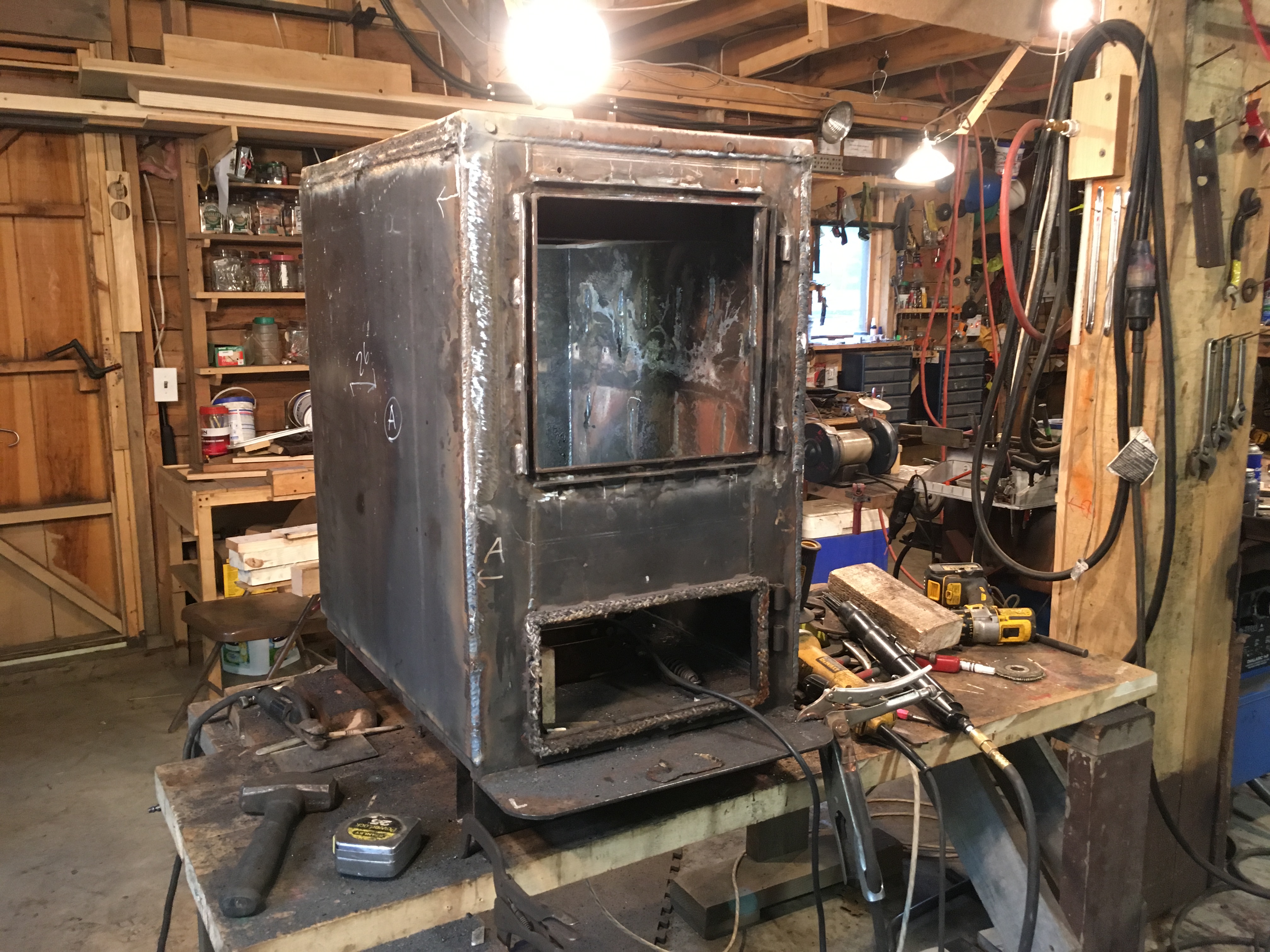

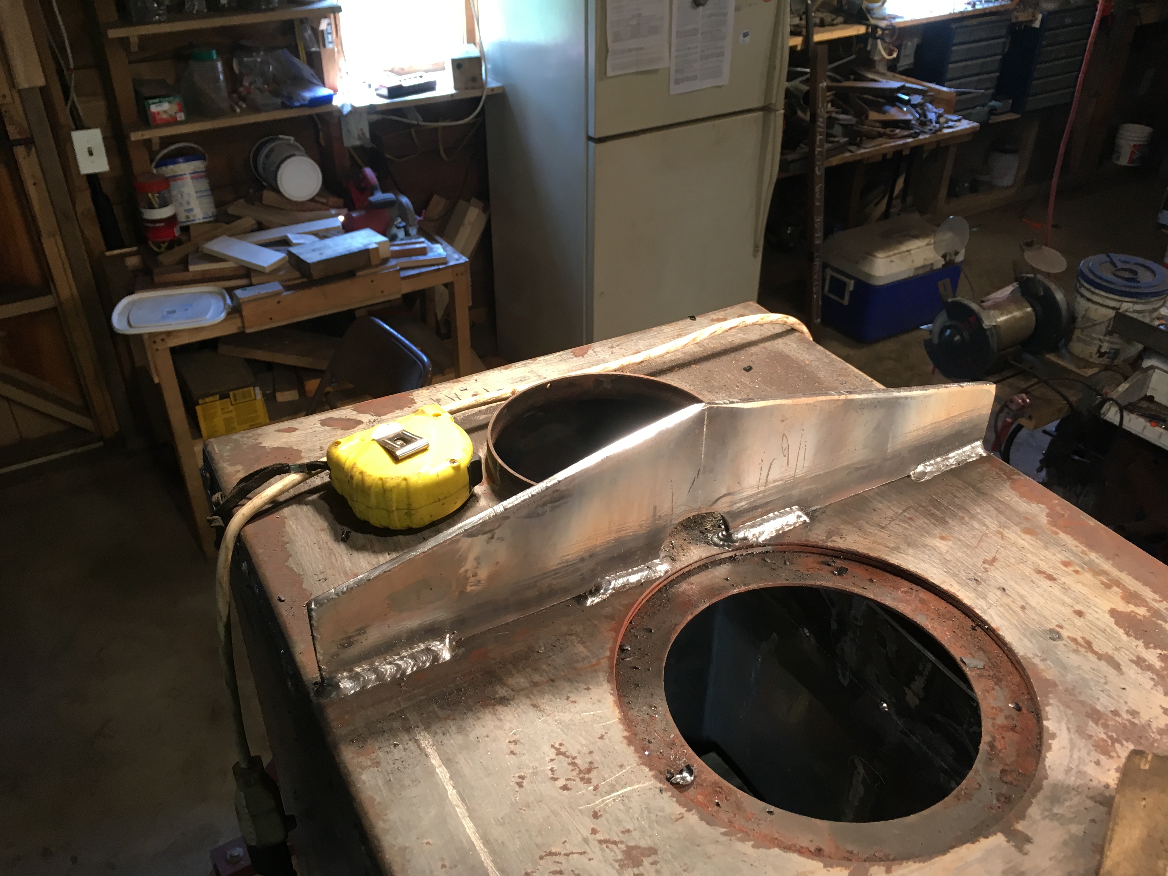

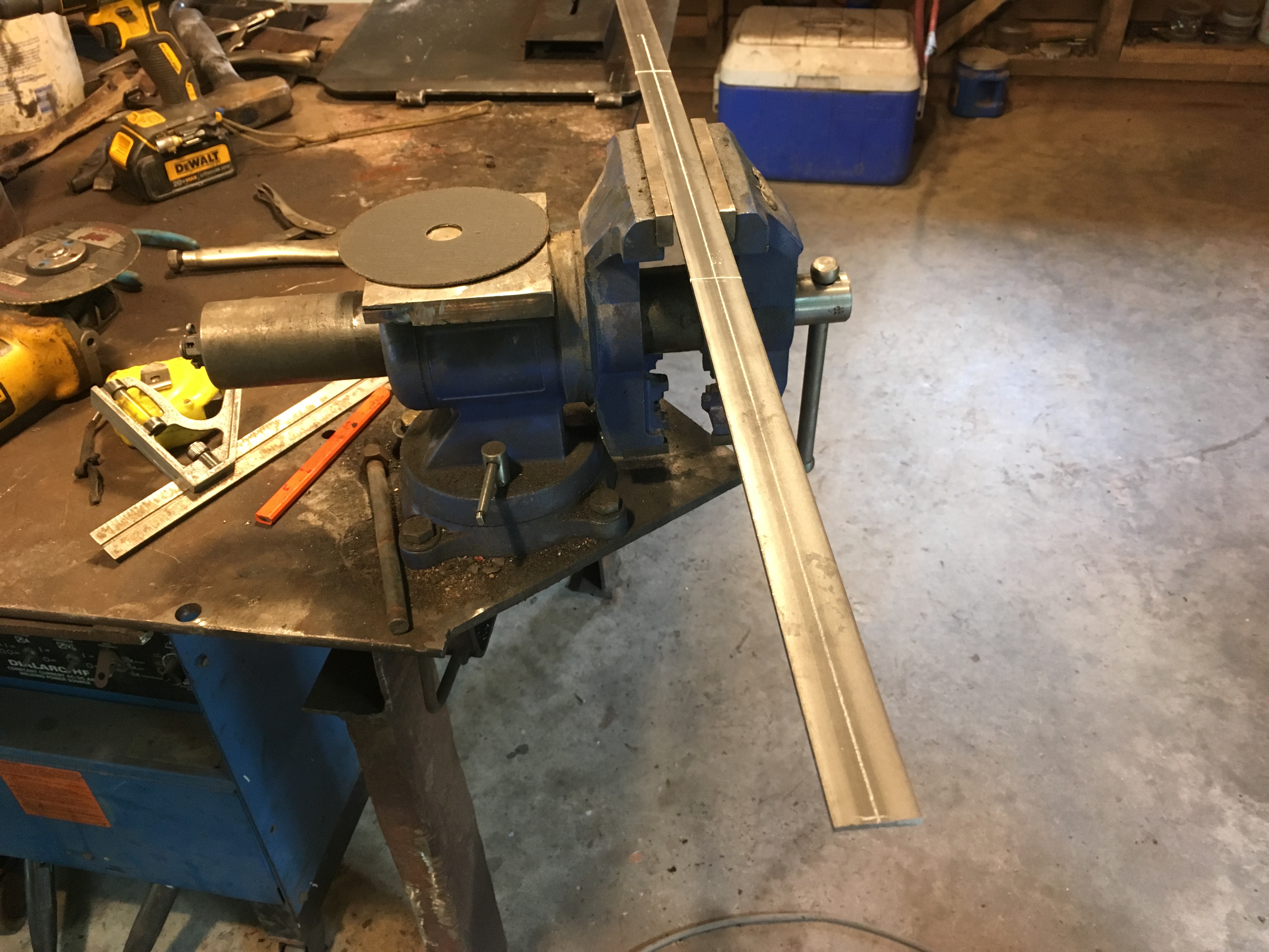

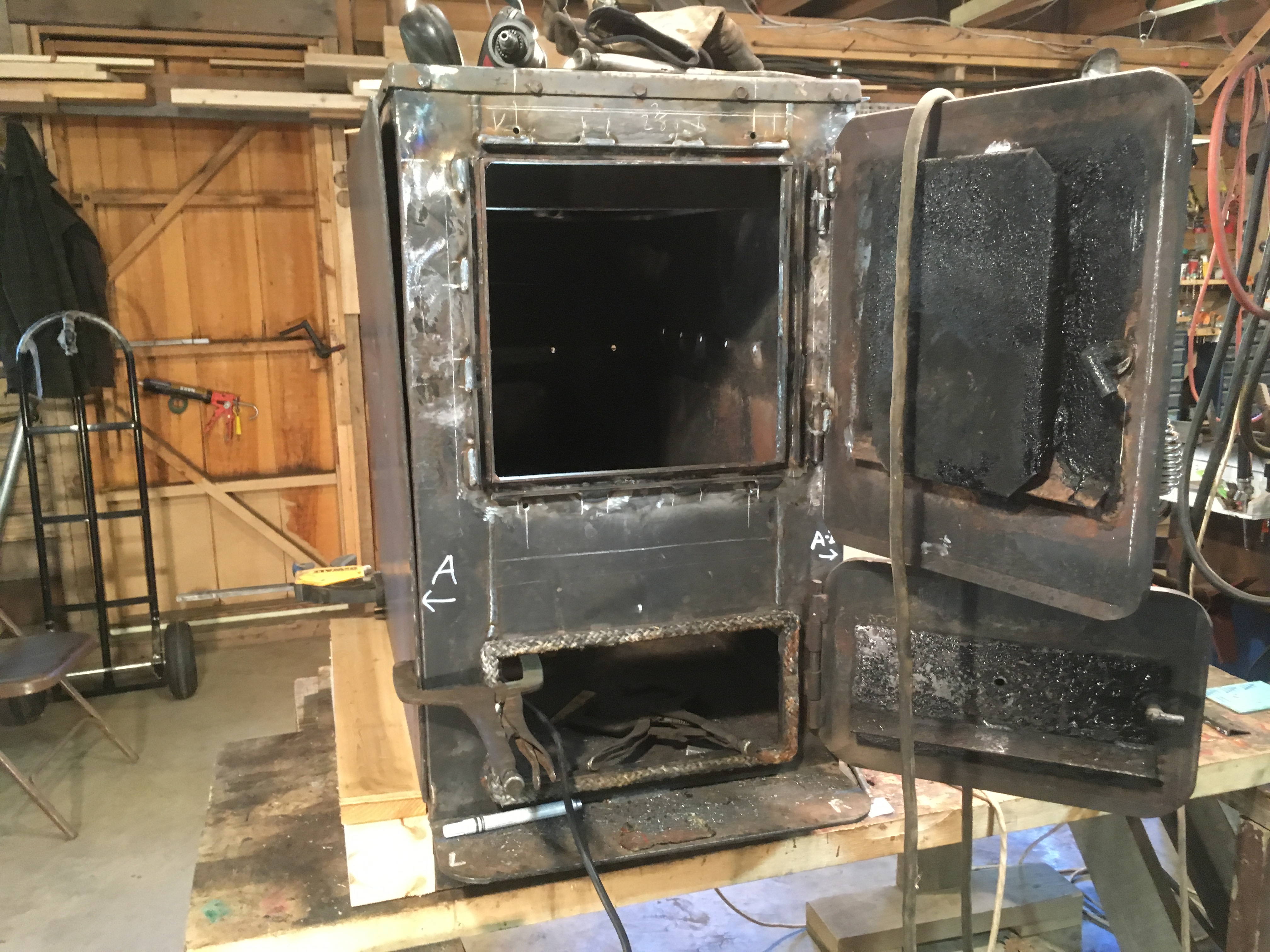

Also I got the door fitting better, changed the gasket outer slot from an 18 ga trof/channel to a 1/8"x1/2" flat bar, had to cut a few tack welds on the surrounding channel and slice a 1/8"x1" flat in half, into 4 pc> 12" long, clamp and tack on, then I realigned the door, tested the door closing with some spare rope.

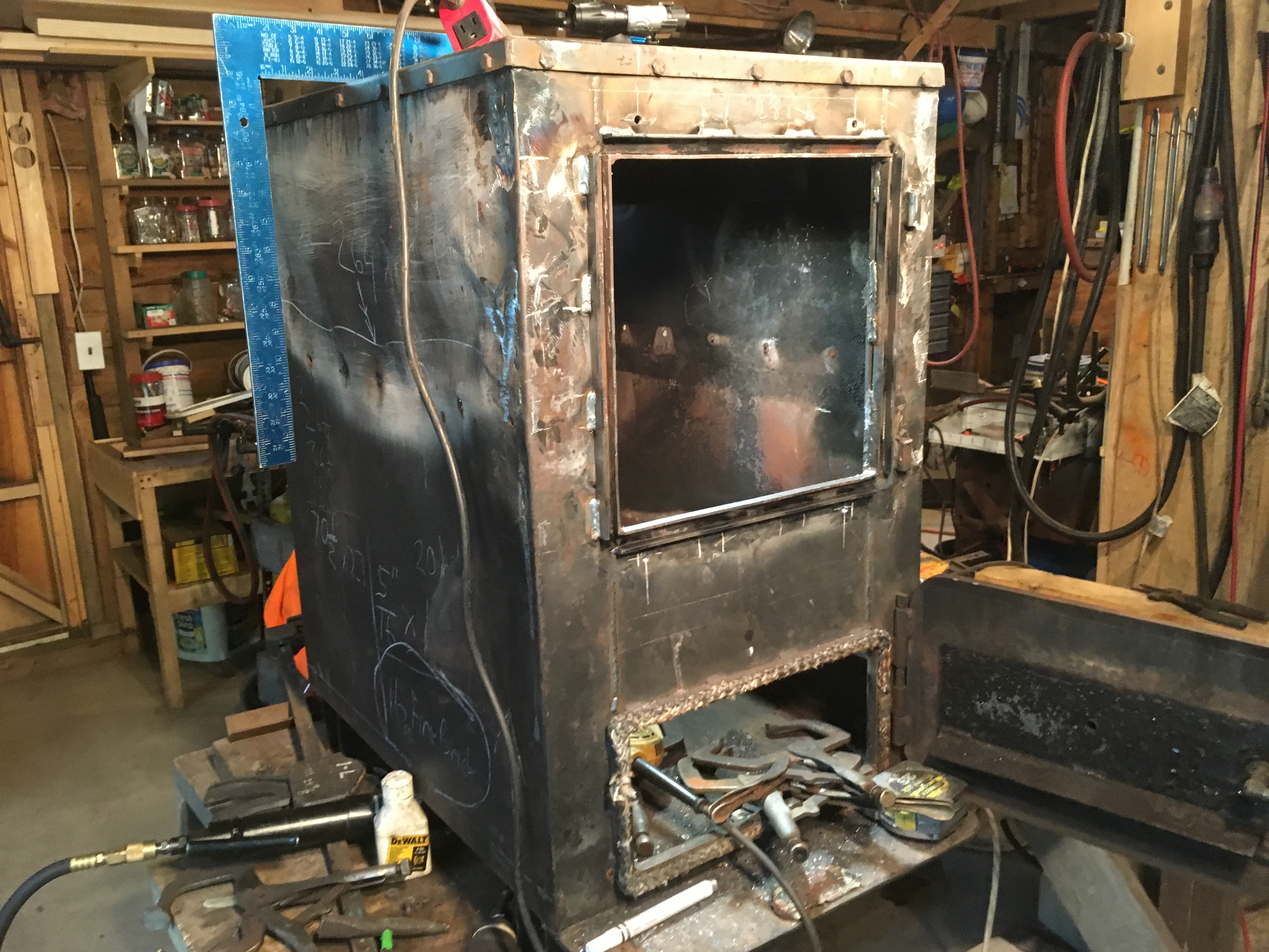

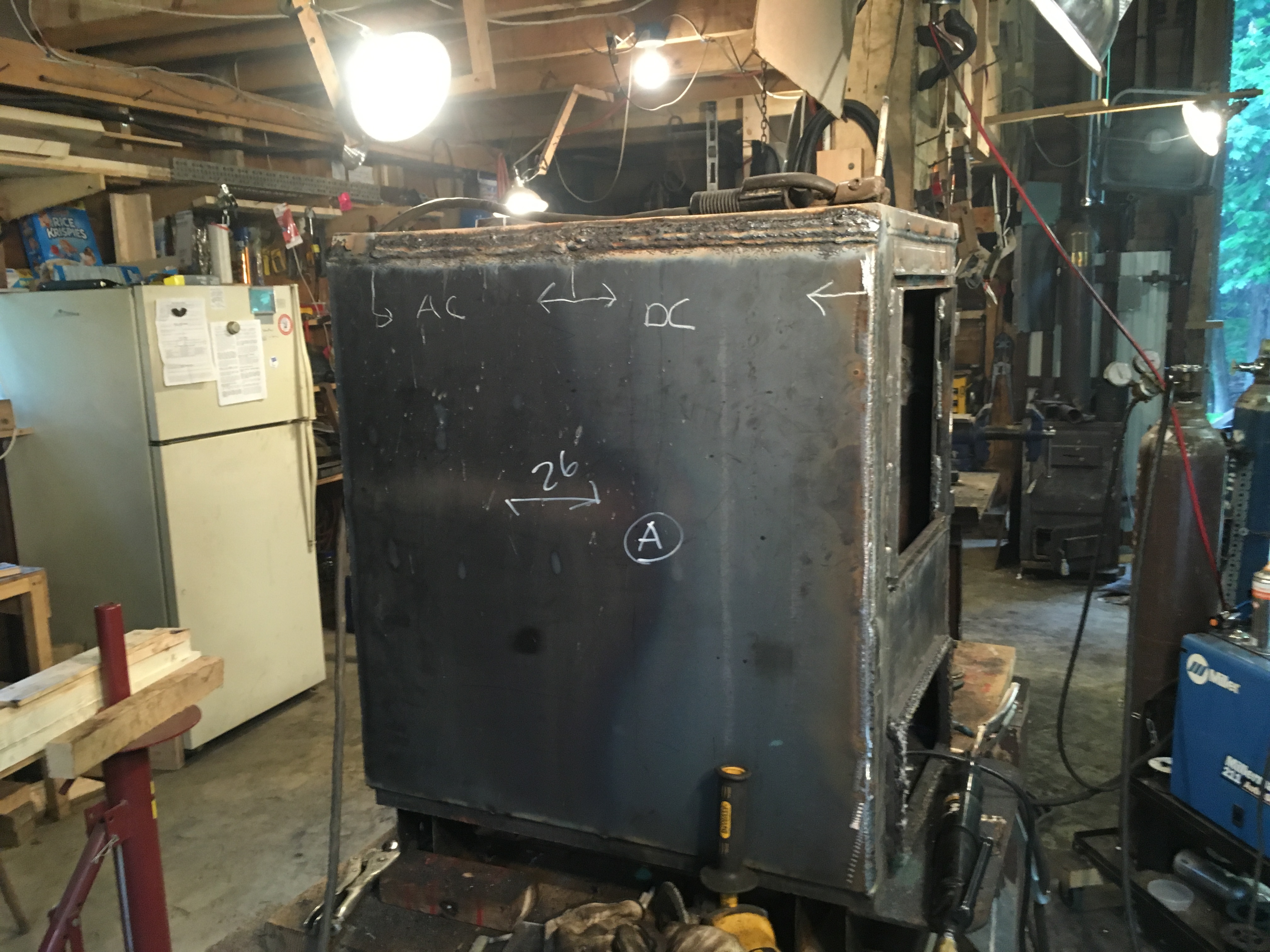

Now that the front is done it's time to start the side and back, 2> 1/4"x 27"x 26-1/4" and one for the back 18-1/8"x27"<<<<I put that last cut on video, my torch burning skills are lacking, find something for straight edge, try to hold the torch against the straight edge and move at a constant speed is not that easy for a amuter>>>>>> Cutting torch - YouTube The first plate I cut I thoght would stay on my small bench, not quite it fell on the floor and ring my ears, next cut I clamped it on the bench so the next plate wouldn't fall.

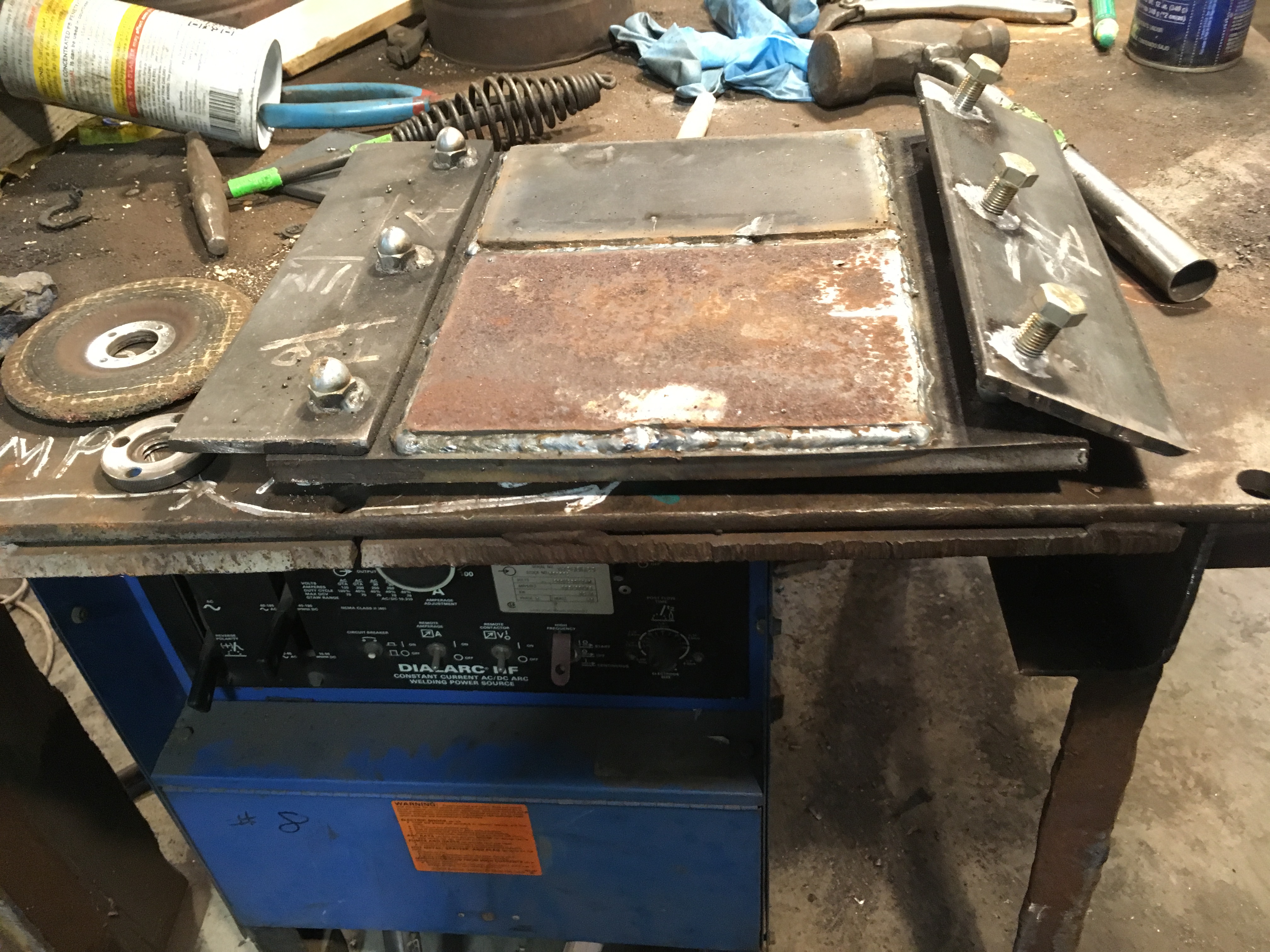

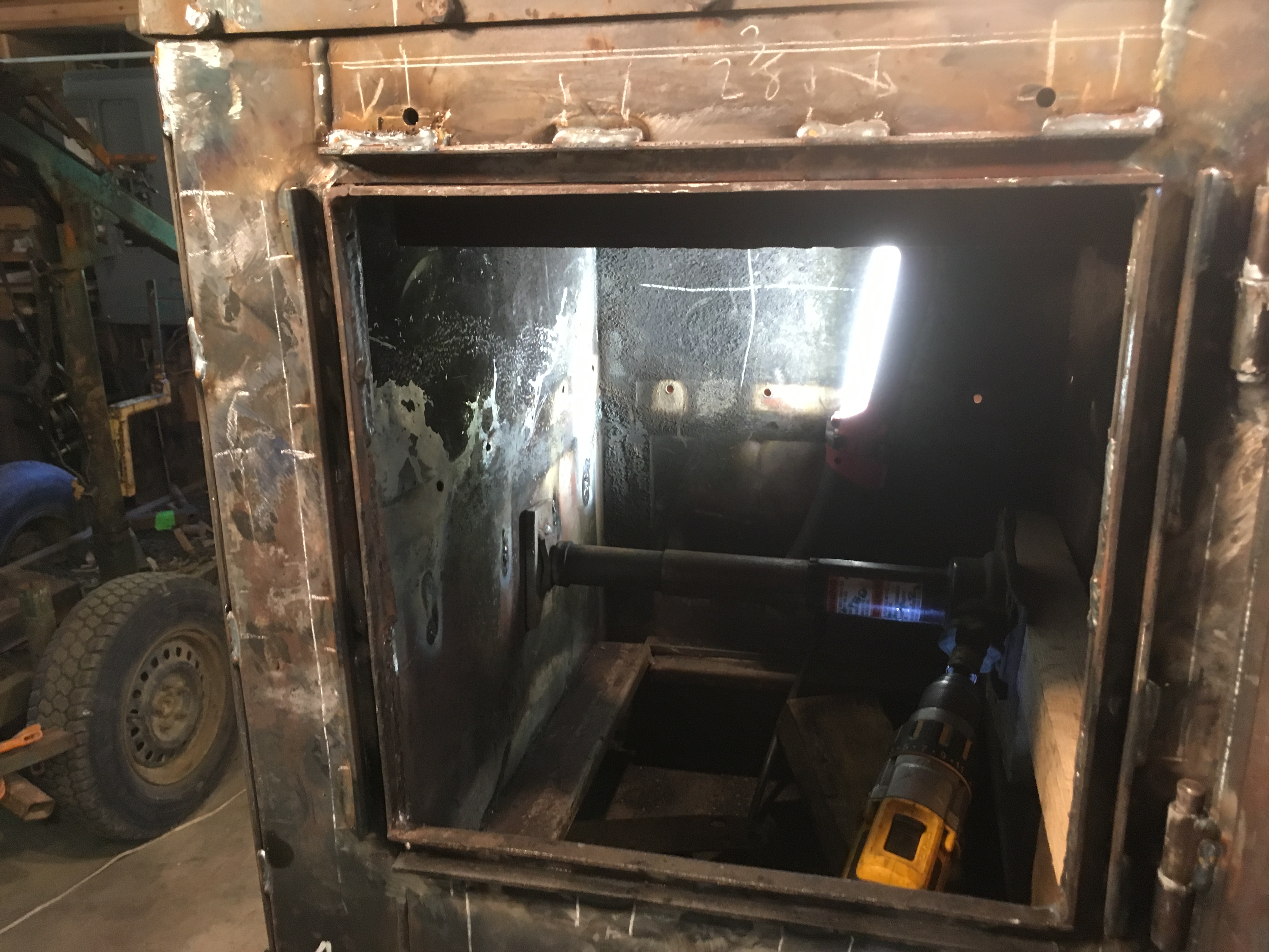

I got the 1/4" plates on 3 sides, next will be making new inside brick holders, debating on whether to use 1/4" angle or 3/8", doing most of the welding with .030 70s, vice grips, bar clamps and jacks helps a lot...........

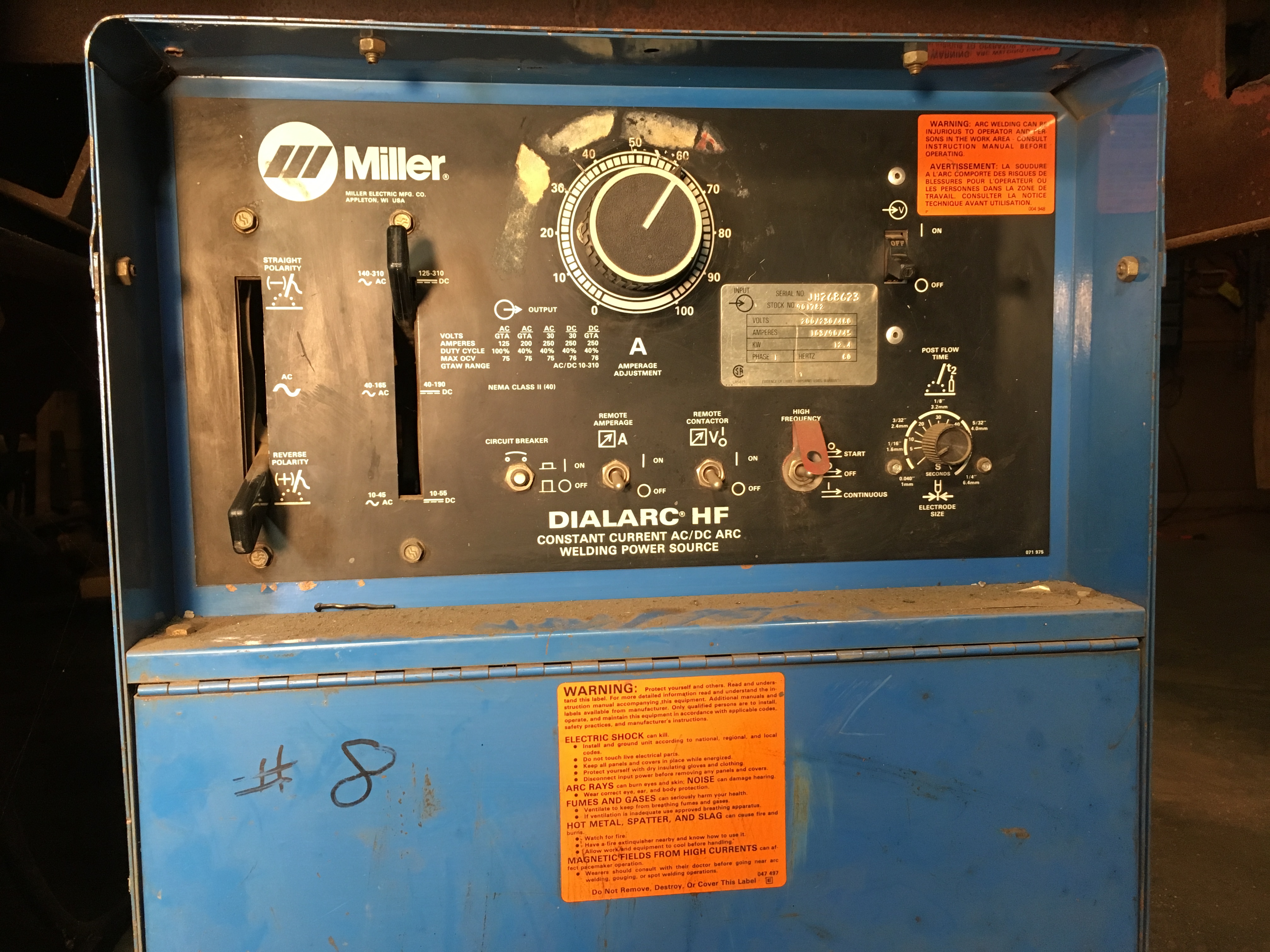

Then on the top I wanted to try some 3/16 6011 that I had and it's a lot of molten metal in the out of position. It differently welds easier on DC than AC, I had the big dial down to 50 and it was harder to start the arc on AC than DC, with the dial at 60 it was plenty of heat whatever the heat was, I have to ask a guy at work again who knows how that dial works, told me once last year when I bought the Miller but I forgot what he said, I remember setting the amperage on these Miller's are konfusing...........

Oldpath
Be weary of plating the thicker material over the outside of the thinner.
The air gap will act as an insulator and run the temperature up considerably on that inner sheet.
Warping and burn out will follow. Not that burn out is an issue if the plating is welded in all around. But it makes for a bad looking interior. Ask me how I know? ;-)
I've run the same Fisher log wood stove for winter heat in the house for more than thirty years. Relined the bricks a few times. That steel is thick enough. It's been the lesser models out in the shop that have been the trouble. I'm in favor of a well lined firebrick box even if it does cut down size.
very true, but, you can thermally attach the 2 sheets with a bit of welding, say an X or + weld in the center of the sheet, to thermally couple the sheets.. just welding it around all 4 sides would still leave an air gap, although greatly reduced from not doing that.. more thermal coupling= less waste of firewood..

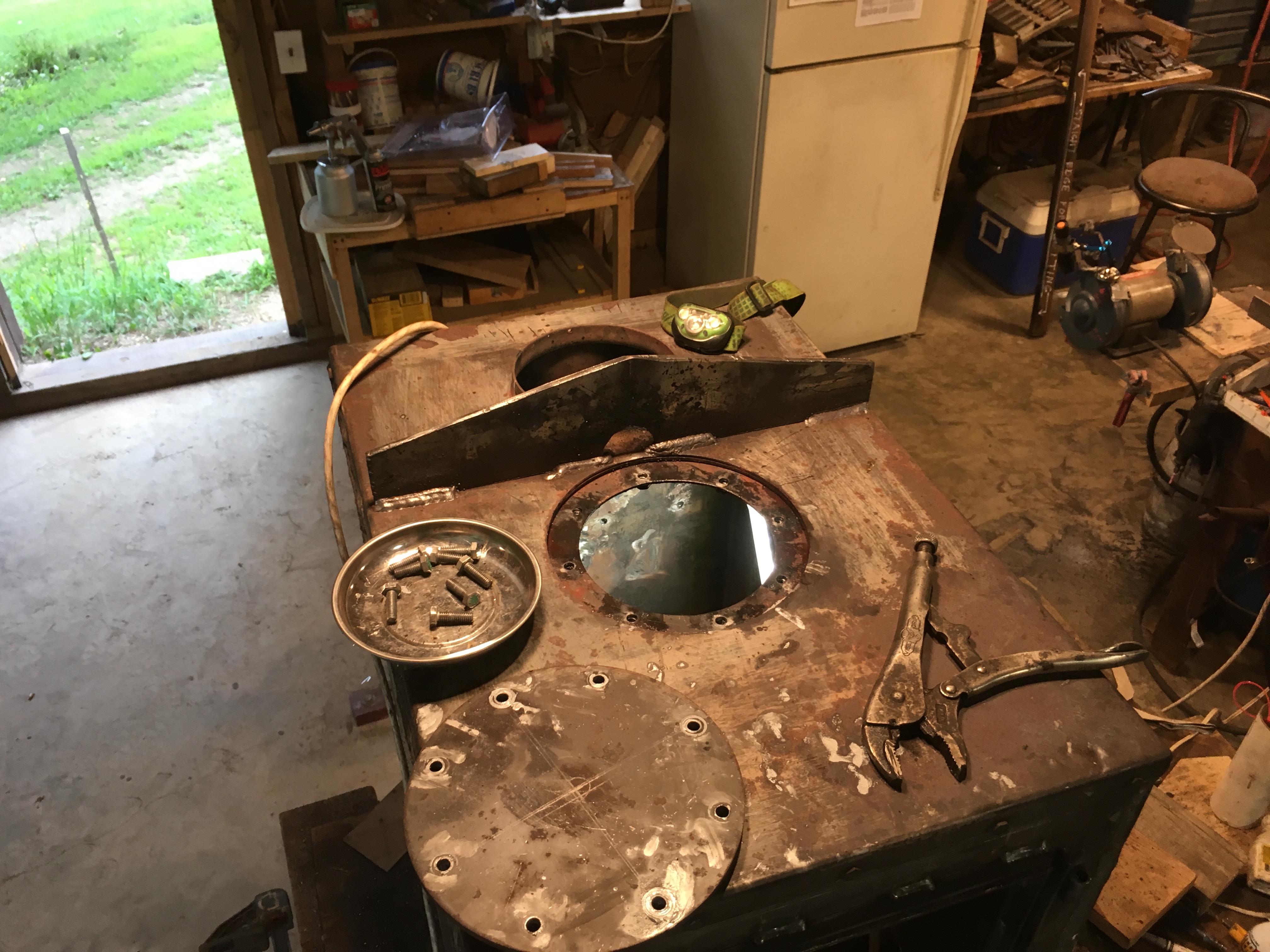

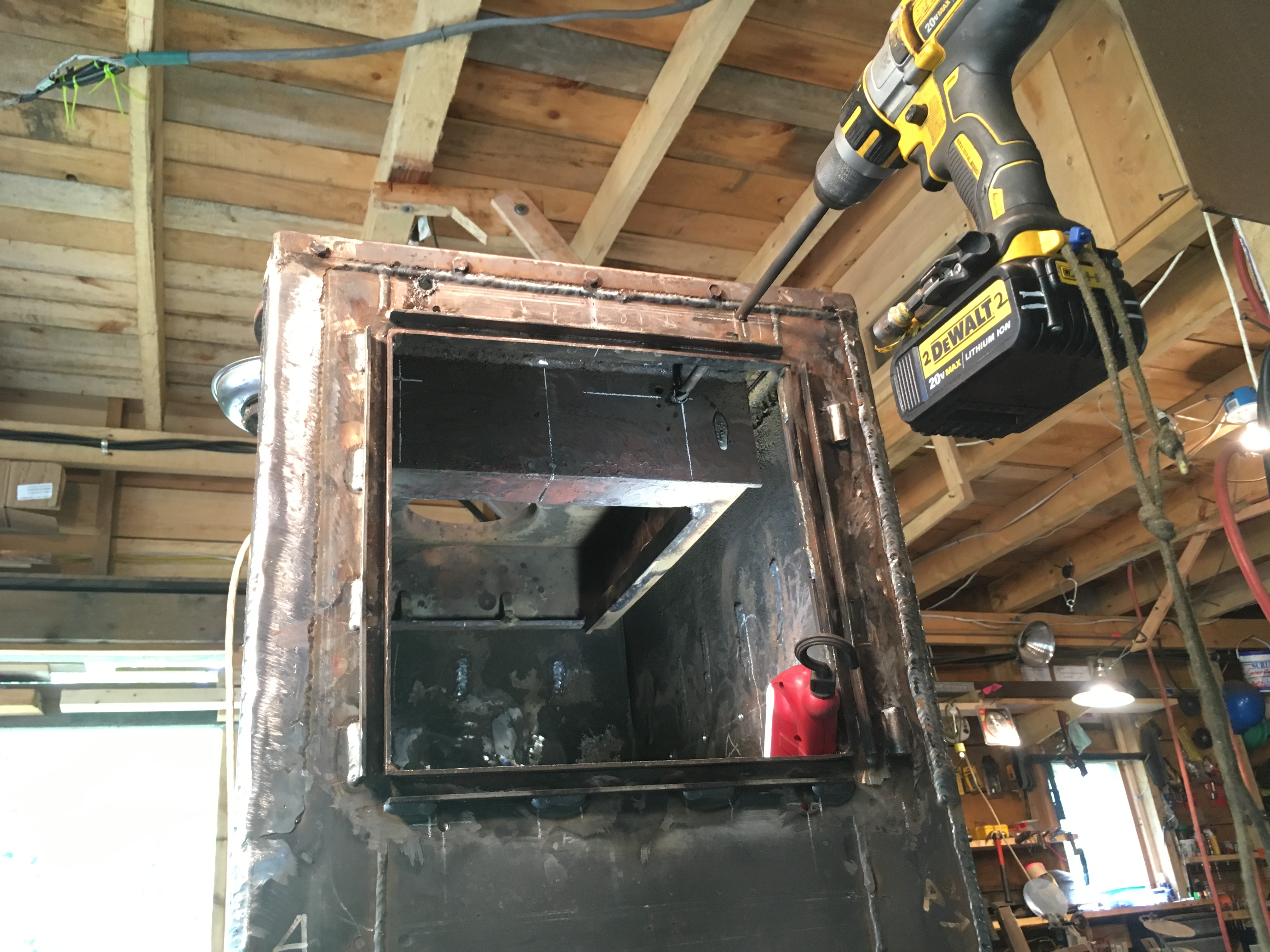

Due to global warming this past weekend didn't do much on my stove fix, just drill some holes for the firebrick holder that I haven't made yet and jacked the top back up from a 3/8 sagging position, added a stiffener on top so it will stay, might trim some of that of not sure yet.

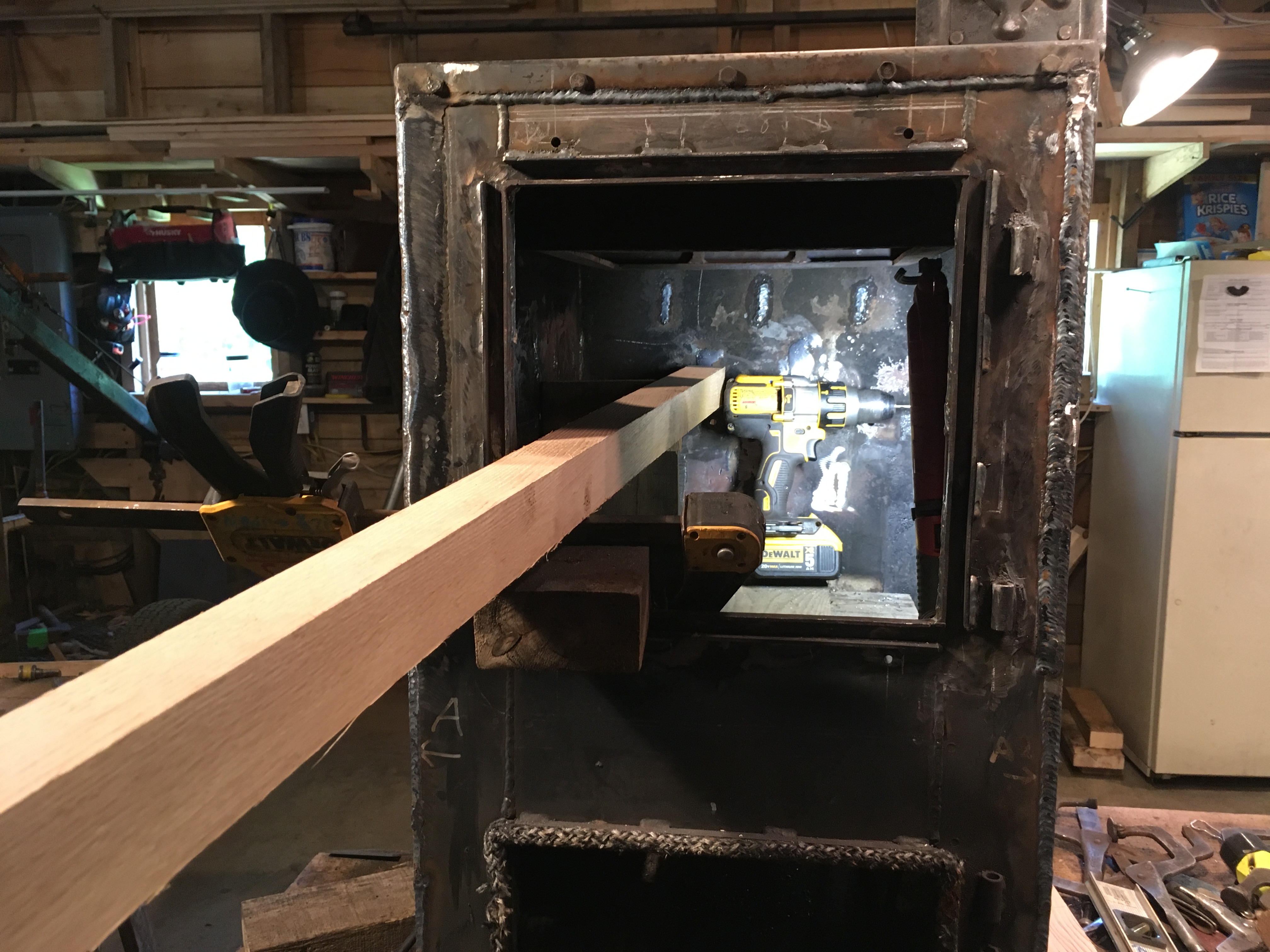

The front and back end holes was easy, the back side holes was hard so got a little extra push using a stick and still was going hard till I finally figured out the fulcrum point was wrong after 15 times of sharpening the drill bit, needed to be put the fulcrum point back near the drill, was using the door edge, then I just lean in the stick and the drill went right thru easy, didn't think I was that bad at sharpening bits.
View attachment 563855 View attachment 563856
This "detail" is an important aspect when setting AMPERAGE.
(Taken from Lincoln)
Quote:
A welder should know the meaning of polarity, and recognize what effect it has on the welding process. With few exceptions, electrode-positive (reversed polarity) results in deeper penetration. Electrode-negative (straight polarity) results in faster melt-off of the electrode and, therefore, faster deposition rate. The effect of different chemicals in the covering may change this condition. The high cellulose covered mild-steel rod, such as Fleetweld 5P or Fleetweld 5P+, is recommended for use on positive polarity for general welding. Some types of shielded electrodes function on either polarity, though some operate on only one polarity. End Quote.
