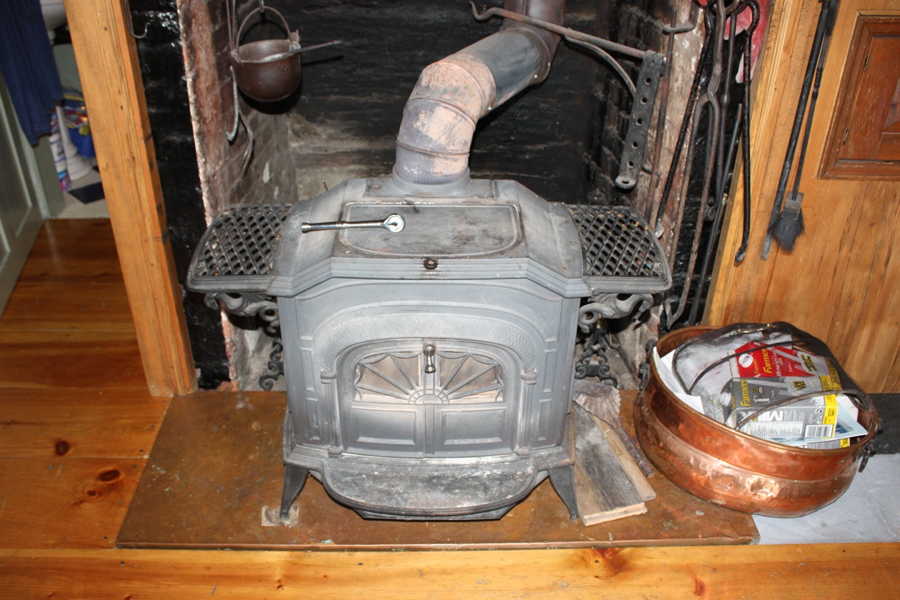

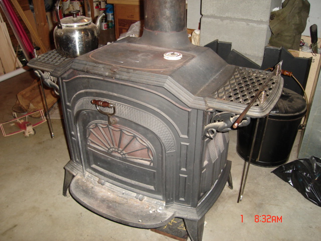

Cool-- another project! :D My 1979 Resolute also has a crack in the back, also from running too hot a long time ago; I'll be following this post with interest. Something I've been wondering about --rebuilding/repairing it-- for quite a while.
Haven't had any pieces fall out yet, and it's cranking today for sure -- 2 below outside with a VERY stiff north wind- ouch! Looks like our little digital camera picked up som IR heat off the front door-interesting.
If anyone needs assistance at the factory, it's only about 1/2 hr from my house. Haven't been up there in a long time.

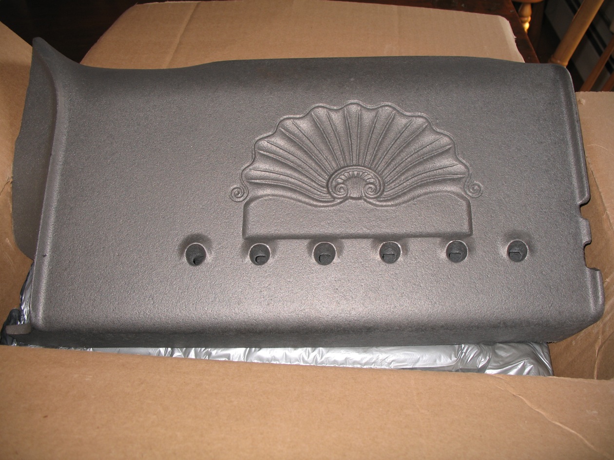

Well. The part finally arrived. Actually it arrived but they neglected to call me. Twice to order - no follow up... poor service. At least I got the part.
I will wait till the burning season is over. Usually mid-may for me. Than I will deconstruct the stove: take apart, clean everything, purchase stove sealant and rebuild. I will probably use ss bolts when I rebuild. Hopefully I can get another 8-10 years out of the stove.
Will keep you posted.
Lloyd

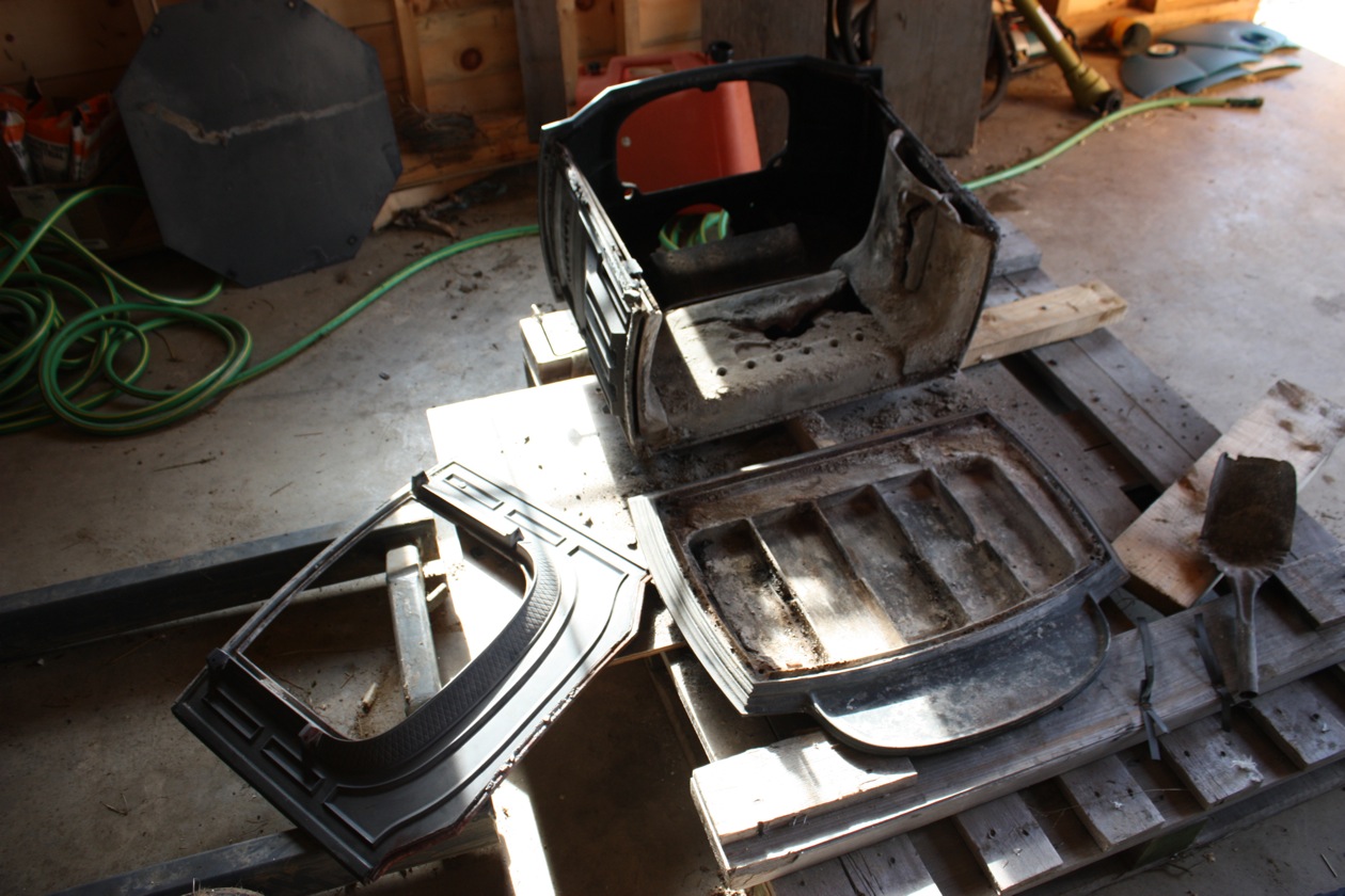

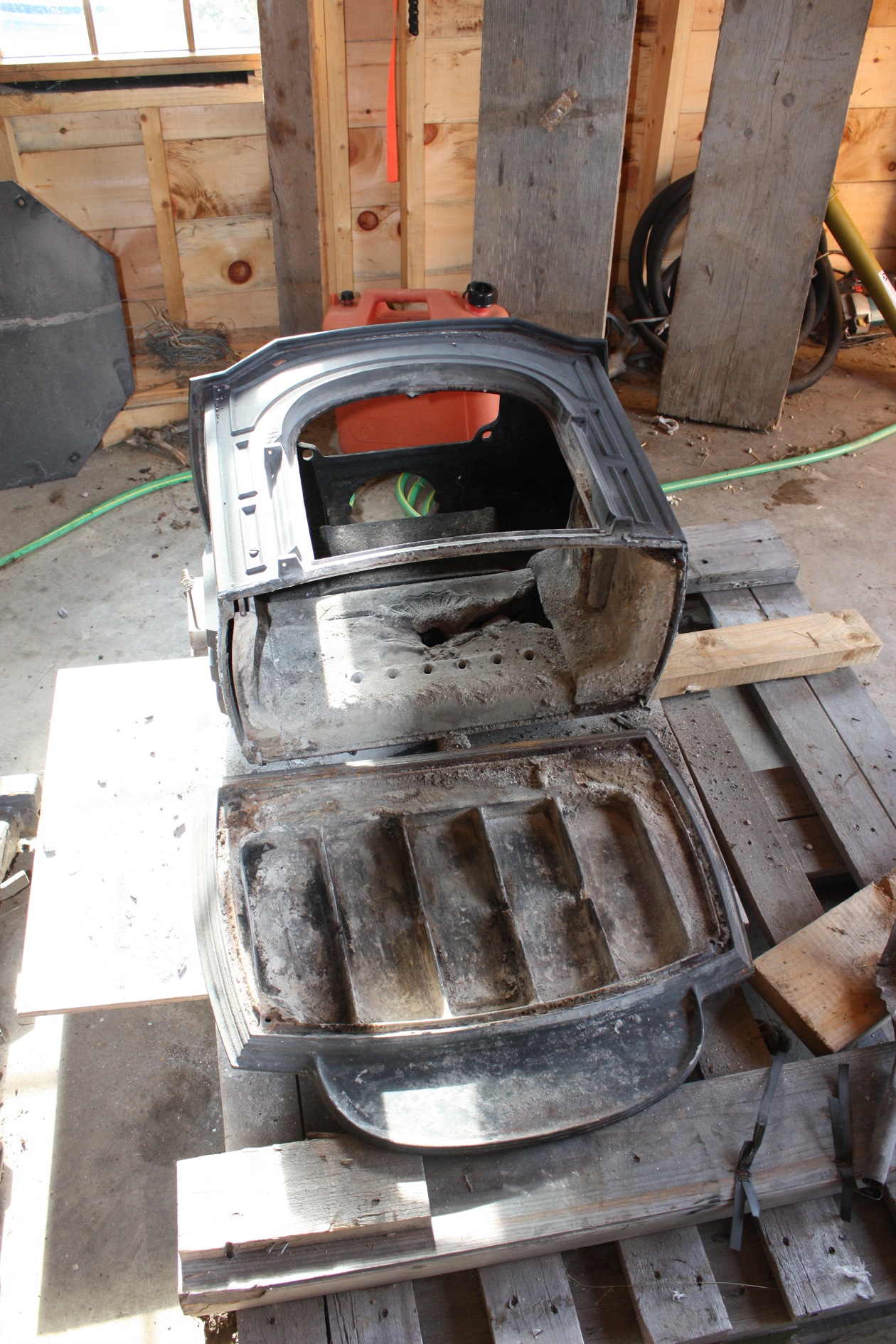

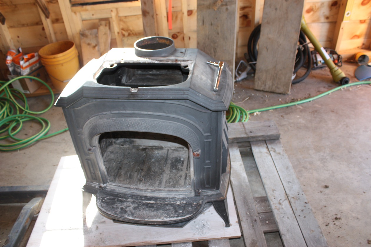

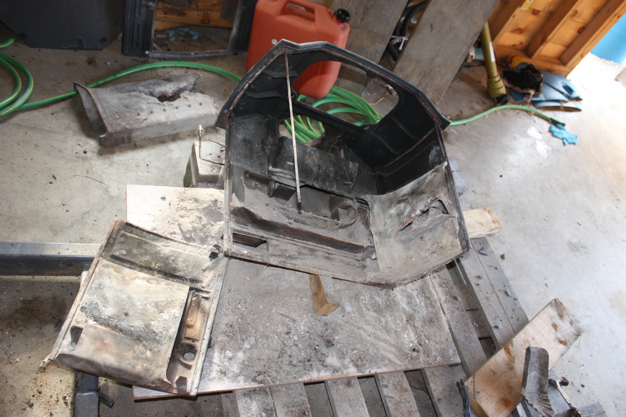

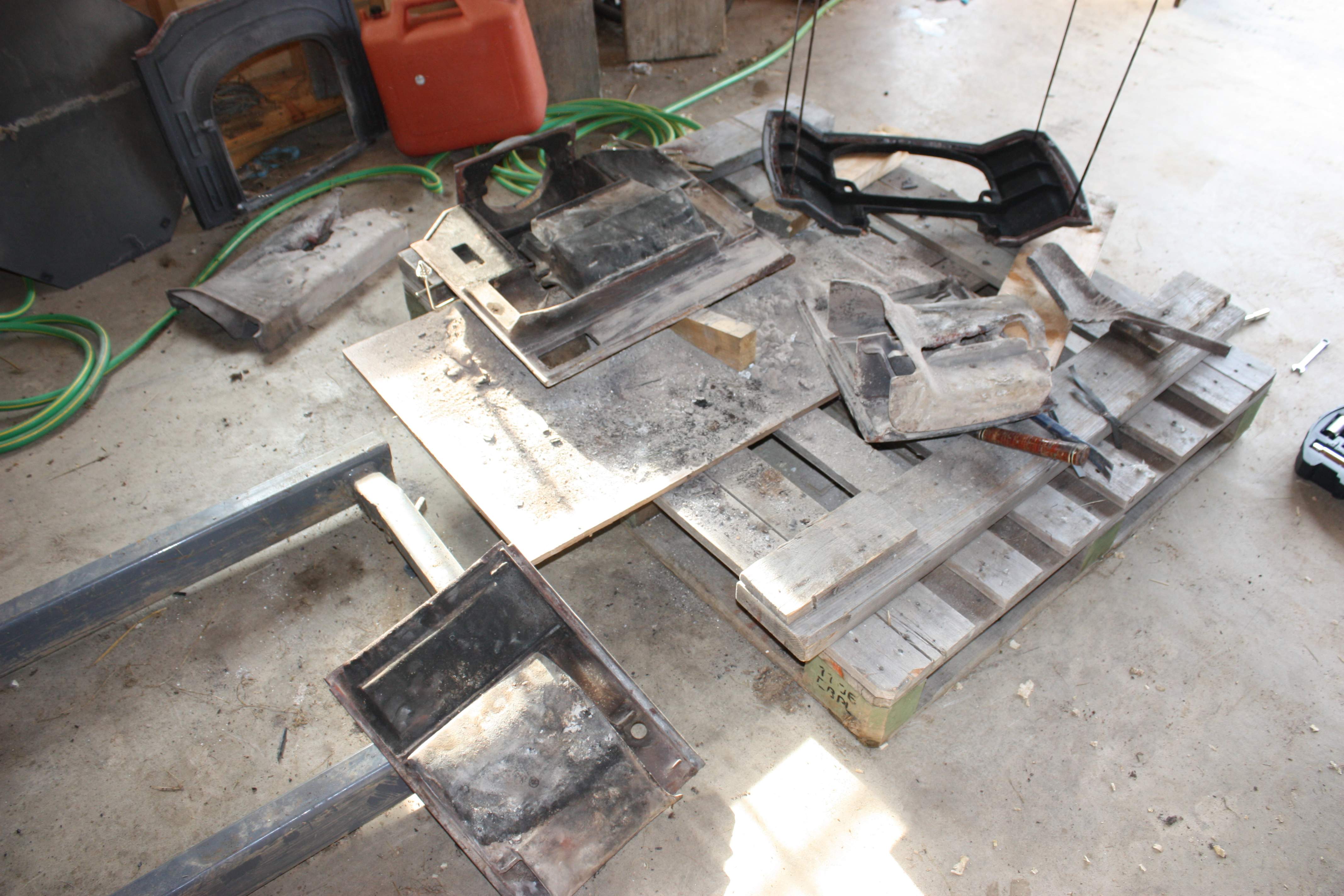

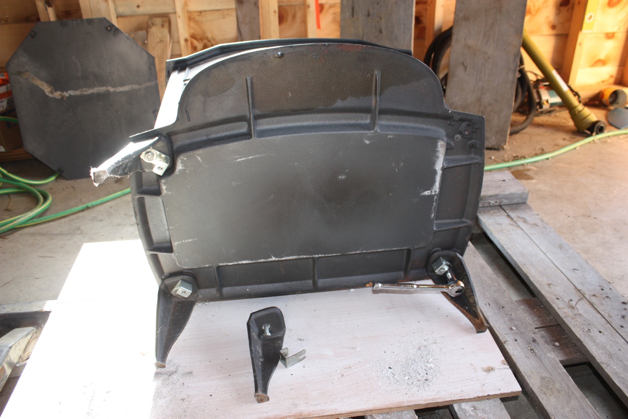

Ok, Winter is coming...
7.8 degrees Celsius the other morning. So today I started my rebuild.
Pics are probably random order(cause I can never seem to get it right - even though I load in order) but I think you will get the idea presented here. Basically I will wire brush everything down, vacuum and clean. I will need to replace some bolts so I am going with stainless.
Tomorrow I will wire-brush and post more pics before assembly. I will also take pics of assembly as well. Need to replace some gaskets and use stove cement to assemble.
If all goes well this thing should hum right along for another 30+ years.
It looks scary but I think I can put it back together. I have been taking lots of things apart since I was a very young child - oh! - some things did get put back together too!
lloyd

   / Wood Stove Rebuild #20
Wow!! I can see why you needed to replace the back of the burning area! Mine has a crack, but you have to look closely to see it. You got a hole!
Nice pics- I'll be studying them; thanks for the update, Lloyd.
