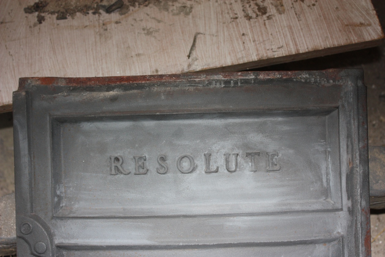

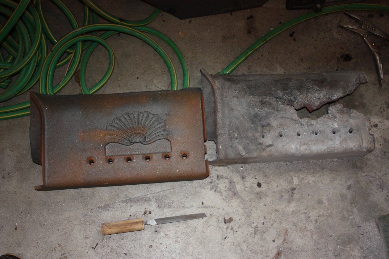

I bought the stove used. It says 1979 or it did before the hole occurred. I've used it for 8+
years. I noticed a crack last year and tried to weld it. That held for about 6 months. This past winter the back cracked in several places and a chunk fell out. I used it for about 3 months with the hole. It is a baffle and not the back of the stove.
A new back was ordered and arrived during the burning season. I burn everything from oak, birch and hemlock to pine. The softwoods are used to start the fire. I mostly burn oak - well aged - at least two years. I keep a watchful eye on the thermometer on the stove pipe and burn within the desired ranges.
I just got back from the hardware store with new gaskets and 4 tubes of 1035f stove cement. So I will be wire brushing the parts today and assembling later with the help of a friend.
Will post pics of reconstruction.
lloyd

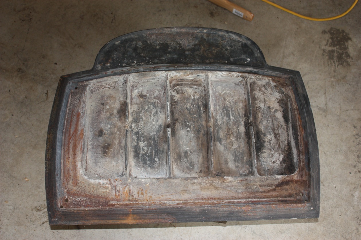

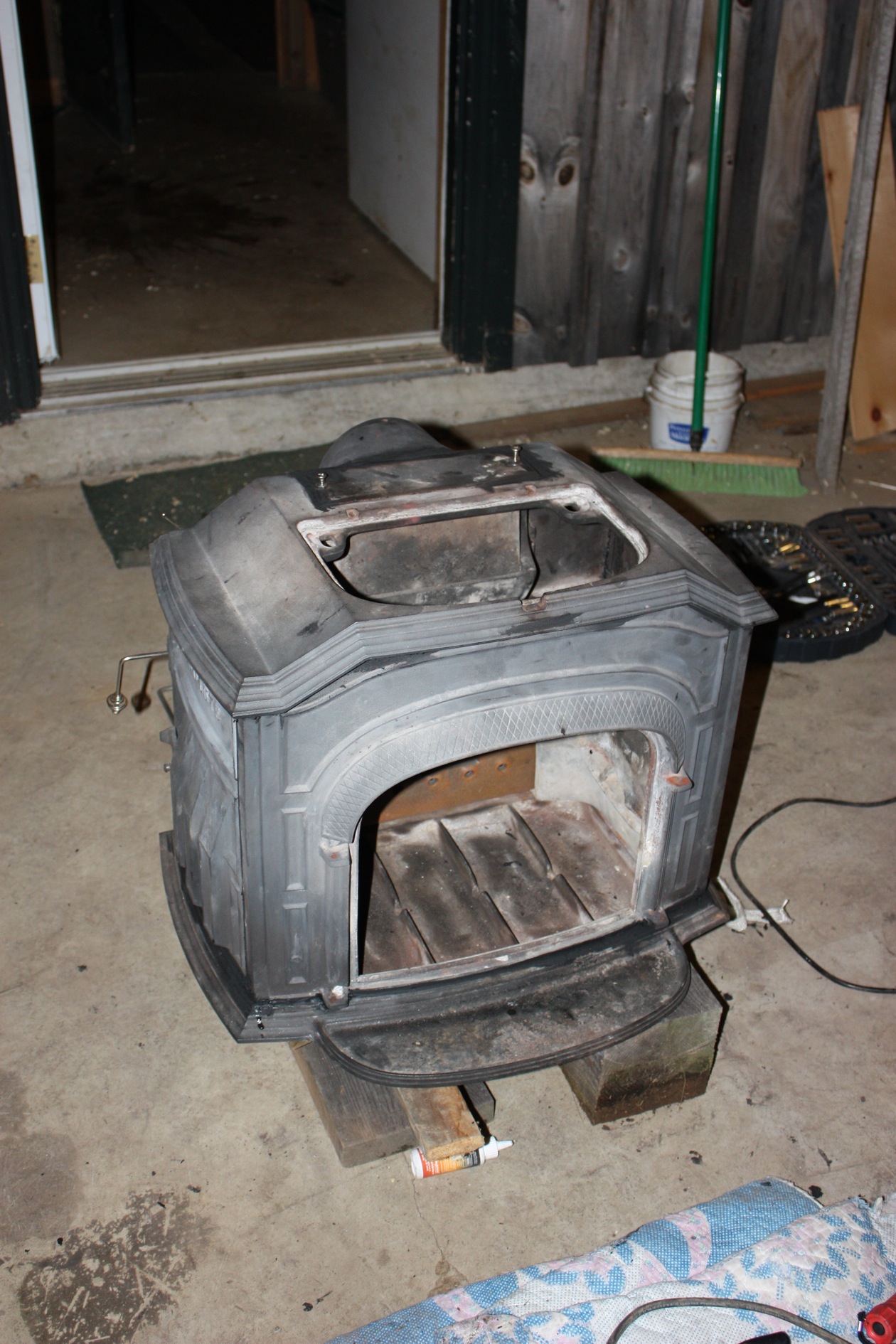

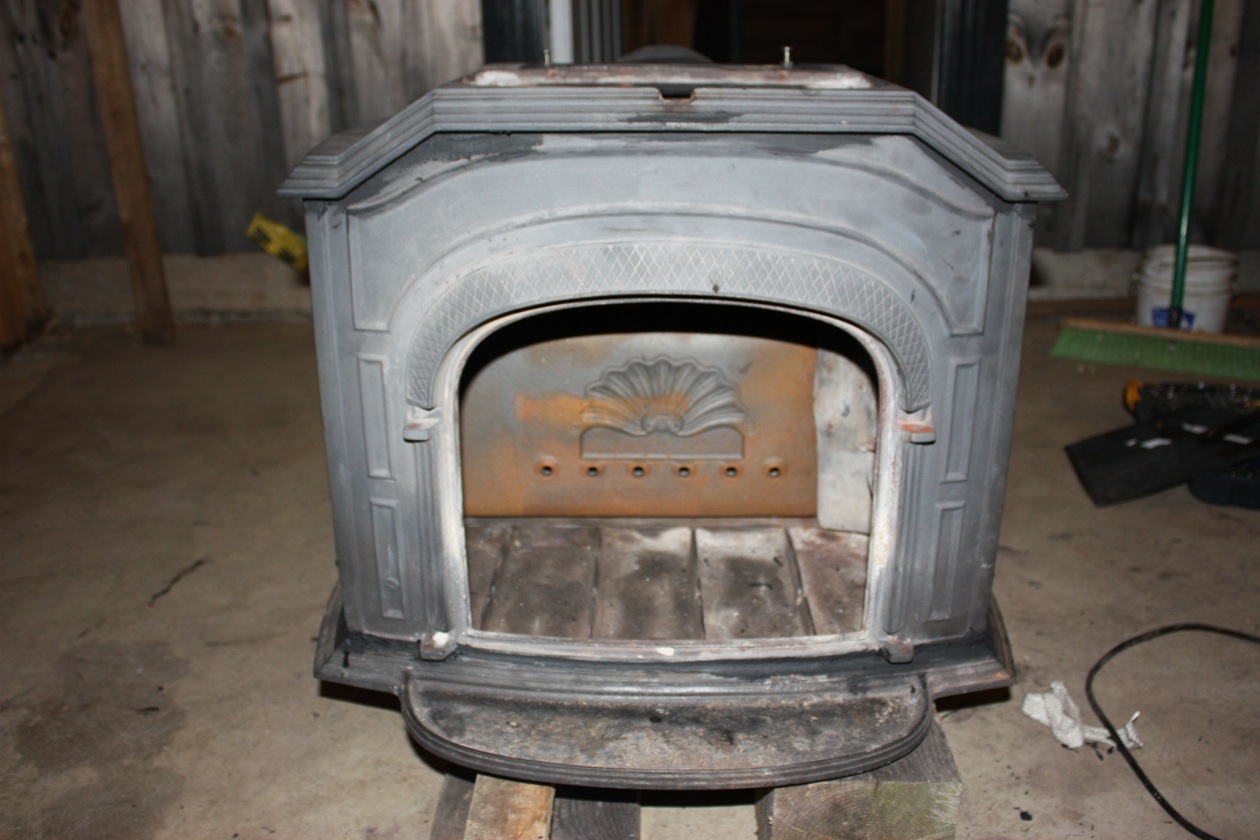

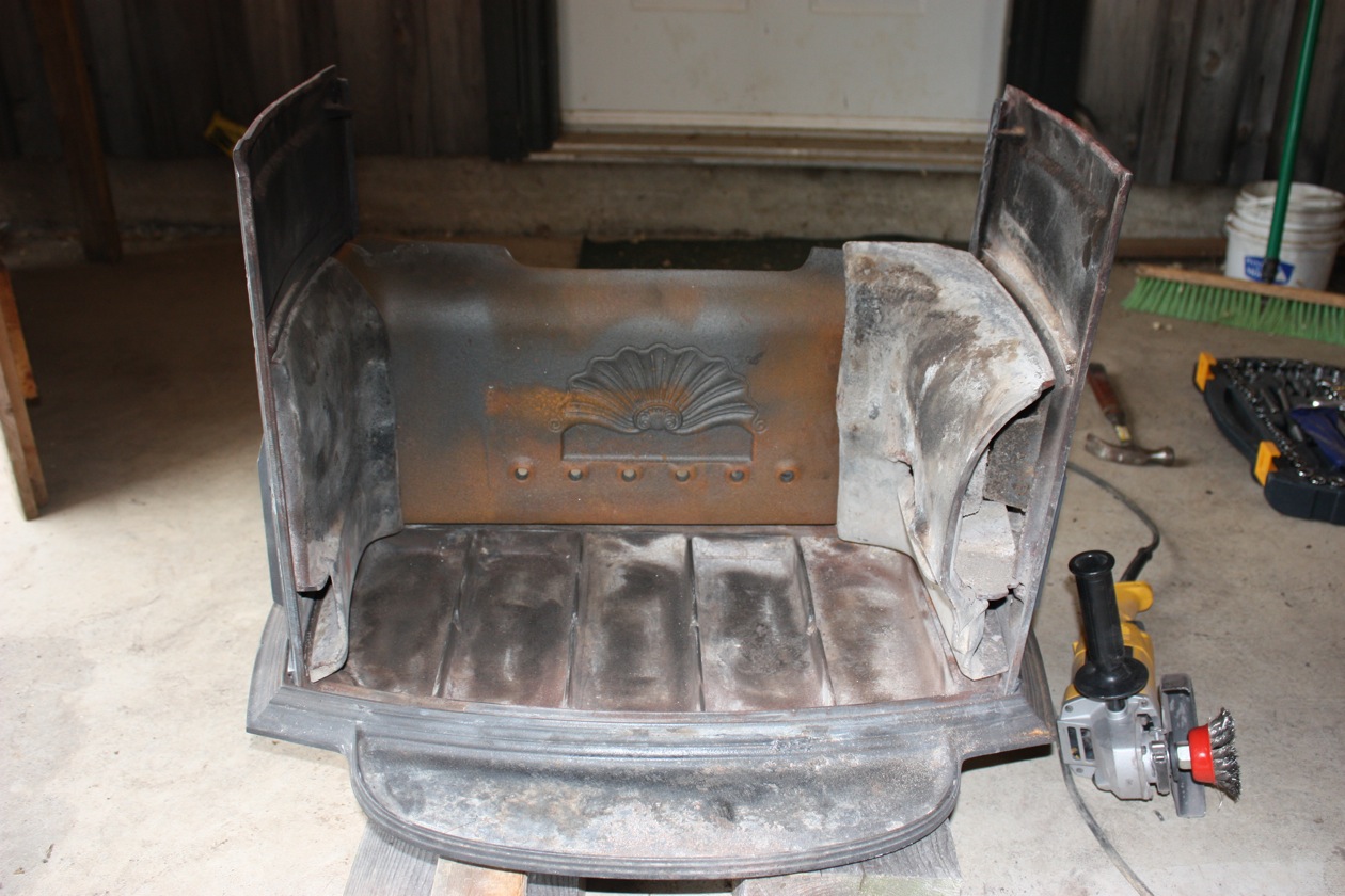

So, It's back together - ya!!!!!!!!!!!!
I wired brushed everything and chipped out old cement. The rebuild took two tubes of stove cement. I used stainless nuts and bolts and reversed them for clearance - bolt head inside - nut outside.
I did a dry fit before laying in a bead of cement. The biggest challenge/time concern was lowering the top and aligning the four corner rods. The rods go from top to bottom and bolt at the bottom. They were in decent shape so I left them - I didn't want to break a rod threaded into the top part of the stove. Once the cement dries it will add extra strength to the stove.
I laid a bead of cement everywhere I could and once the stove was together I laid a bead on the outside where the stove plates came together. I also put a new gasket in the top. I ended up putting it together by myself - but two people would be better.
Tomorrow I will use stove black to give the stove a 'new' look and move it back into the house. Doors and side shelves will go on once it is in place.
lloyd

I see you use the angle grinder with the braided wire wheel also ! ;)
