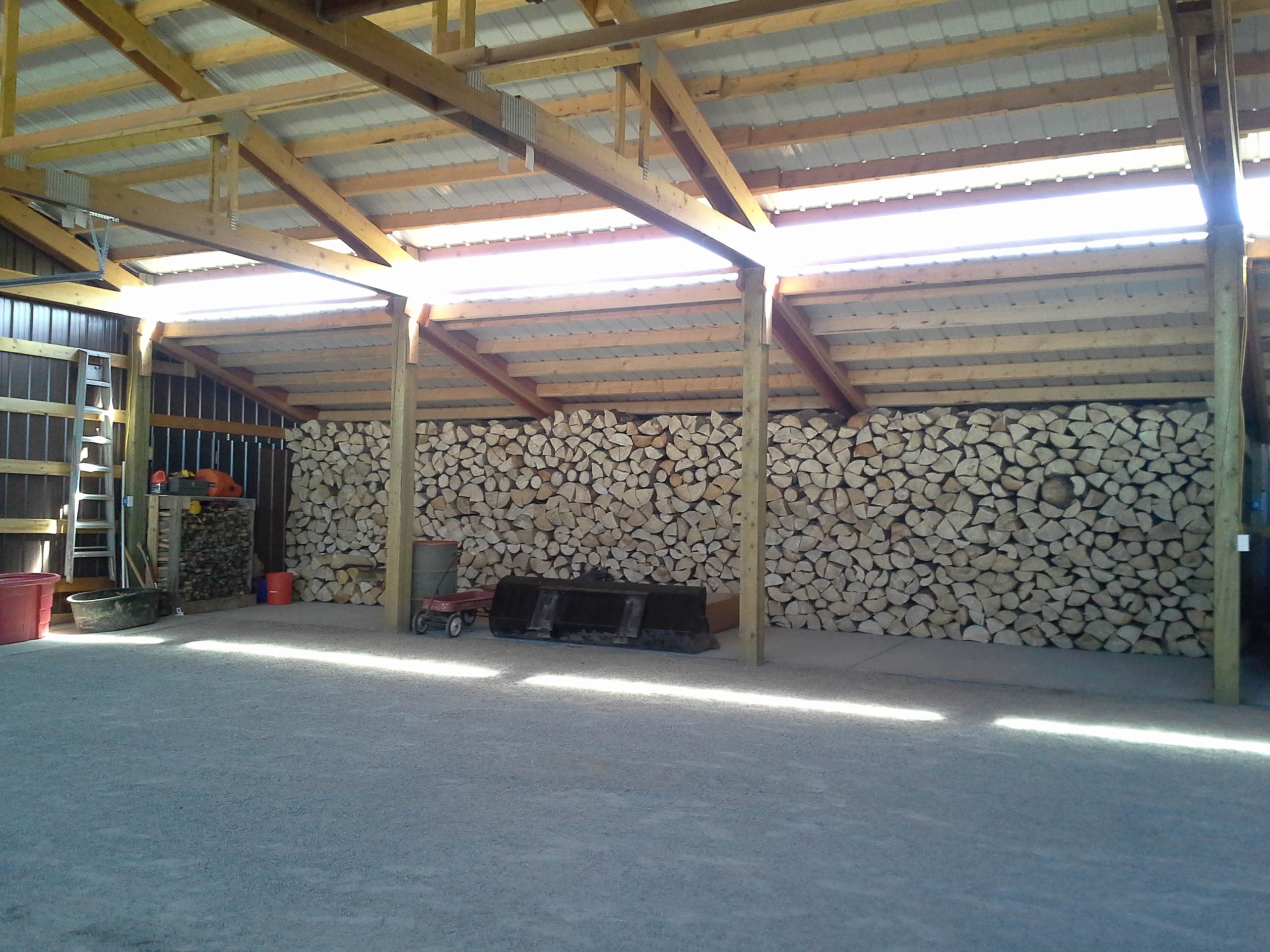

The wood only burns with lots of air sometimes I even crack the door open on the wood stove. I do have some wood I cut this year and it burns like it should. At least like you would expect.
Did the wood burn fine when you lived in Utah? Is this just something that started to happen with the new house in Idaho?
My neighbor spray foamed his entire house and he said that it's so air tight that he cannot keep a decent fire going in his fireplace. If he opens a window to the house, the fireplace works great, but that's not practical in the winter.
Do you have a clear air vent to the stove to allow enough air in?
I doubt the problem is the wood.
Good question Eddie,
It did not burn good in Utah either. The wood stove in our new house draws it's combustion air from the outside (attic) so that would not be the case. In Utah I did have to have a house door cracked open because the house was so airtight.
I think snobdds hit the mark on why it doesn't burn good. I'm going to do my best to get all the old wood burned up. I'm hoping to build a new barn in the summer or the next summer and I'd like to get it stocked with new wood. New barn will be 69X96X14:thumbsup:
When I said the wood was to long I meant;
I have to put it in the stove sideways and you guessed it, it always wants to roll or fall out when I open the door. All new wood I cut will go straight in endways. If that makes any sense.:confused3:
This is the wood we're talking about.
