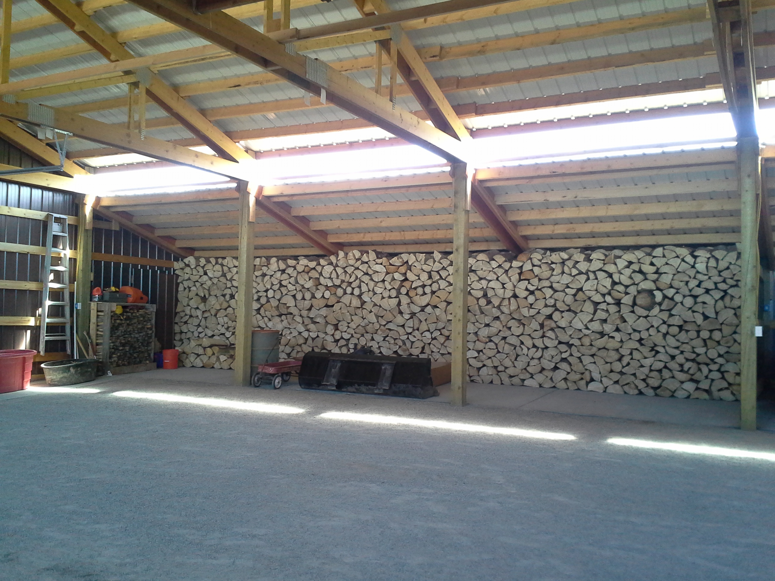

I think snobdds hit the mark on why it doesn't burn good. I'm going to do my best to get all the old wood burned up. I'm hoping to build a new barn in the summer or the next summer and I'd like to get it stocked with new wood. New barn will be 69X96X14
When I said the wood was to long I meant;
I have to put it in the stove sideways and you guessed it, it always wants to roll or fall out when I open the door. All new wood I cut will go straight in endways. If that makes any sense.:confused3:
This is the wood we're talking about.
That wood looks really green. I like to stack mine outside (tarped) for a couple years before using it, and bring it into the woodshed in the fall. IMHO dries/seasons a lot better outside where air can circulate around it easily.
