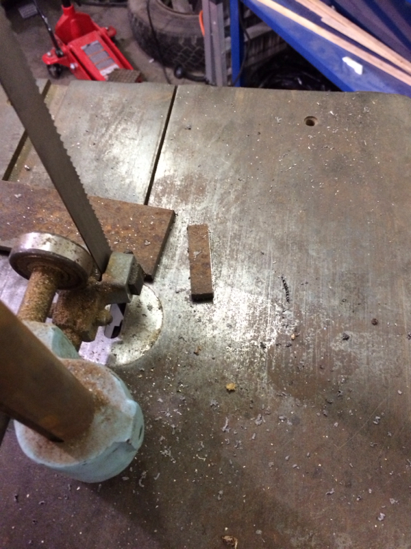

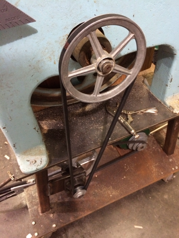

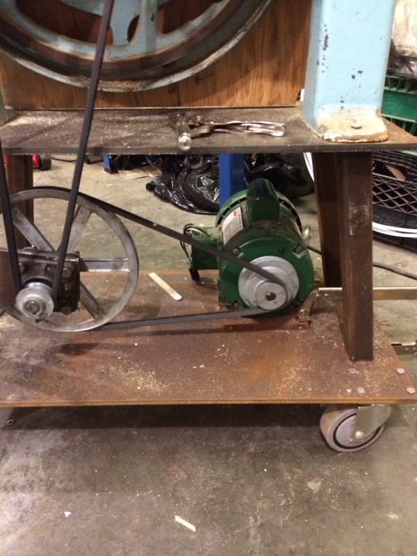

Well I finally got around to working on this project.
I have the motor temporarily held in place with vise grips just for the test cut...Victory!
New 1hp motor 3 step pulley 1/2 inch plate drilled for 5/8 shaft jack shaft 2 pillow bearings 2" pulley 10" pulley 53" v belt Had 5/8 shaft keyway cut by a machine shop 3/4x 96" Lenox Diemaster 6/10 blade Still need to; Secure the motor and find a way to adjust x-y Finish welding jack shaft plate Wire a start/stop switch Guards for pulleys/belts Eventually make a new cover for band pulleys out of aluminum Yes the fpm rate is significantly reduced but have not figured it out yet.Was the only mod the speed reduction and a metal blade? Did you have to change the blade guides? Looks like you took the speed way down? Seems like a straight forward mod.
