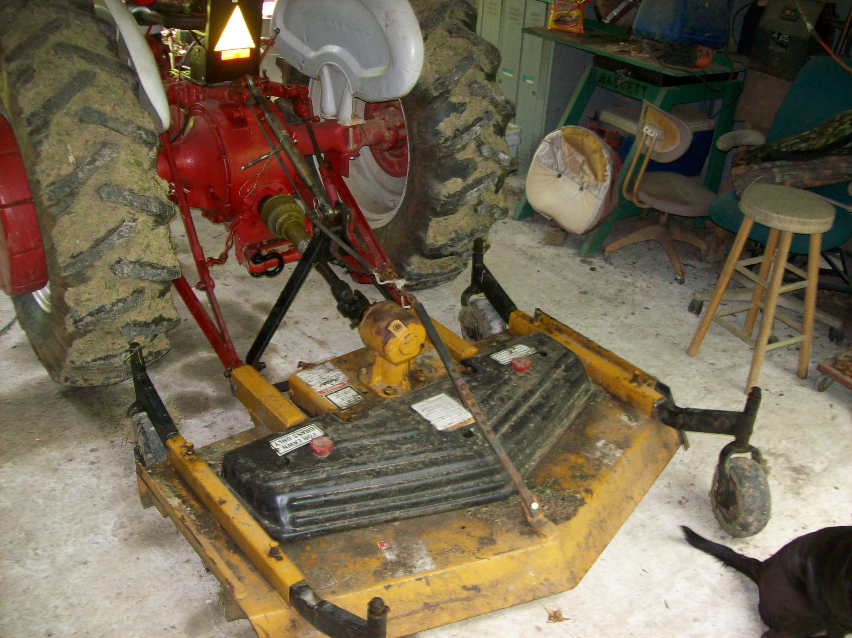

I got an older King Kutter and my complaints with it are the 4 tires have tubes. They were all flat when I bought the mower and required 4 new tubes before they would air up; solid tires would be better in my opinion. My other worry is the top chain connection from the top link attaching point to the rear of the mower. I think the newer King Kutters use a double line brace there instead of the single brace like I have. I keep my loose chain ends tied up to prevent them from getting into the PTO when I mow in a deep dip where the rear of the mower raises up causing the chain to slack and lower. The sheet metal is a little light weight too. Mine had a thick layer of flaking rust on top where it had been stored outside in the weather when I bought it that made it even thinner in places. However, the light weigh makes it easy to move and pull.
What I like, are the anti-scalping roller mounted on the front-center, the floating wish-bone hitch and the fact it uses 4 tires on the ground for the deck to ride on that follows ground contours well. While the plastic cover with 2 hold down screws makes getting into the pulleys & belt easy to clean it out, I don't trust the plastic cover to hold up to much abuse, but it has been OK so far. Mine uses a single very long belt that may be a little pricey at replacement time. I've replaced my 3 blades with new ones which were easy to do with my impact wrench (single bolt each - Left hand threads as I remember) and not very expensive for the new blades. This one is a side discharge, but I think the newer models are rear discharge, which would also be better to have to prevent windrows.

I will also mention, that depending on tire size and spacing, you may have an issue with the front wheels on the mower hitting the back tractor tires when raised.
I know from experience that an 8n with 12.4x28 tires and a KK 5' mower dont work well together

Mitchel that looks very similar to the one im looking at. Have you had any issues with lifting and tire issues like noted above?
Mine is a 5 foot King Kutter. I wanted a 6', but got a good deal in this used 5' model (needed repair). It worked find with no clearance issue on the rear tires of my 8N which I think are 11x28. My 8N had no power problem running a finish mower. In fact, I used to have a 5 foot Bush Hog that would really work the 8N hard, but still had the power to cut down anything the tractor could push over. I never cut anything but grass with the finish mower though and rarely knew it was behind me except for the noise.
In the first and this picture, my 5 foot King Kutter is attached to my newly purchased (last year) 861D Ford with fairly new 14.9x28 rear tires on it. I had to move the King Kutter front tire arms in as far as they would go in on the mower housing to clear the tires on the 861D and then it is a tight fit to clear the tires when raised. A 6 foot King Kutter may have the tires positioned wider still and be an easier fit.???? I also always use my trailing anti-sway stabilizer arms, so the mower does not swing from side to side.
I don't have any pictures of it when it was attached to my 8N though. Sorry.
