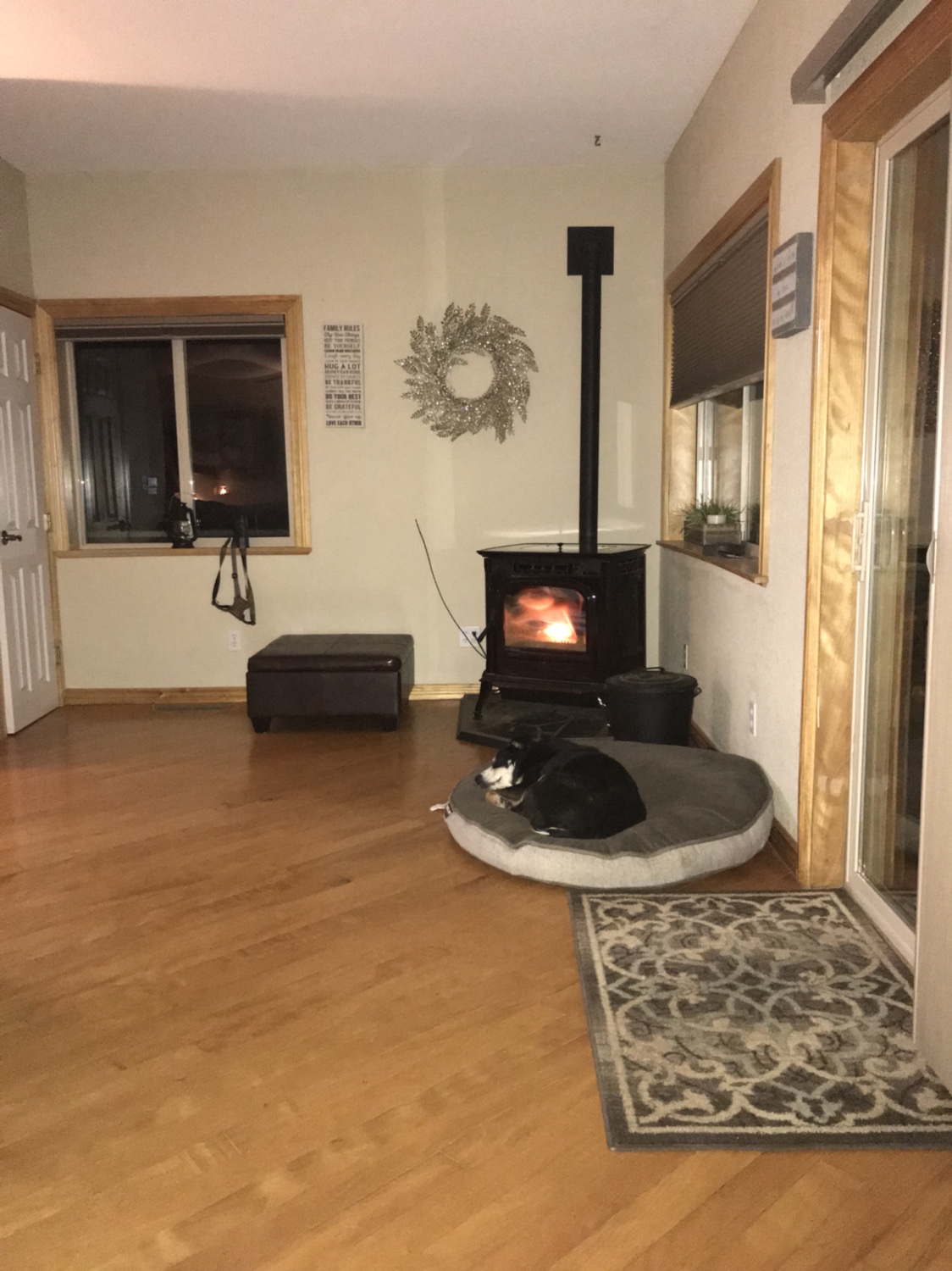

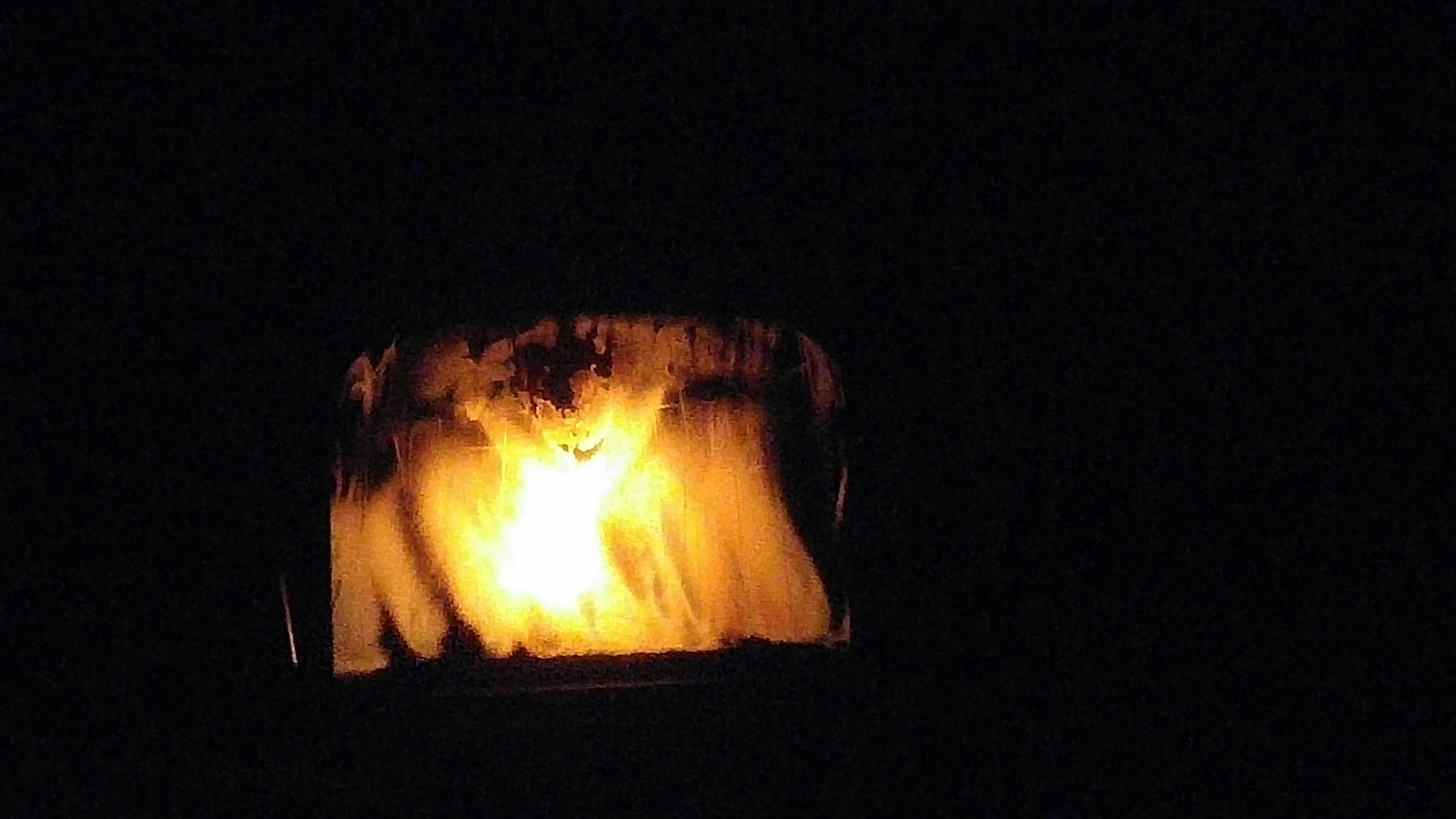

1514975346086.jpegmy glass is dirty, but here is the glow of my pellet stove right now. Really pretty when the glass is clean. I normally clean it when i clean stove, but being sick, it didnt get cleaned last time. The nice thing about this harman stove, is it has a large ash pan, new pellets being feed in pushes the ashes over the edge of firebox into pan below. Clean out once a month.
My first lowbudget pellet stove you had to pull ashes out of firebox daily, had a small ash pan. I have it in garage now, for occasional heat. It also didnt have an ignitor. My harman is fully automatic. I want another for my basement.
