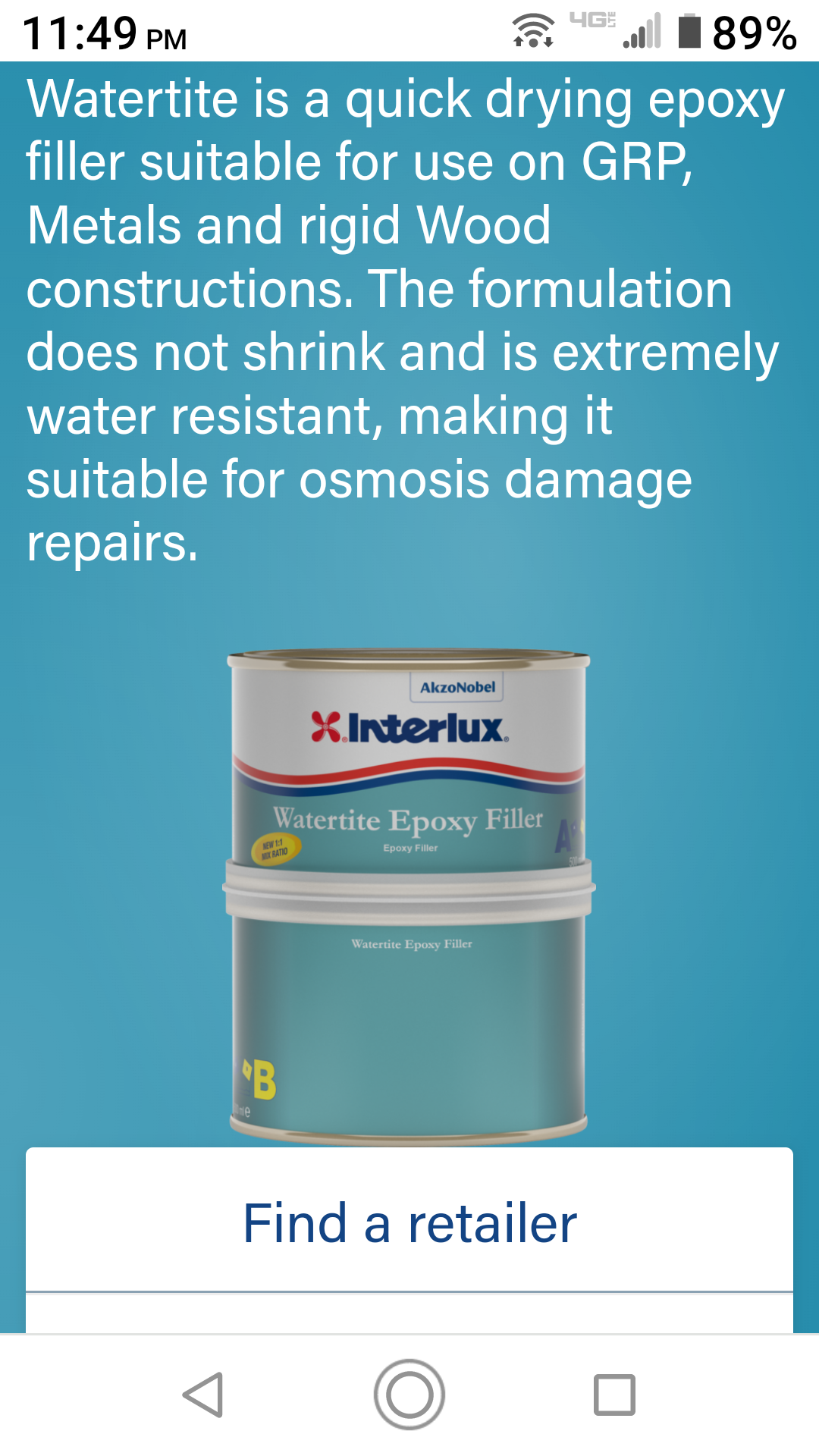

As others mentioned bondo absorbs water. Ive used this two part epoxy on boats however high moisture areas like windows I think it will do a great job and it's pretty readily available at most marine supply stores, pretty pricy though and prep good, I use acetone.
