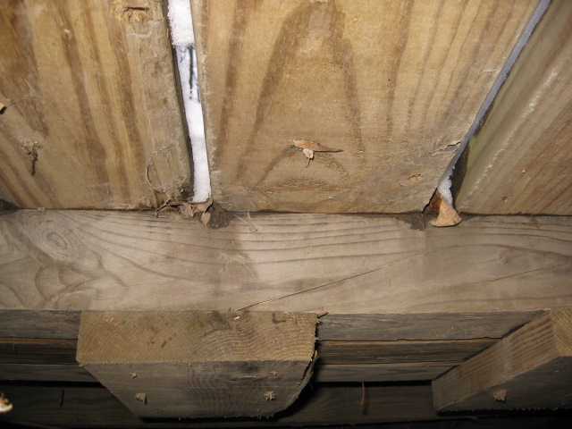

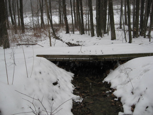

RobA said:
Any pictures?
yes here they are
   / Wooden bridge span question #59
I built a similar bridge spanning 12 ft, with an unsprung distance of 10 ft. Building for ATV's is easy, horses are a diferent story because of concentrated heavy loads as they trod across. I used 3 2X10's bolted together to make one joist, used 3 joists, and decked it with 2X8's. Have driven a diesel F350 over it and a 1000lb horse with a fat guy in the saddle and worked fine!
   / Wooden bridge span question #60
If you sister the joists as described, consider ripping some sheets of marine plywood and sandwiching the ripped pieces between the joists. Dont forget to stagger all the joints and use a marine adhesive as well. The plywood should make the result much 'stiffer'.
