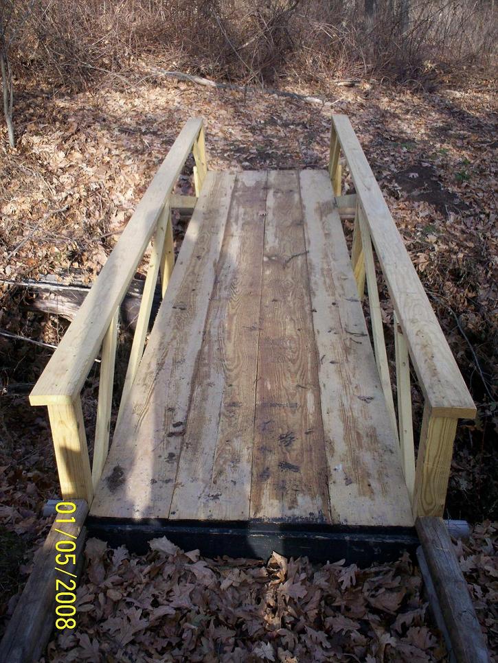

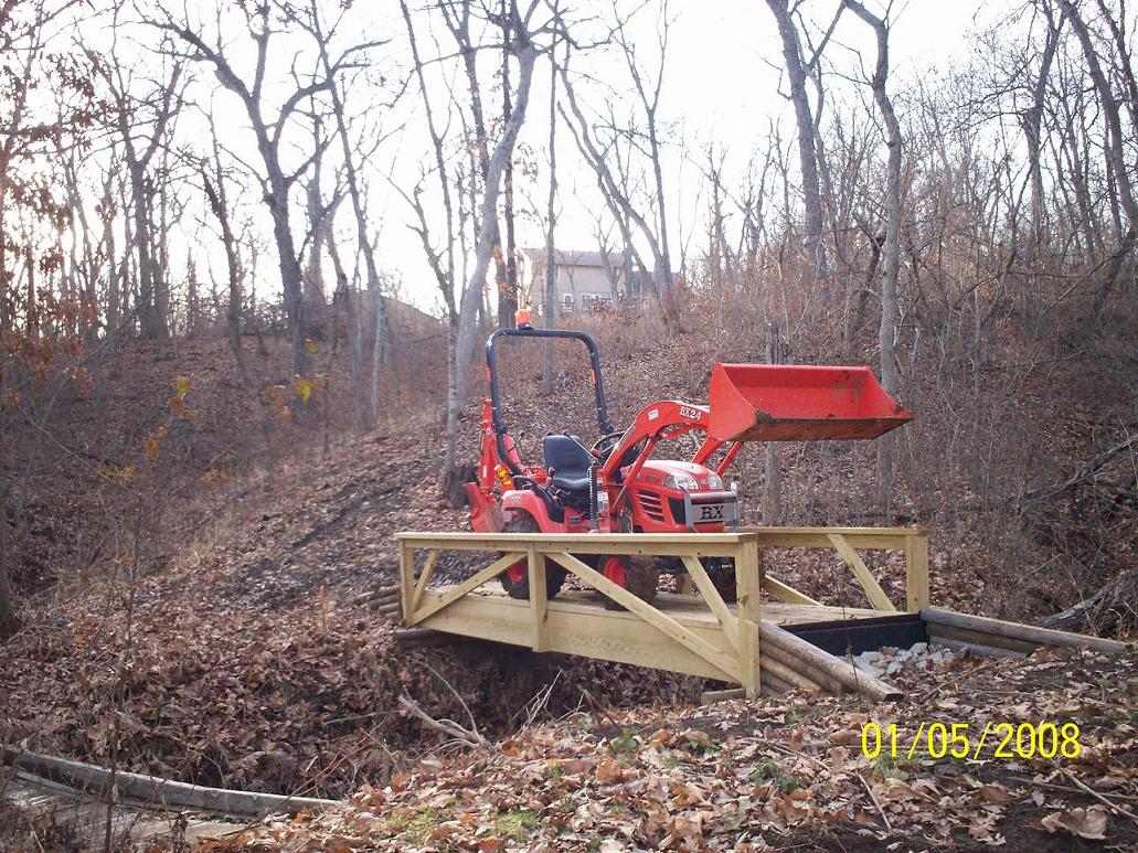

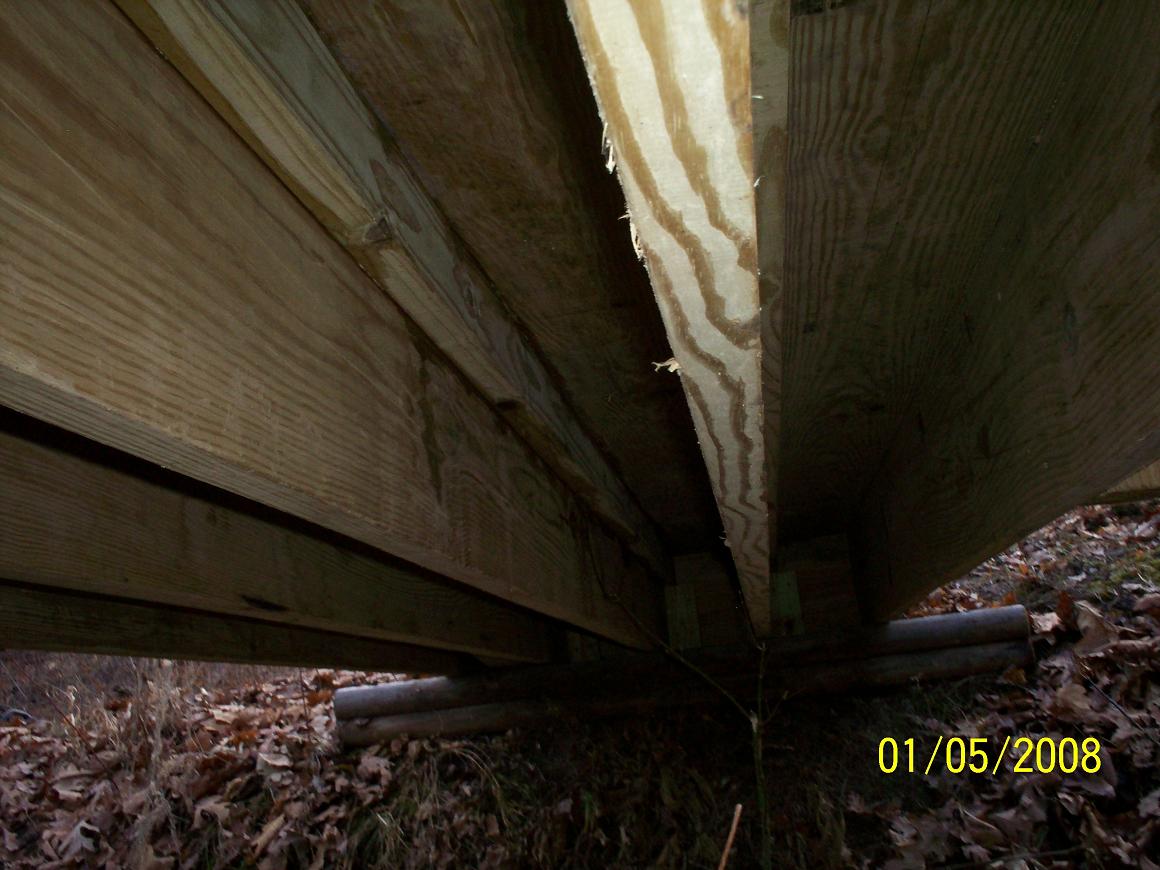

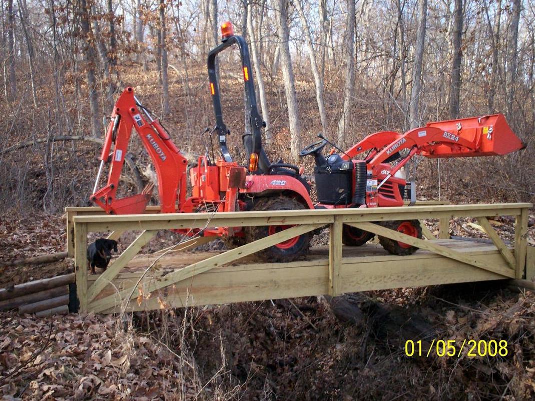

I want to build a wooden bridge across a creek for people, ATV's and horses.
Is 16' too much?
I built a 16' free-span bridge for exactly the same uses as you out of 2x12's and as you can see, it will even hold up a weiner dog!!:D The trick is to run your treads lengthways instead of across the joists. This spreads the weight of a hoof, foot, tire, etc. out along a larger area. I made it 4 boards wide, each 2x12 being about 11.5 inches wide for a total of 46". I deliberately made it this size (narrow) to keep unwanted vehicles from having access to my trails. I used 5 2x12's for the joists, with a 2x4 on each of the 3 middle ones. This keeps you from having to place the treads where they are "sharing" a joist to fasten to. I hope the underneath picture shows this clearly. Also, GLUE and SCREW everywhere 2 boards come together. Nails have no place in a project like this. The hand rail is just a truss in disguise to add support in the center making the true span only 8'. Putting the bridge above ground and back-filling up to it will add many years to it's life. There's plenty enough time for it to settle on it's own. Where I live, 16'x2x12 CCA boards are about $25 each. Do the math. Let me know if you need a better pic or whatever.
Randy

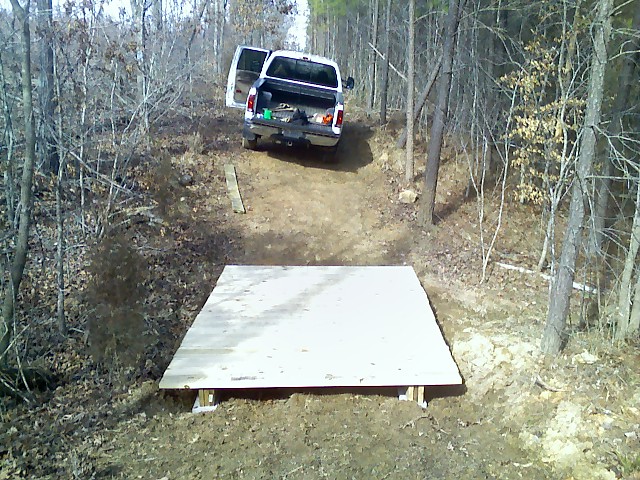

cdhd2001 said:
This sounds exactly like what I need to build for my little creek. How wide and what kind of footings did you use?:)
Standard 8 ft lumber, the bridge is 8 ft wide, 12 ft long. My footings were dug into the banks and set on 2" flat cinder blocks, I didn't pour anything. I am spanning over a "dry" creek bed. It is really a draw that carries water only after a heavy rain. Here is an early picture, there is no center joist yet.
