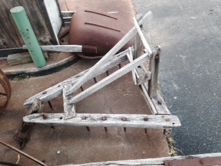

Built my wooden drag and tested it in my field for about twenty minutes yesterday. Did not have a disced field to drag so my real test will be in early Sept when I disc our club rugby field and drag with my homemade harrow. As you can see from the pictures,the drag looks like a big pallet. 5x5 Oak timbers held together by 6/4 oak boards. Sealed the wood with a preservative. The timber nails did bend some,so I am not confident the nails will hold up after long use but I expect to use this drag only a couple of times a year. If the nails completly bend up against the timbers, I think I will replace with rebar. Any opinions on that?

Unless you can find some 3/4" rebar I'd try something more like a railroad spike. I think the smaller diameter rebar will just bend up on you same as the timber nails did. 3/4" OD gas pipe cut 45 degrees on the end might work nicely, too - the only metal working skills you would need are using a hacksaw. You could secure them to your drag by drilling blind holes into your timbers.
I like the idea of making the drag out of wood as much as possible. It's the material you have in abundance, you clearly know how to work with it, and it recycles clean in the stove when it's wore out. A quick browse through either of Eric Sloan's books A Reverence for Wood or A Museum of Early American Tools will show what is possible. Just this past weekend I drove over a covered bridge in Vermont that is probably over 100 years old, almost completely made of wood and still solid as a rock.

The longer the spikes, the easier they will bend. If you go with rebar I think you'll have to use spikes that extend about half that length.
