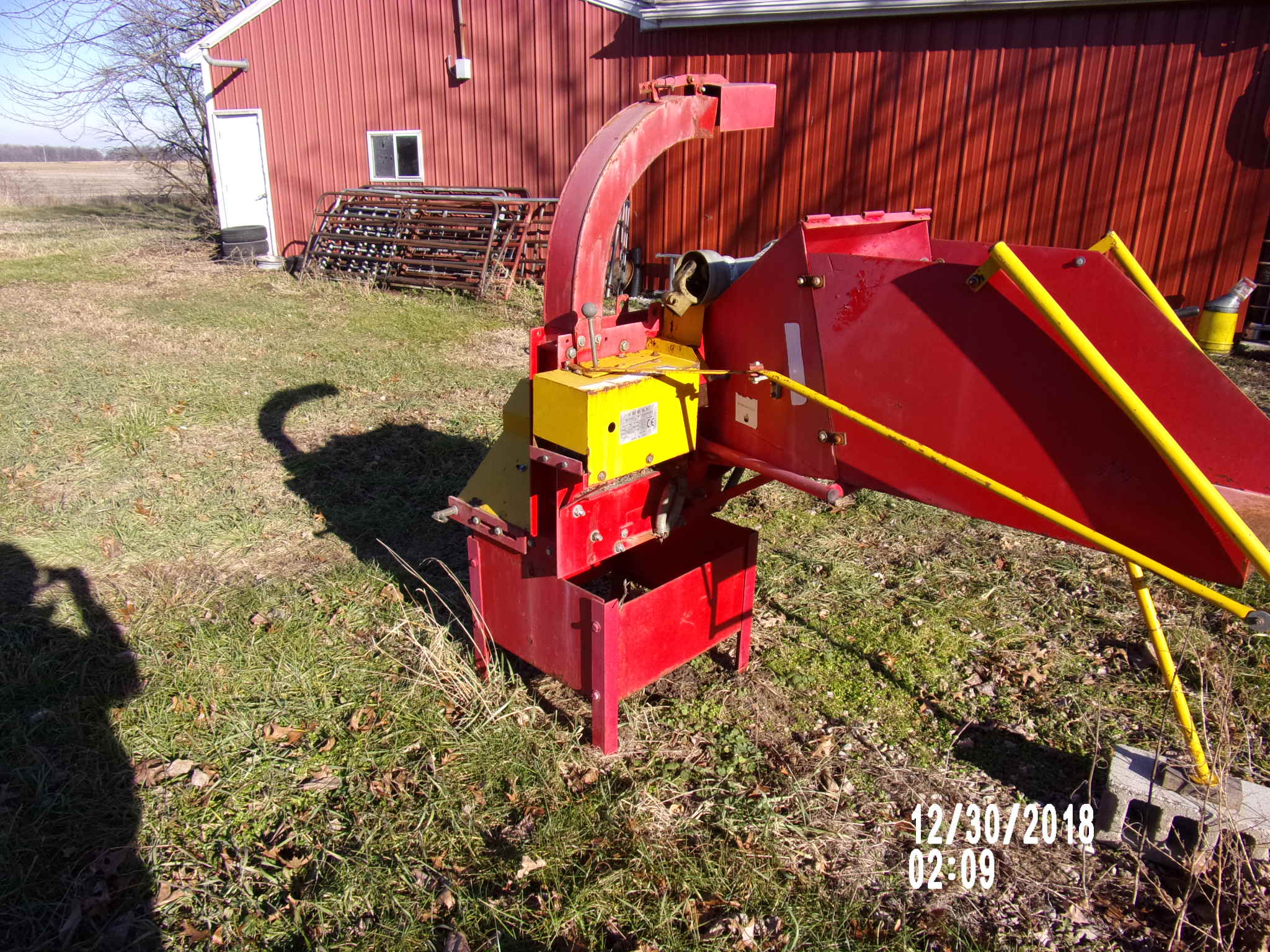

When I upgraded from the Ford 1700 to the Kubota M6040 ( 2009) - I looked for a larger chipper. I even considered the Valby brand. It required 50 hp and had a 350# rotor. Would have made an ideal PTO driven chipper. Problem - the closest dealer was in Montana.
   / Woodland Mills WC88 vs WoodMaxx MX-8800 vs WoodMaxx WM-8H for 60HP Kioti DK6010SE
#24
350# !!! That's pretty significant.
   / Woodland Mills WC88 vs WoodMaxx MX-8800 vs WoodMaxx WM-8H for 60HP Kioti DK6010SE #25
Valby even made a double rotor model - 500# rotor. Once you got it up to speed- it would probably go thru most anything with ease. It appears that model is no longer made. At least, with a quick scan - I can no longer find it.
