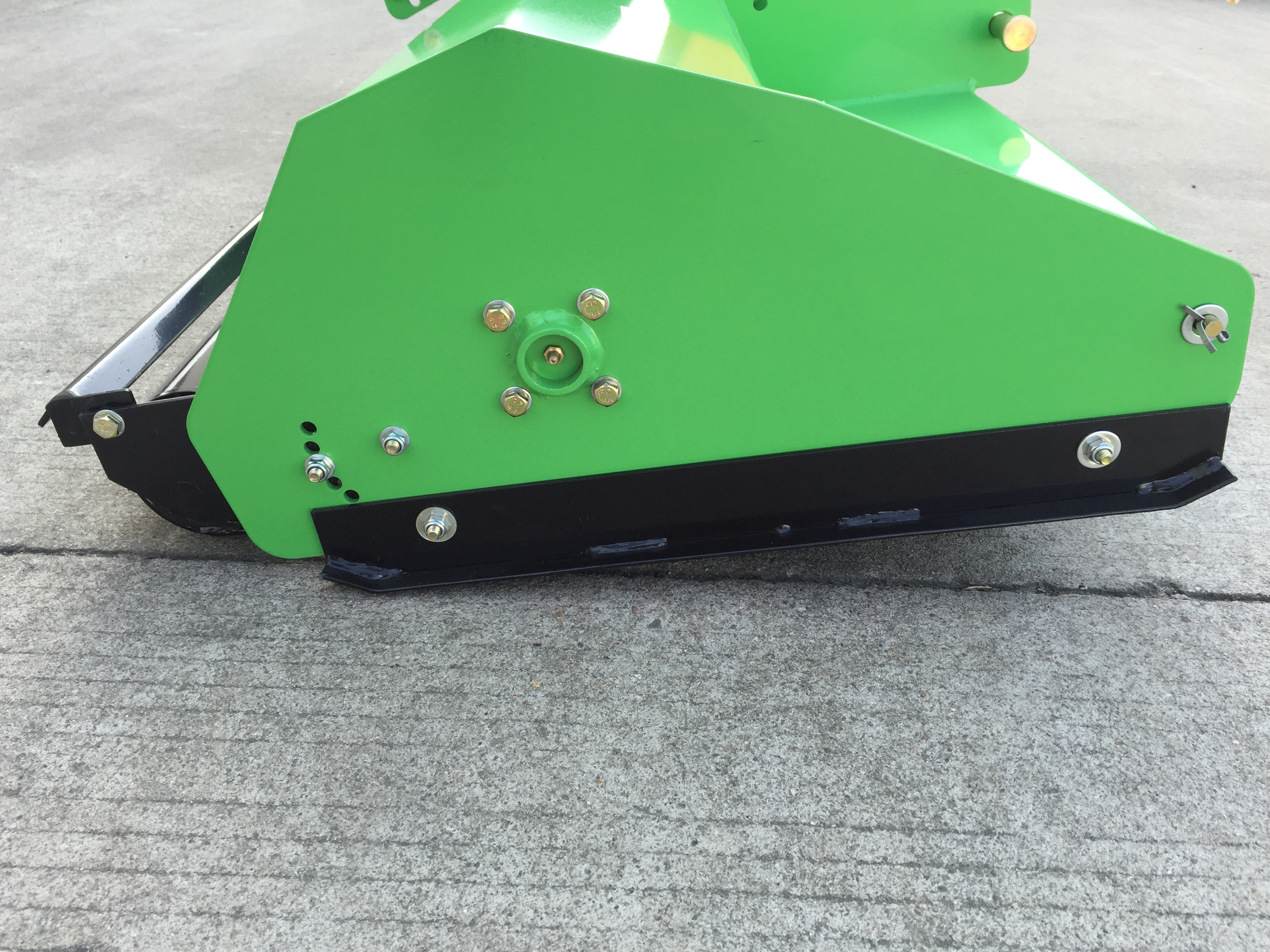

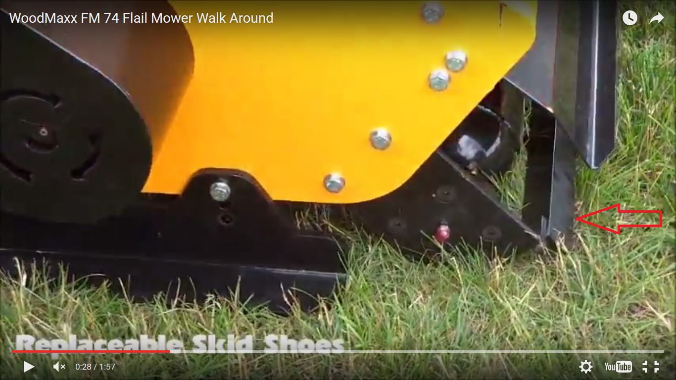

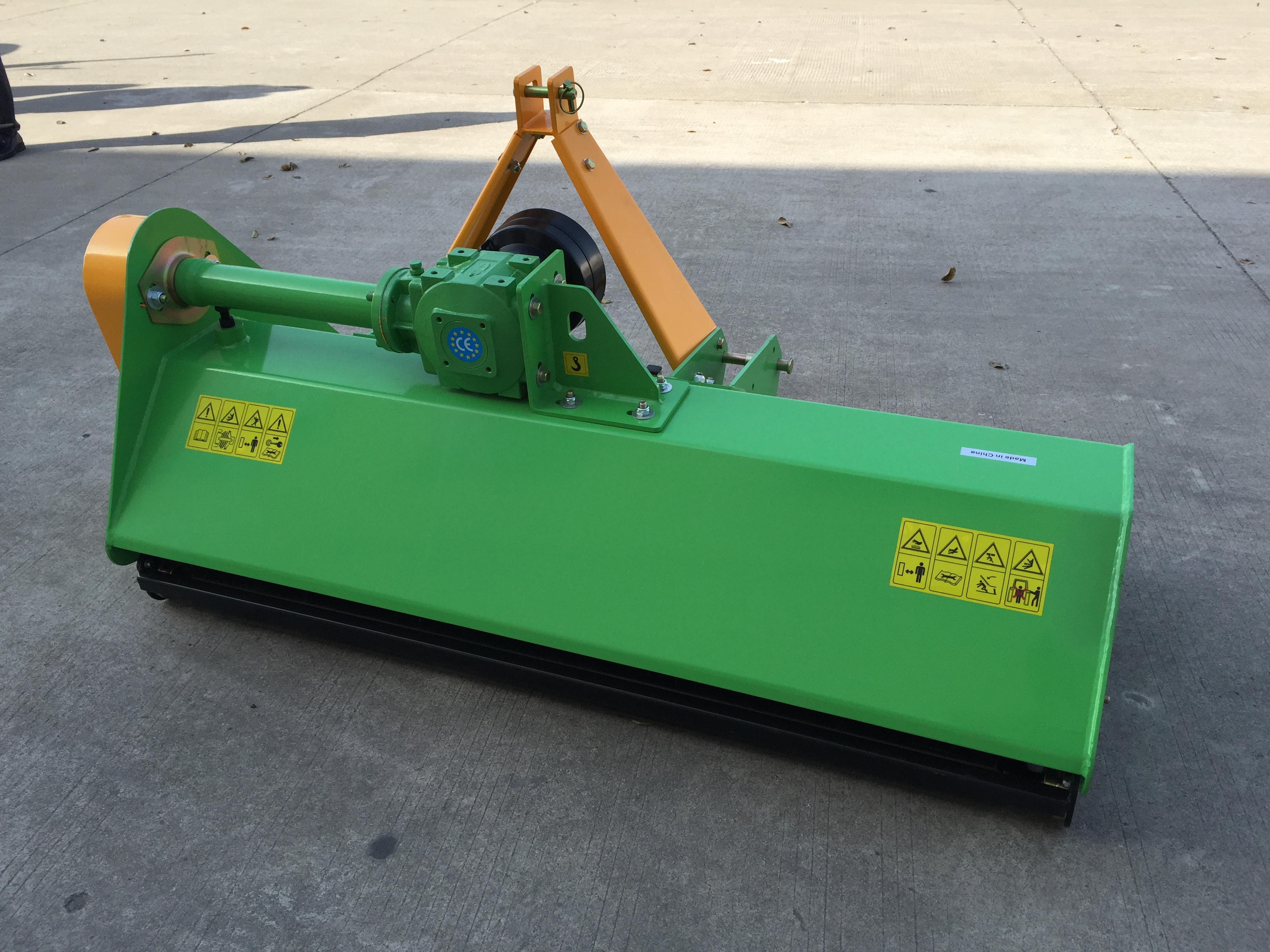

I just checked out the Woodmaxx website. Looks like nice equipment. A few differences in design from the Caroni TM1900 I have but their 78" model seems most comparable.
It has, as noted, a trash door. I've never felt a need for a trash door but I do tend to use my bush hog for really rough cutting of material like seven or eight foot high bushes and taller saplings. I have cut those with the Caroni and noted no issues but as those areas clearly have not been cut in years I prefer to use the bush hog in case I discover more old car parts etc. Tired of unwrapping car parts from the flail.
I also see that it has the PTO slip clutch. As discussed earlier, I don't know if I've ever seen a flail with a slip clutch before. The belts serve essentially the same purpose. I have a slip clutch on my bush hog that I dislike mostly because I use it infrequently and therefore need to spend 45 minutes each time to adjust the thing.
The flail knives are very sturdy looking but are directly mounted to the rotor rather than through a clevis. This will cut down on blade loss due to clevis failure but also removes an extra element of "protection" as the knives cannot pivot sideways when they hit a rock or stump etc.
I don't see an adjustable side offset on the FM78. Maybe it just isn't apparent. The Caroni has two obvious positions to setup the 3PT attachment mounts which give up to about 15-18" of offset to the the right. Useful when mowing near trees or ditches or fences.
I'm a bit surprised at the pricing. Maybe it is just the list prices but the model that is closest to the Caroni TM1900 is four hundred bucks or more extra. FM-78 Flail Mower | Tractor Flail Mower | PTO Mower Attachment | -WoodMaxx兌/url]

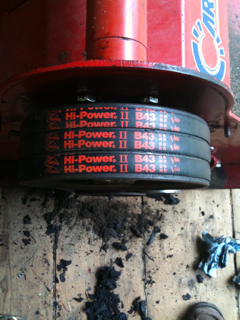

Wondering whether one can forgo adjusting a slip clutch if the belts pretty much do the job of absorbing excess shock.
If your belts are properly set, a slip clutch is useless except when a gearbox seizes. Pretty much every failure I've heard of is the opposite where the gearbox either grenades or stop spinning the output shaft.
Personally I haven't heard of problems resulting in PTO damage. The PTO shaft always pretzels before the PTO gear in the tractor.
Takes what? 10 minutes to replace a sheer bolt? You've spent as much time replacing sheer bolts in 6 years as you'd have spent adjusting clutches every year. Not a bad deal I'd say.
