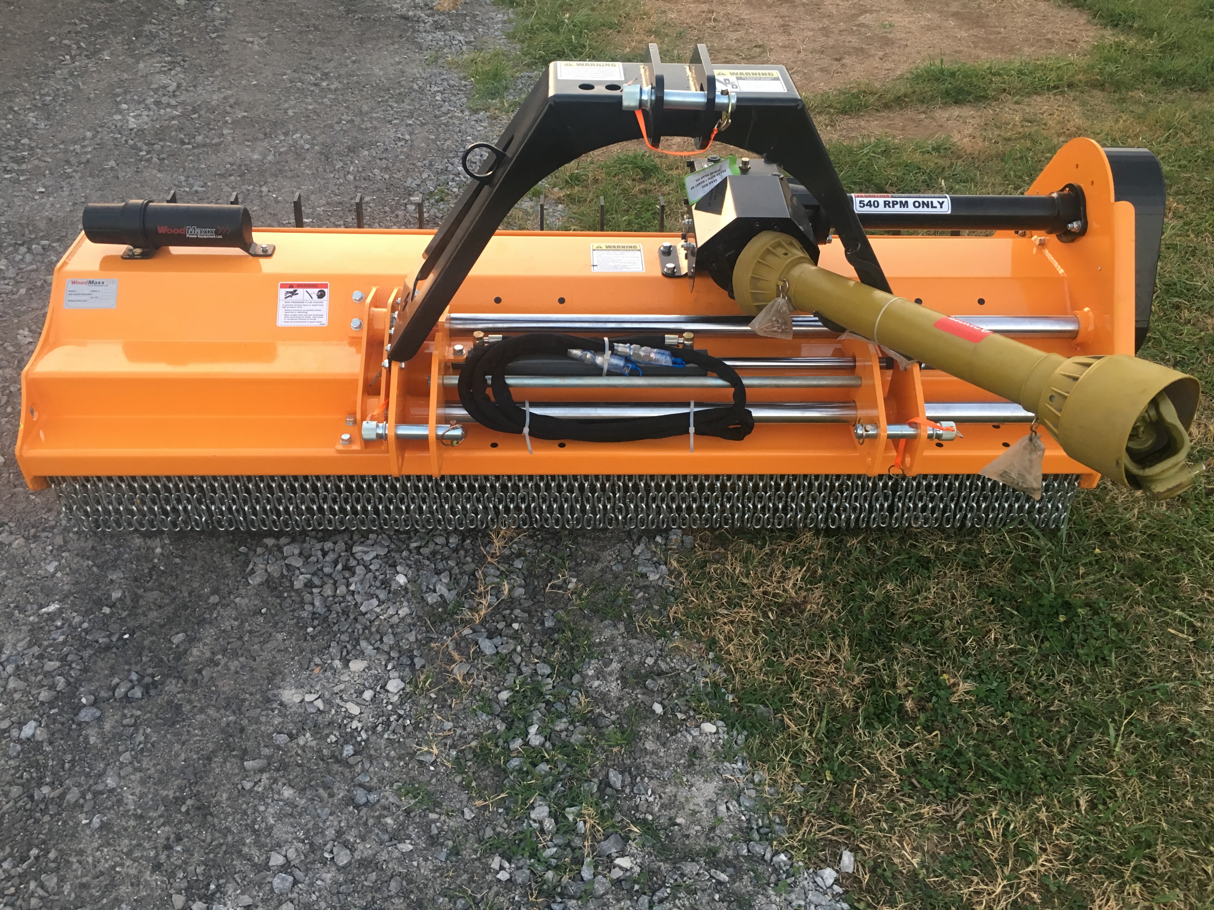

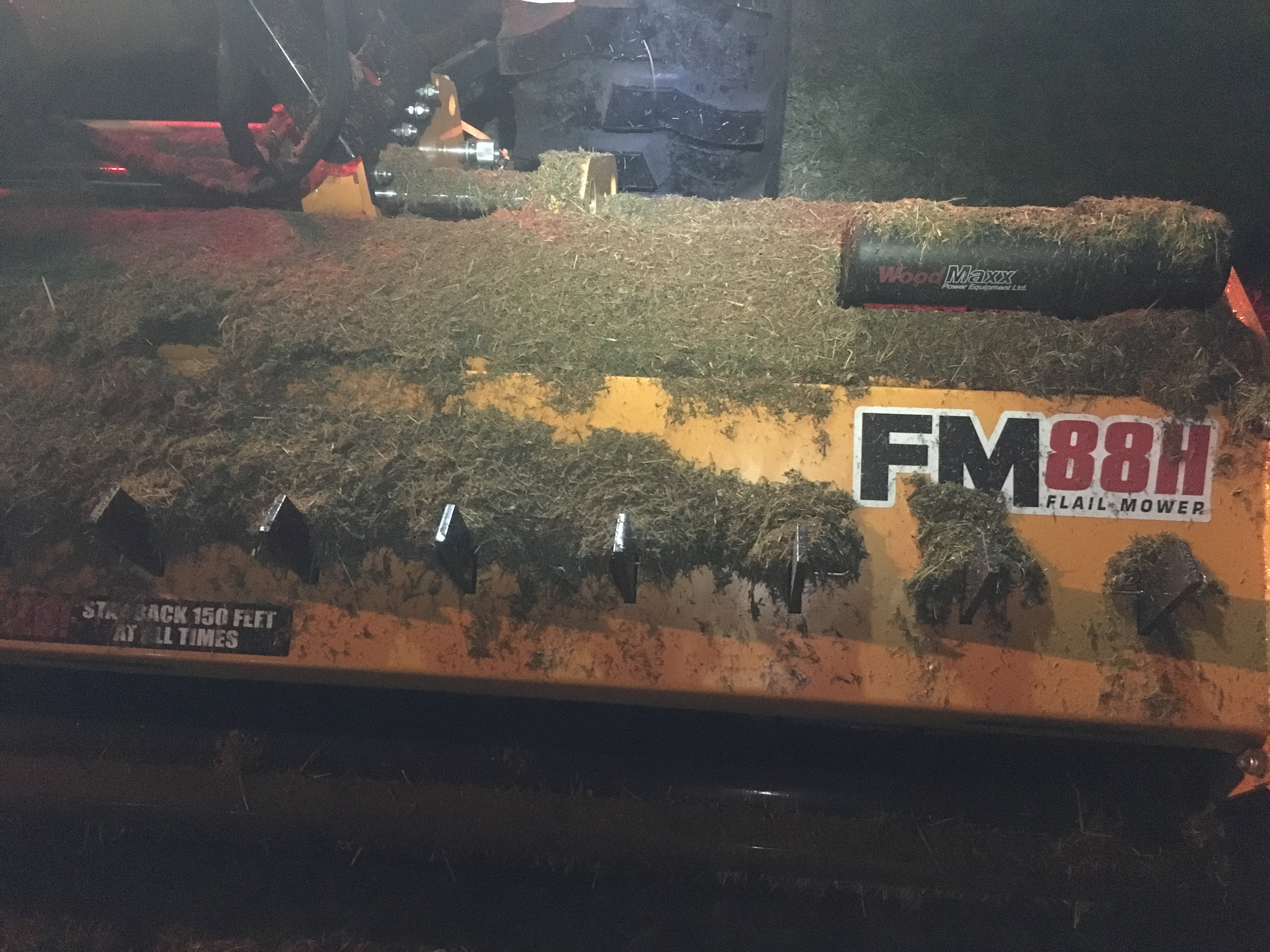

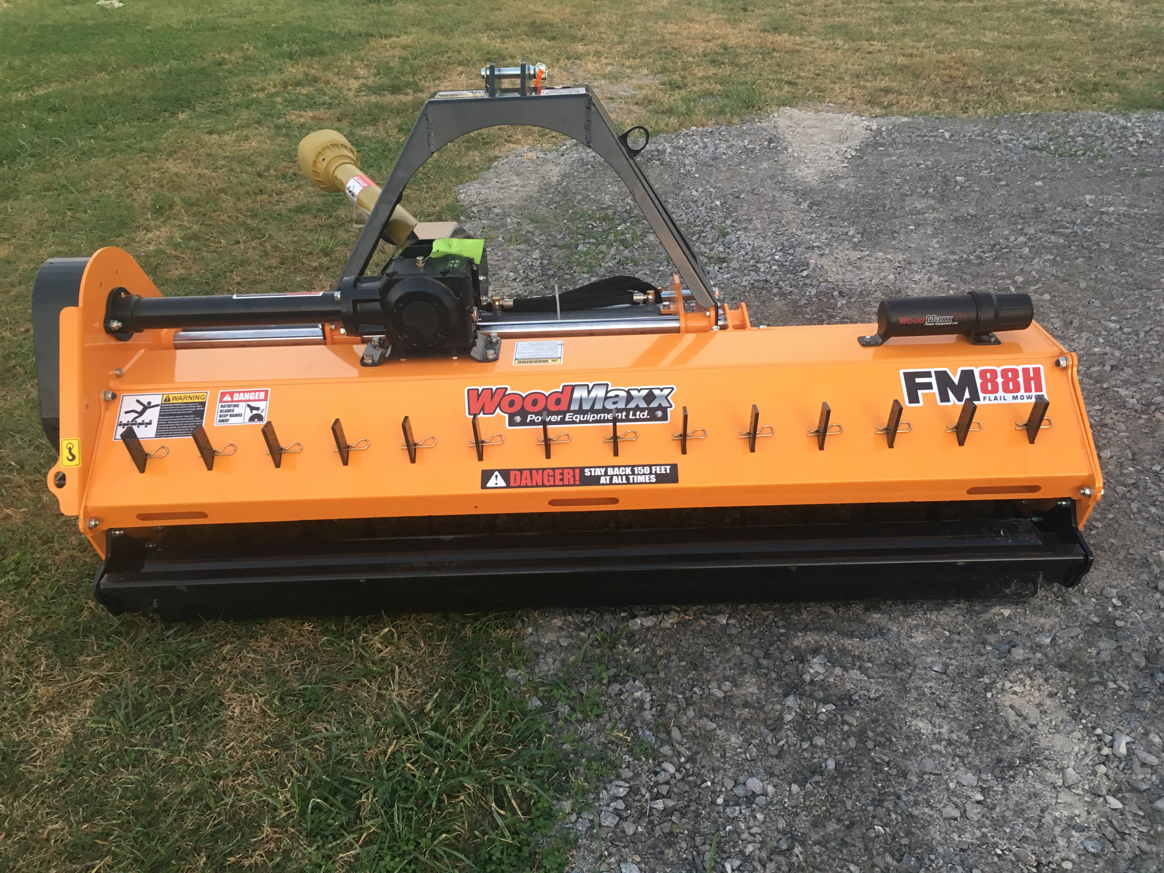

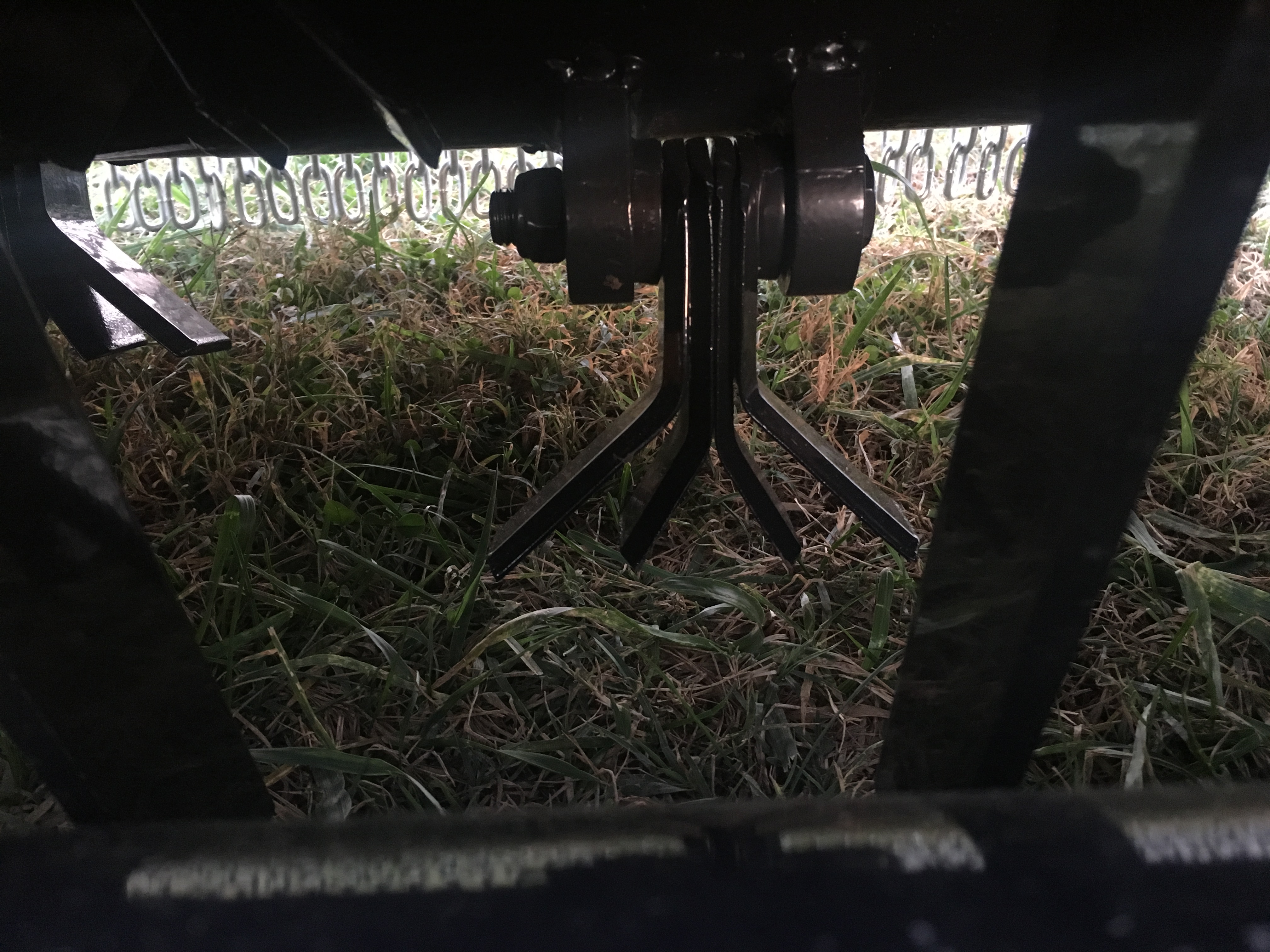

I have my new Woodmaxx FM-78 here, assembled and on the tractor. Just 1 hour of mowing so far but so far, so good. It seems to mow slightly better than I remember for my Caroni TM1900 flail, both with the same type of knives. I'll be posting a full review as a new thread when I have enough time to say a bit more.
