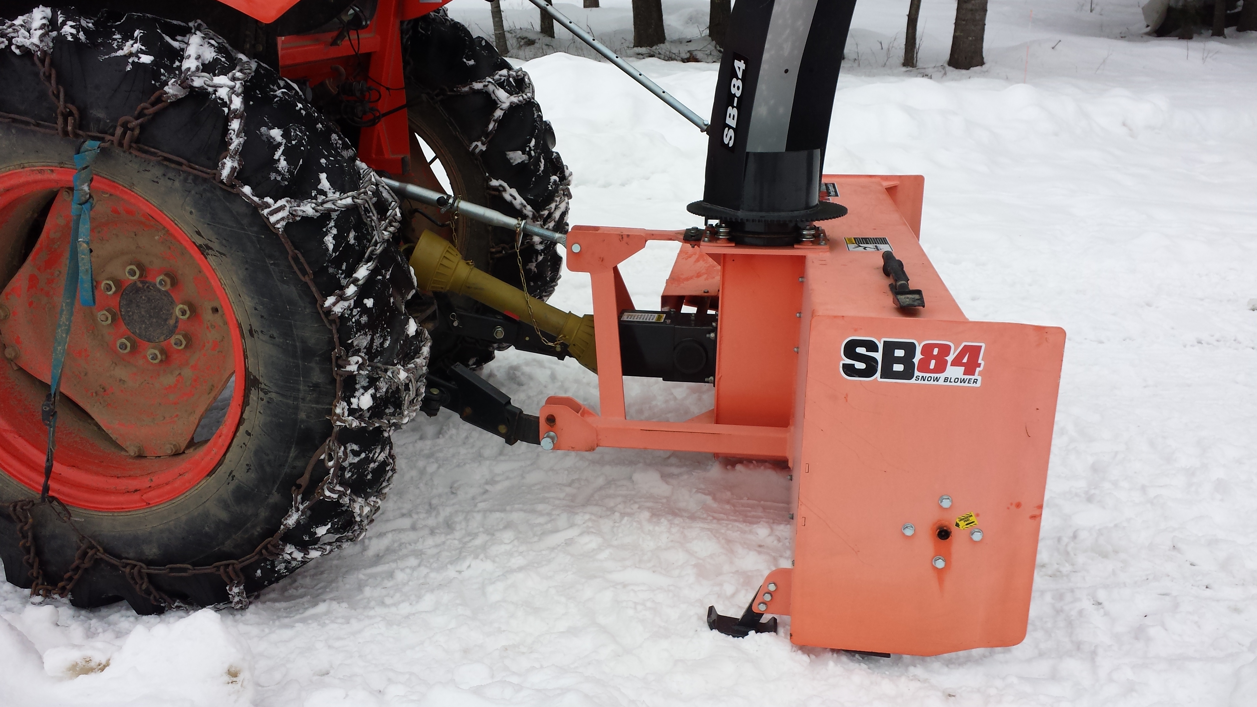

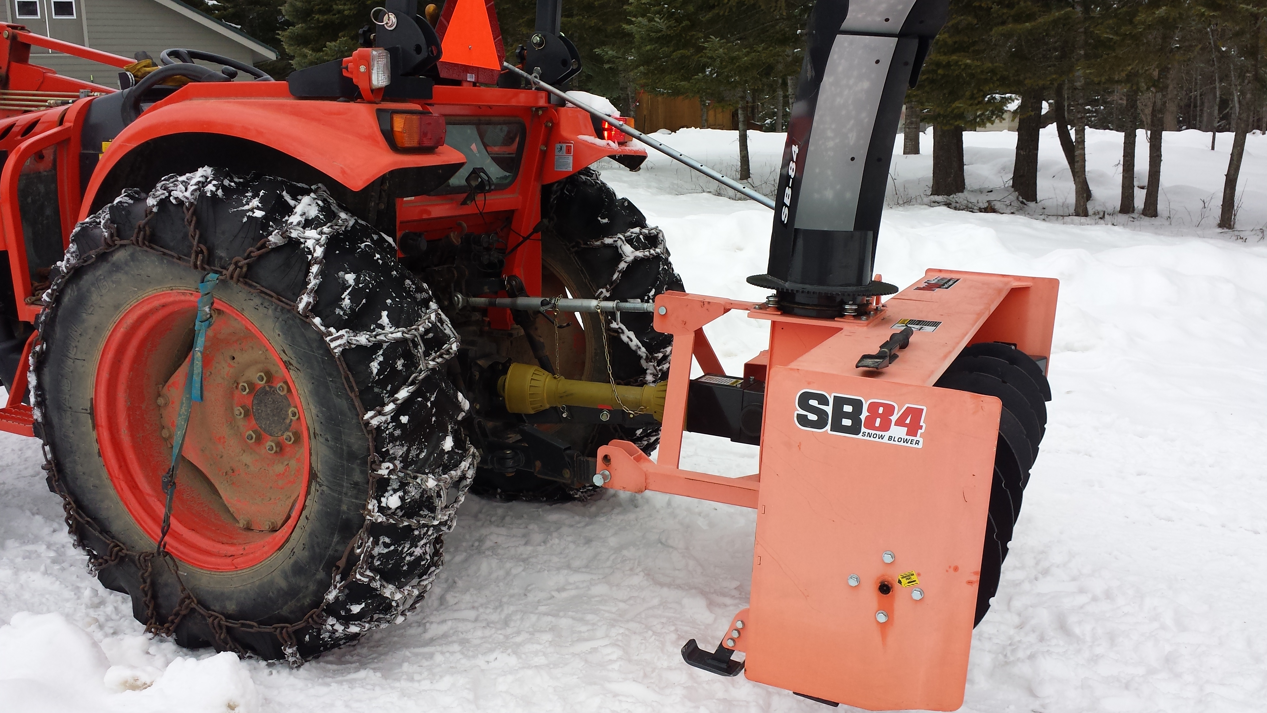

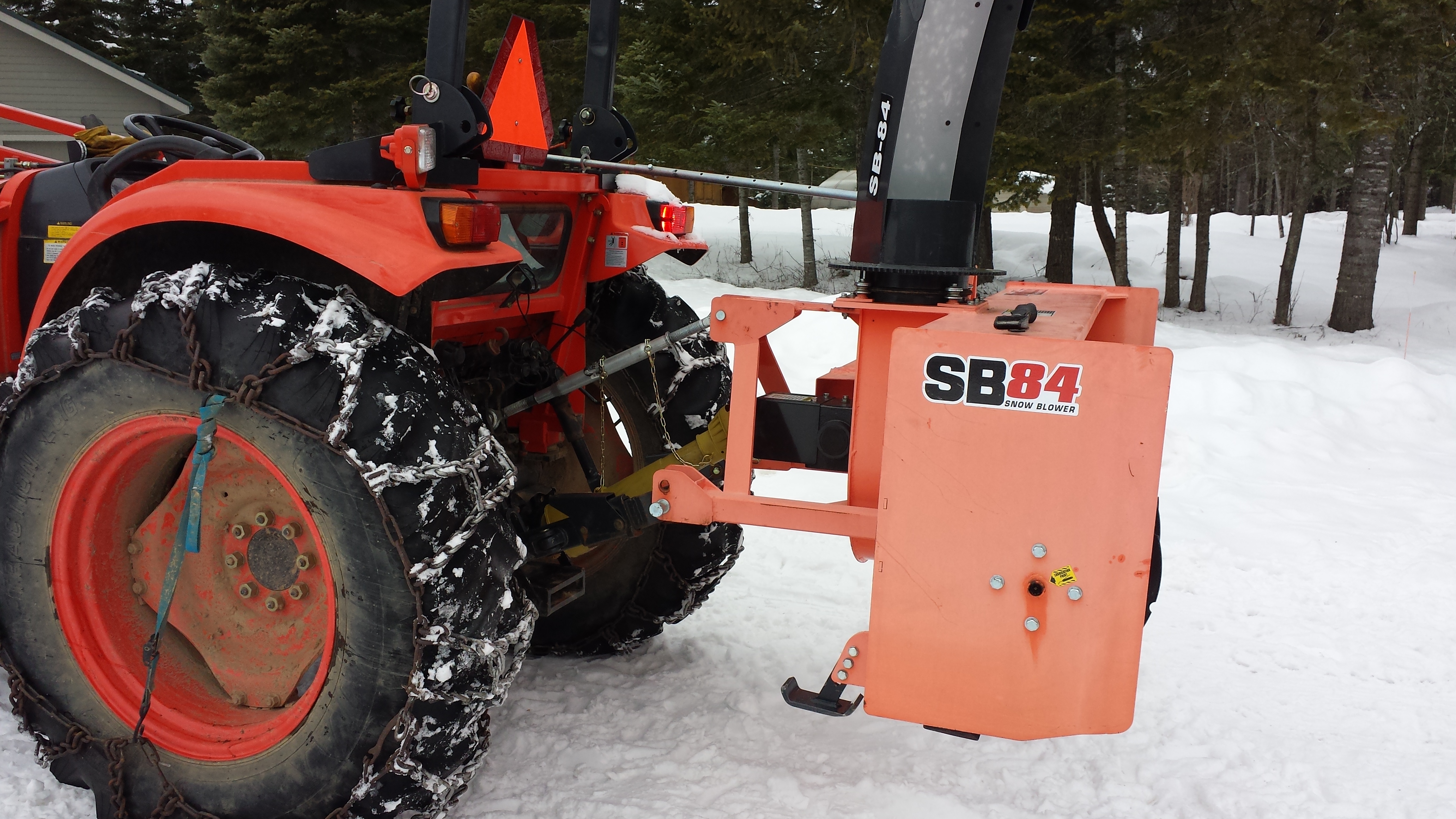

KanataRick:. I have learned a great deal from your thread. Thank you. Angles, parallelagrams, and PTO shaft phasing - that was a big one. I feel like I owe you. I'll bring you some shear pins the next time I am in Ottawa, but I guess you will not need them!
Here are a couple of photos of my DK5010 and a blower not rated for 50hp. There is 9" of offset between my tractor PTO and the blower input. My angles seem tolerable and so far in my first winter with this setup I have not broken a pin.
Let us know if you make it through a storm without breaking one!!! IMG_20190222_151533.jpegIMG_20190222_151544.jpegIMG_20190222_151619.jpeg
