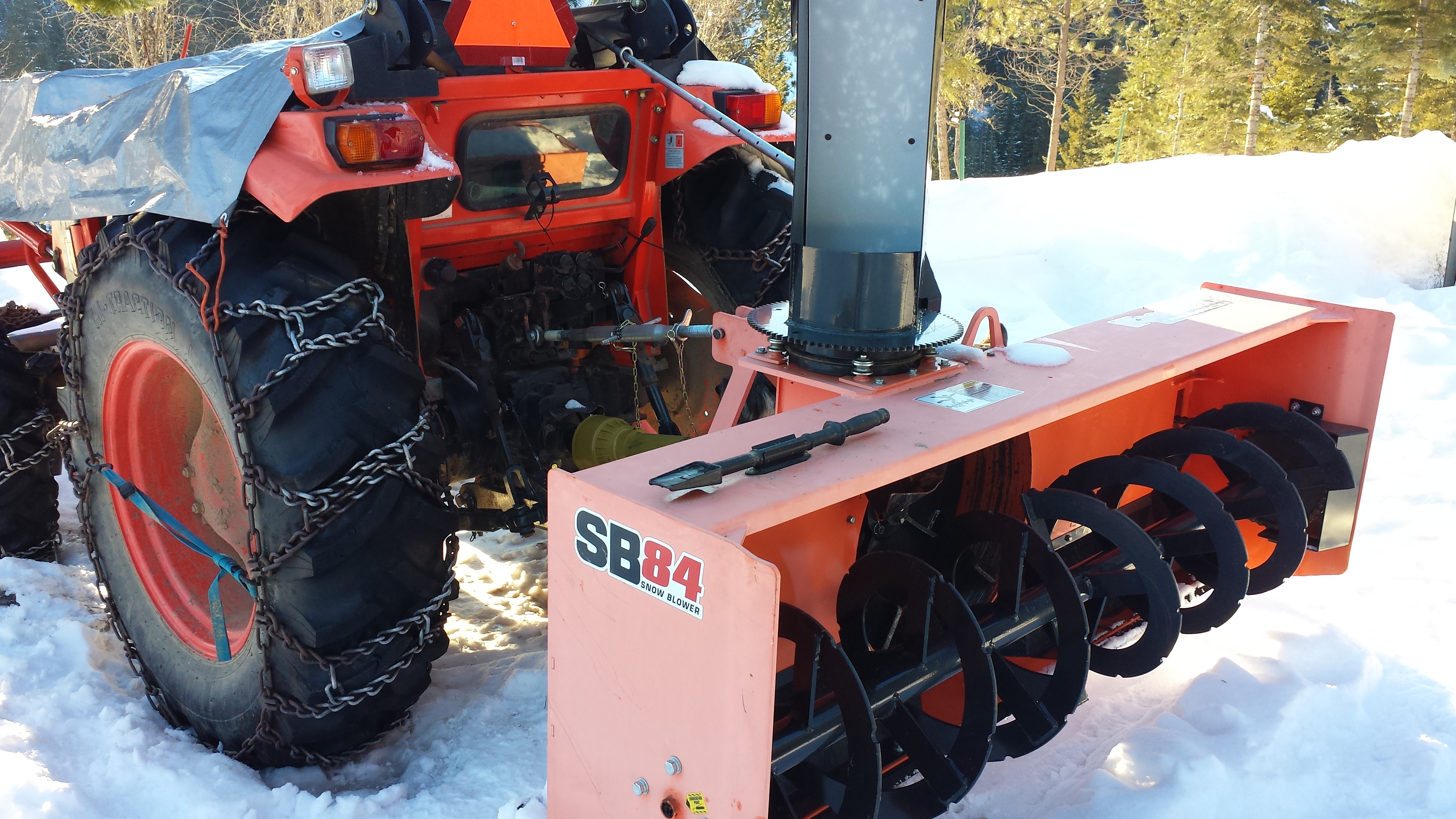

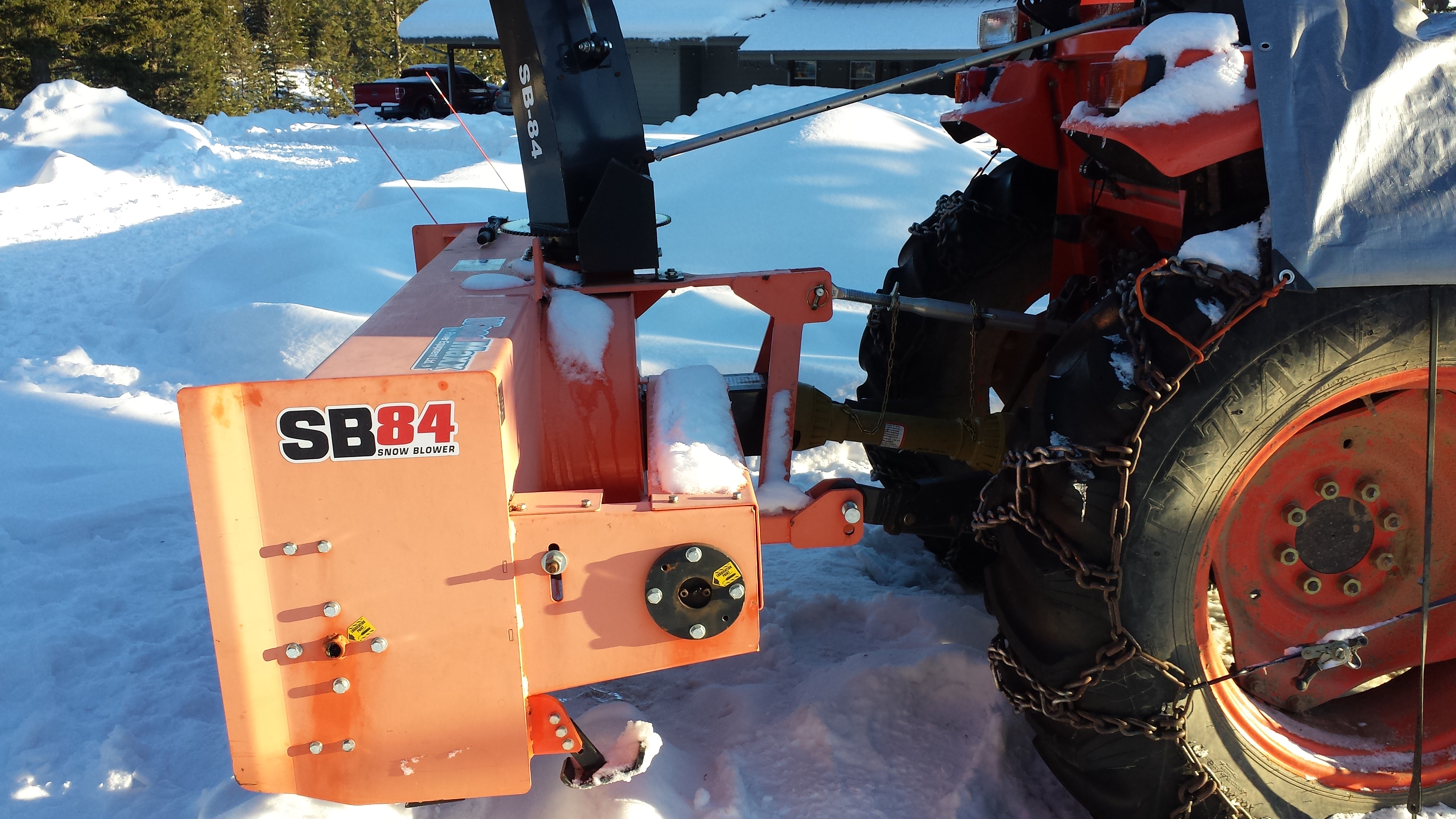

I just adjusted the top link by lower it to the bottom holes and it now looks a little more level in the raised position. I should be able to try it Saturday cause our next round of snow is suppose to be Friday evening.
   / Woodmaxx Snowblower Shear Bolts? #132
Install you're draft arms in the bottom holes of the blower as well and then put the blower on the ground and adjust the top link to level it. It's all in the pivot point locations.. The blower in the raised position should look a bit tipped towards the ground, and level out by the time it hits the ground.
   / Woodmaxx Snowblower Shear Bolts? #133
THIS!
You MUST drop your lower link arms down into the BOTTOM holes in the blower brackets. Since you've already moved your top link down, moving the link arms to the bottom holes should put you right.
   / Woodmaxx Snowblower Shear Bolts? #134
As best I can tell from your pictures I agree with the others, move the lift arms to the lower holes in the blower so the upper link and lift arms are as close to parallel as the combination of holes will allow.
Ideally the blower should remain level through it's full range of motion, from on the ground to fully raised.
