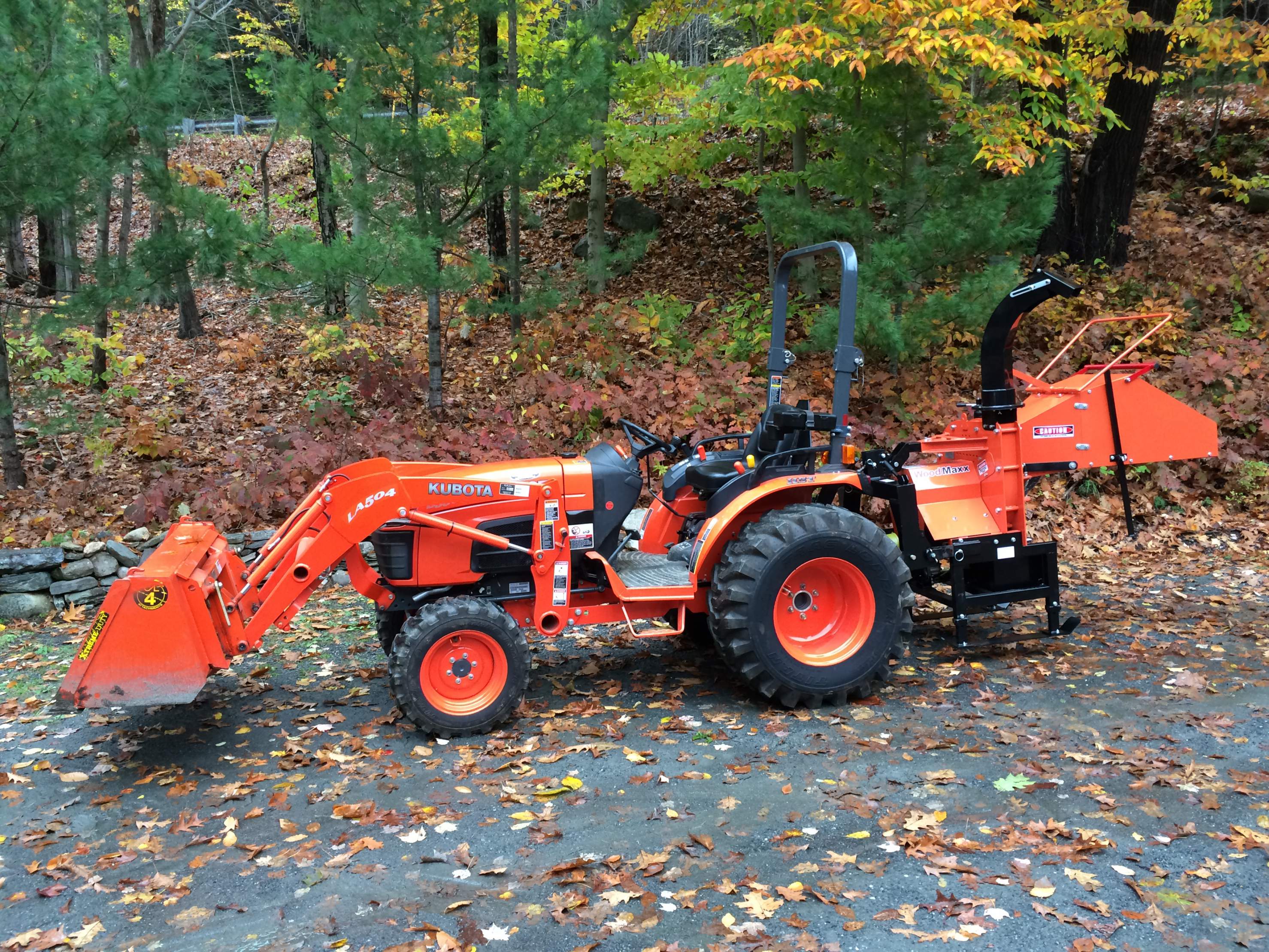

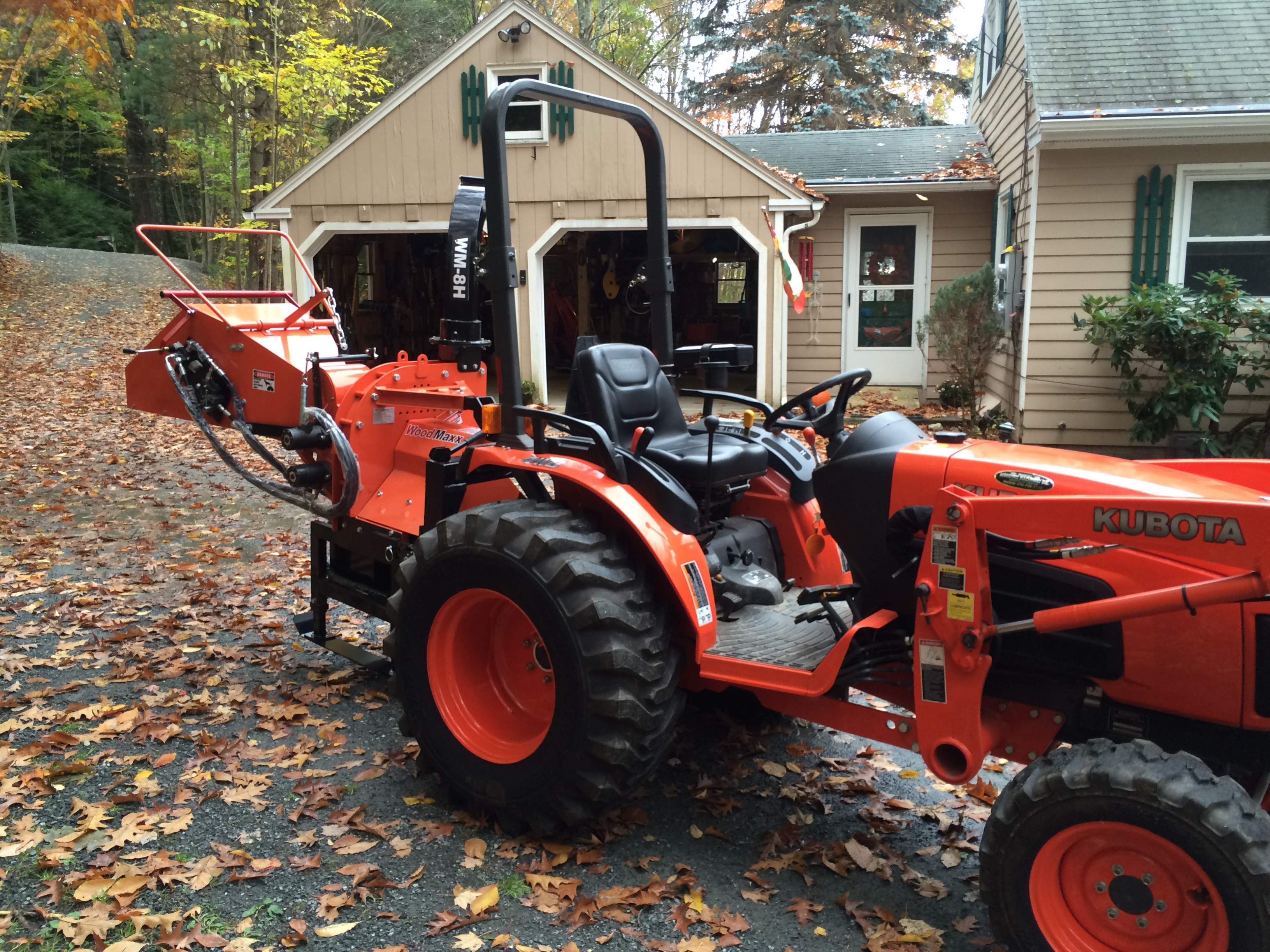

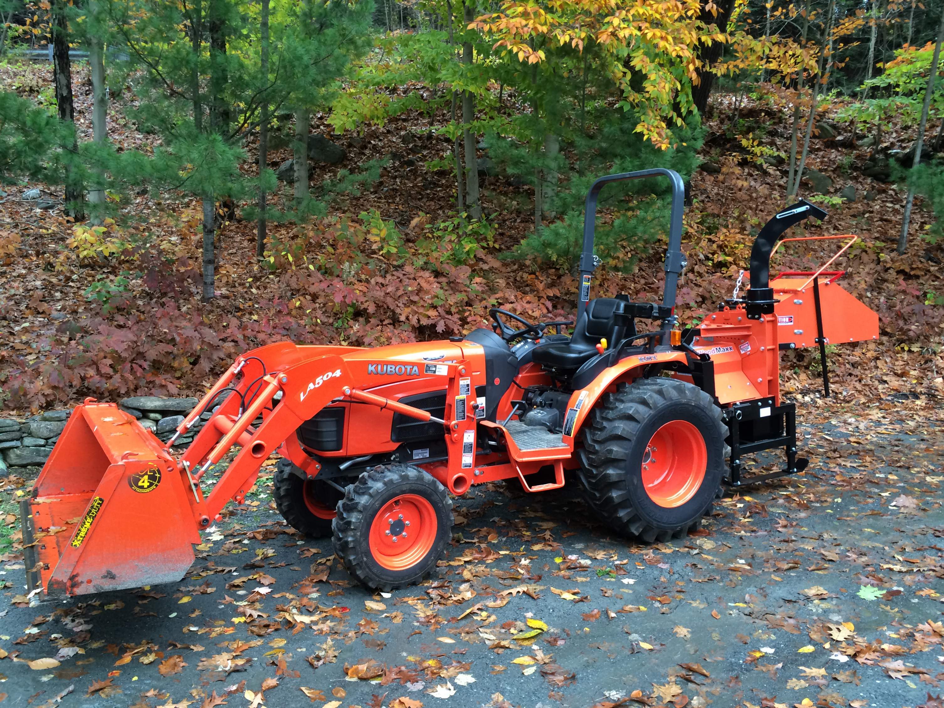

I took delivery of my Woodmaxx WM-8H Monday. I've got it ready to go now once I cut the PTO shaft tomorrow. I hope to be out chipping this weekend!!!
Sent from my iPhone using TractorByNet
   / Woodmaxx vs Jinma chipper #68
Assembly is complete - turns out I didn't have to cut the PTO shaft after all! I'm hoping to get out tomorrow & put it to use!!!
