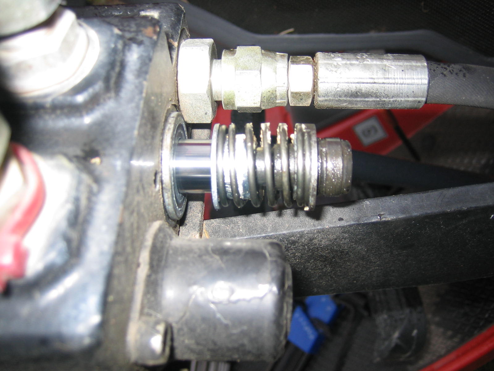

I have a Woods 1006 serial #050592 on a Kubota B7200.
The manual, the labeling etc indicate it has a float position, joy stick fully forward.
It operates properly in all other aspects but the handle hits a hard stop (no detent) on the down direction.
I've removed the spool detent assembly (almost lost the little balls) and found this to be a bit gummed up and rusty.
I thought then that the solution would be to clean everything, re-lubricate and reassemble.
That done it still will not move to a detent position.
The control valve is a Danfoss but there are no markings other than a small metal plate with the Danfoss name and a number (3039) in the casting.
I am not able so far to find any information about the construction and function of this valve.
I'm looking for suggestions for information and a fix.

I spoke with the Mechanic at my local Kubota dealer - finally - and he's certain the Danfoss control has a float position.
He's suggested that I remove the "cup" again, be sure the interior is really clean, drill a tiny drain hole, fill the cup with grease and re-assemble.
He said the valve only needs to go just a little futrther to reach the float position.
I'll try it when we get a break in these low temps.
   / Woods 1006 will not float
#9
Finally a warmer day has come so I've taken off the spool detent assembly once aqgain and thoroughly cleaned everything.
I re-assembled the assembly with grease and the recommended drain hole.
Now it's all nice and clean and still doesn't go into a float position.
What next?

Not sure if this will help. The bolt on my Nimco valve that compressed the spring loosened off and would bottom out on the cup before it reached the float position. I tightened the bolt and got float.
