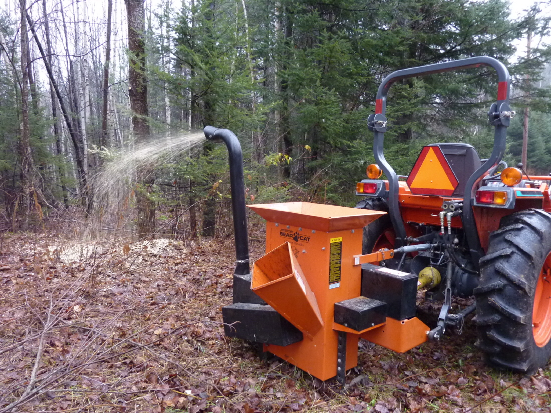

I have a BearCat with a blower that I bought used and have owned for five or six years. I have no trouble with the blower chipping wood. But if I put in a 4" diameter piece I cut it 3 feet long or so. This gives the blower time to empty the fan chamber which is done by the time you pick up the next piece. I only have to do this on big stuff. I can take a 2 1/2 inch tree 20 feet tall and it will suck it right in and blow it out.
The other issue is using the shredder. There is a grate between the chipper outlet and the blower inlet. If you want to shred wet materials like leaves you need the shredding grate or it will clog. I think the holes are 1 1/2" or more. My original grate had 7/8" holes and it worked fine for dry leaves but would not handle wet ones. It would clog. And don't put anything stringy like green pea vines in it. You would not believe the tangle you end up with.
Also, realize that it takes additional power to drive the blower. I have 25 hp at the pto. More would be better of course but if you have less your experience may not be as good as mine.
The center of my outlet shoot is 65" above the ground and it is a 4" pipe.

Gord, thanks for the insightful reply and pic. How hard do you think it would be to extend the discharge pipe a little higher? I see the offer a extention for it but on the trailer mount unit so I'm sure it's not impossible. I'd have the same pto hp as you and did realize the blower robs some power. Your's looks virgin do you use it alot?

The extension they show in my manual is a horizontal extension. Have no idea what would happen if you made it taller. You would be fighting gravity as you know.

I guess that means that alot can come out and it will pile pretty deep. So be careful :laughing:

I've got a call into bearcat about extending the shoot. I'm only looking to go another 12"-18" so I don't anticipate too much of an issue. Was hoping to get there today, but life got in the way.

I finally heard back from Bearcat and they said I shouldn't have much of an issue extending the shoot slightly. They said to feed slower if I do. Unfortunatly I missed the unit that was forsale. But at least now I know. I've located another for just under 2k but it has the blower so I feel that's not too bad.
