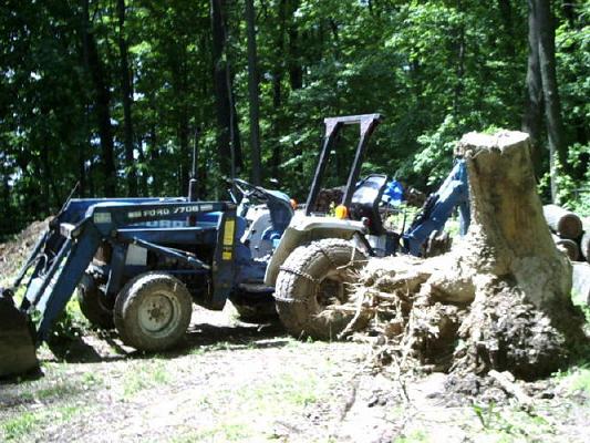

Hi,
I purchased a Woods 7500 for my TC30. I was fortunate enough to find a used one at my dealer. I paid $5500.00 for it and it was only 1 yr. old. It came with a 12", 24" buckets and subframe mount. This price also included installation and all the necessary hoses and fittings.
As far as reach goes. You can never have enough of it. I would definatly go with the 7500 over the 6500. I would also recommend the subframe mount. My old tractor had a 6500 3PT mount and it wasn't as solid as the subframe. I have alot more confidence in the subframe. I think the 12" is the perfect fit for a small backhoe and it digs exceptionally well with the narrow bucket compared to the 24" and so on, but thats just my opinion. /forums/images/graemlins/smirk.gif
It's not a fullsize machine but is capable of handling alot. I have attached a picture of the backhoe from the previous owner of what it is capable of.
And 1 more thing. I have never regreted buying the BH to have and use at my discretion.
/forums/images/graemlins/grin.gif /forums/images/graemlins/grin.gif /forums/images/graemlins/grin.gif
Good Luck with whatever you decide.
