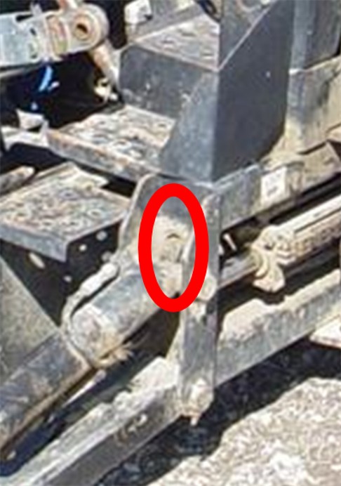

Hey, good job.
I have put ~100 hours on mine and am happy with it, just dont expect it to be real backhoe.
Two things I want to mention are:
With that size tractor and a subframe you will need and 20 foot ramp to get it on a trailer.
and in the area show in the pic, inpsect the hoses for wear, I have replaced two hoses there.
