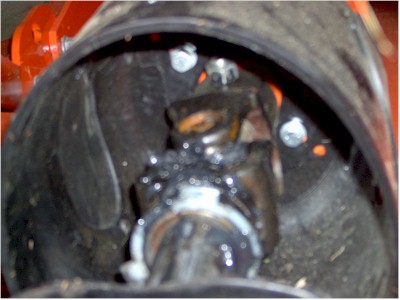

Let me know what you're dealer says, my dealer still telling me i have a slip clutch, he said they do not sell any without them. When he is in area he said he will look at it. I highly doubt i have one, e-mailed him pix, there is no cluch, this is right in front of gear box. I'll be sure to check adjustment when i install or get it.
   / Woods BB60 Rotory cutter Slip clutch #19
NOPE, the cutter is NOT equipped with the slip clutch that you purchased..............Also, I just want to say that I don't think that you should have to "wait for the dealer to be in the area", either.......Someone from there should get on out there and take care of you, unless you and the dealer agreed on "arrangements for warranty work" when you made your purchase.

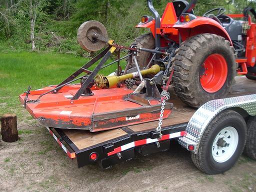

The thing about slip clutches is that they seize up during shipping and during periods of nonuse. So the same spring length will allow slippage at different torques when the clutch is all rusted and stuck vs. the clutch that is recently slipped. My slip clutch instructions had no spring length chart but it did have instructions about loosening the springs as needed to provide slippage but not to overheat. Very vague, I feel the clutch for warmth every now and then and to be sure it is slipping at least a little bit on the big hits.
A slip clutch is not a set it and forget type deal.
For the sake of the thread, please find the attached photo of my slip clutch on the mower.
