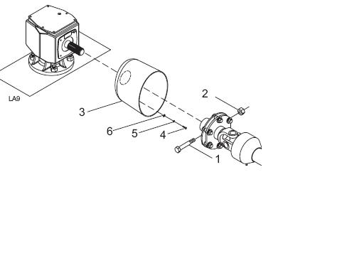

Here is a link to the Woods brushbull online manual (PDF)
http://www.woodsequipment.com/manuals/manuals/Ag/MAN0050.pdf
It shows the slip clutch and tells how to adjust. If you have a slip clutch you should easily find it. On a side note how do you drain the fluid out in order to replace it at 100 hours as Woods recomend?

Thanks to all, I understand much better now. I know i deffinitly do not have the slip clutch now and was not standard on my model as posts said so i see why its possible to come without one.
The pix i sent the dealer and posted here, he said he thought he could see the slip clutch in it??? Its not there, and i'm not going away that easy, he said they check all there records and the unit he sold me had a slip clutch. So i guess if he has record of it, he is going to half to talk to Woods on why he did not get was was on his records. I'm in no rush to get it but i think I'd better just take the driveline off and take it up to him so he can get this ordered for me rather than waiting for him to stop by. i'd take the whole unit to him but have no trailer, dealer dropped off for me. This site is great and everyone so knowlegable and helpful, thanks
   / Woods BB60 Rotory cutter Slip clutch #26
Bob, you seem to be right on track and have a level head. Getting in a big rush doesn't help matters any, but also if you wait too long; well, things tend to get worse. Good luck. It's apparent that you don't have what you were told you have.
