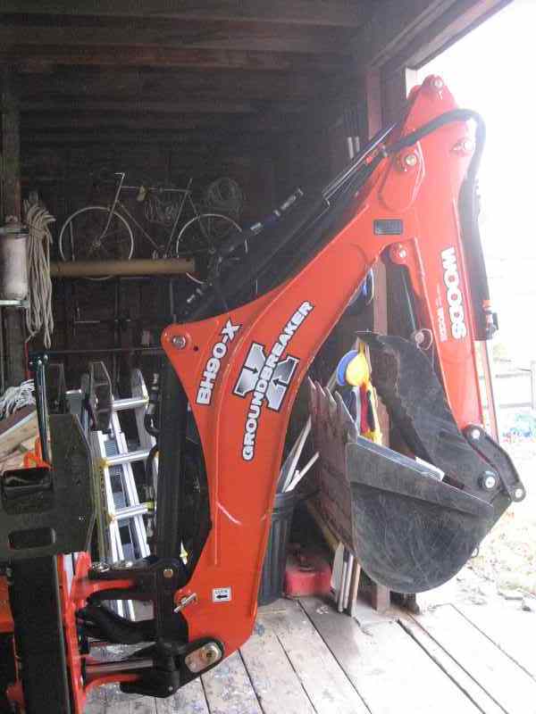

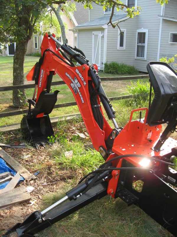

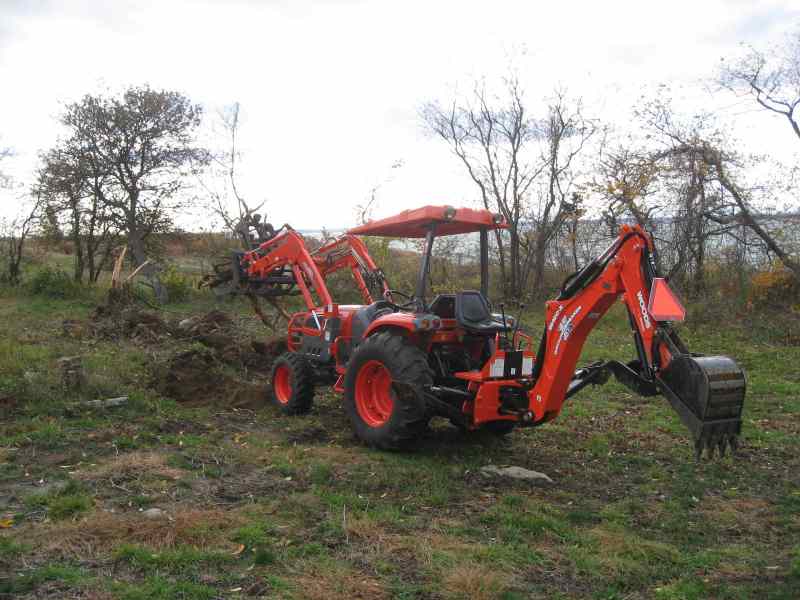

That would get you one of these: (photos)
Looks like we have the same taste in both flail mowers and backhoes.:)

Woods does not make a 9 inch bucket for the BH90x according to a local dealer I called. The 18 inch bucket is a good match for the 90x and is what I have. I dig up stumps mostly and my only complaint is that the holes are unnecessarily large. The BH has plenty of power to do stumps with the 18 inch bucket, I just don't wnat to dig a big hole every time I pull up a 6 or 8 inch stump.
I am investigating a ripper tooth. Woods doesn't make one. Brotek is willing to make one but their standard ripper is kinda small (meant for the BX24) and I haven't seen anything they've done for a bigger BH. Bradco stocks a ripper for Bradco hoes but I don't know if it is easily adaptable to Woods pin mount. Many companies make rippers for big excavators but no one seems to make one for the Woods.Going to a metal fabricator is a possibility but that could get pricey. Iron Horse (from down under) had a nifty one fabricated to his own design (see his photos on TBN) but he mentioned it cost about $900 to have fabricated. It would be a fun project to make one but I just don't have the time or skills to take that on. I think there is a market for an effective ripper design for tractor size backhoes, maybe some manufacturer like Markham, Millonzi, WRLong or even an aggressive dealer will take that project on (Rick are you listening?).
Regarding the thumb, I have the mechanical thumb but as I also own a grapple I don't use it much. I do think a hydraulic thumb would be more useful. I suspect it would be more expensive to try to add the hydraulic kit after taking delivery. It is not a trivial install (there is a control foot switch and a slew of lines to run). Personally, if I were to do it over I'd leave the thumb off but I admit that most people like them a lot.
