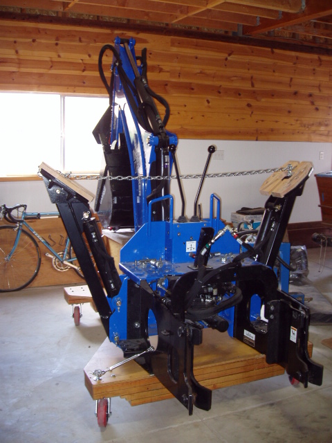

Here is the Woods BH90-X this afternoon-first time off the NH TC40 and ON THE DOLLY!

That dolly looks GREAT. Both functional and attractive. I'm studying your pics and have a couple questions for you if you don't mind:
- The two triangular shaped openings of the hourglass shape, is that for convenient step in access? Or did you have triangular pieces of scrap to work with? Or?
- Did you make the basic frame out of a 2x6 lumber?
- Looks like you glued (bolted?) a couple of metal wear pads on the front for the BH frame to sit on, correct?
- You've got a ship steering wheel looking thing under the bucket rest . . . form or function?
- Anything else besides the chain on the stabilizers and the two tie downs to help it hold the position?
- Have you find the heighth about right (I'm guessing about 10 inches off the floor?) for putting the BH both on and off?
Congrats, marvelous job. IF you have any add'l specs I'd love to see them. This will be a winter project for me.

The two triangular pieces of 3/4" ac ply:
The width of the front 2x8 cross beam is greater than 48" so I had to lay the ply lengthwise thus only covering 48" of the 2x6 center beam. I did shape the ply for maximum step in access, stabilizer arm clearence and structural shear.
Basic frame:
2x8 laminated fore and aft cross beams/2x6 laminated center beam.
Metal wear pads:
The Woods manual says to tilt the bh using the boom and bucket to realease the lower two pins from the subframe. I inlayed on the edge of the dolly two 3"x3"x1/4" Simpson Strongtie anchor bolt washers bedded with Gorilla glue to keep from chewing up the plywood while tilting the bh.
The dory wheel:
Friends would drop by and comment on the progress of the batmobile, soap box derby racer, stealth craft, etc. so to humor them.......
Hold it in position:
The chain on the two stabilizers is to hold them in the full up position in case of any hydraulic leakage as the whole idea of the dolly is to move the bh into a tight space when not in use. The bh will be four corner chained but probably not really necessary as the unit is three point steady as it is. Just some cheap insurance/California earthquakes, tractor bump, etc. I used one of the wheel bolt holes to anchor the 1/2" forged eye hooks onto the platform.
Platform height:
With 6" wheels, the top of the deck is 11". Depending on your tractor's tire sizes, you may or may not need to run the tractor up on blocks (I had to) to get the dolly under the bh. DO NOT use smaller dolly wheels. What I did not try but probably will the next time is to make better use of the stabilizers in lifting the tractor further up (without the tire blocks) for dolly clearence.
