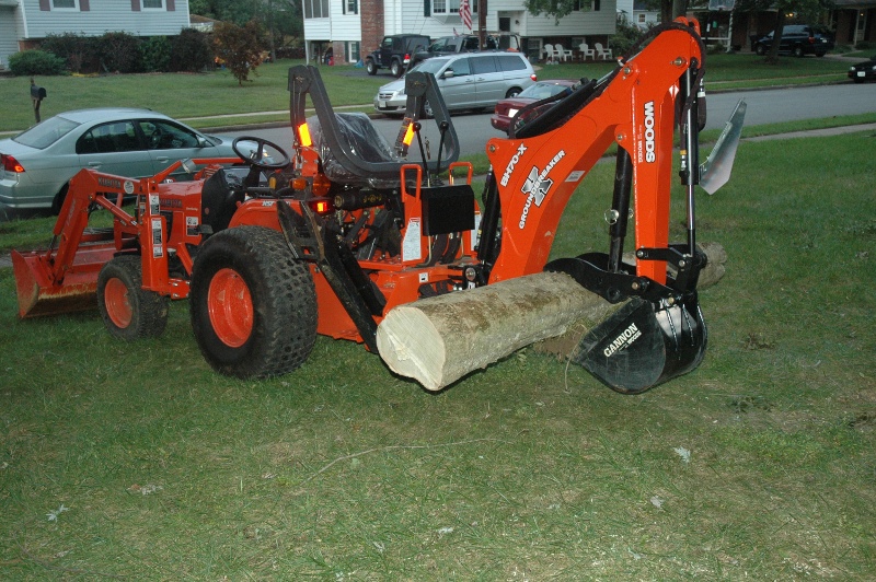

   / Woods BH90-X Hyd Thumb pics #53
Has anyone with a mechanical thumb thought of converting it to hydraulic? I was discussing this with another TBN member a couple of weeks ago and it seems it would be a pretty simple operation. No welding as you would use the mounts already in place for the mechanical thumb and you'd obviously reuse the mechanical thumb itself. You'd just need to replace the mechanical lengthening rod with a hydraulic cylinder ($100-150) and then run hydraulic hoses ($100-200) back to a simple two way valve ($50-100) on the operator station and either power it from an extra remote ($0) or tap into the hydraulics for the stabilizers (which I think is what Woods does in the factory version). There would be some labor and hassle but it seems the conversion could be made for less than $500 which is way cheaper than the premium charged by Woods. The only difference is that Woods has a nifty foot operated control which could be hard to source so you'd need to use a simple hand operated valve.

   / Woods BH90-X Hyd Thumb pics #55
Not to rain on your parade, ISLAND, but consider that a mechanical thumb's
three pivots are not likely to be set up for continuous (greasable) pivoting
duty. Second, the long stroke required of a hyd cylinder to put the thumb
in fully retracted position as well as fully extended position may require
a different boom bracket.
I dealt with both issues when I went from mechanical fixed, to mechanical
articulated, to hydraulic. I WAS able to use the same thumb, but the pivots
and brackets were all different. You can still view my thread.
   / Woods BH90-X Hyd Thumb pics #57
Actually, Island is right. The pins for the mechanical thumb pivots have the through-bolt already, so it would be a matter of having the grease fittings on the hydraulic cylinder ends. My hoe is buried right now, so I can't run right to it with a tape measure......... but at one time I even measured the other cylinders on the hoe and IIRC one of them is already the correct length. I think its the bucket cylinder...... but it may have been the dipper cylinder. I have thought about this many times, but have yet to act on it at all. I hadn't figured out which way I'd operate the thumb cylinder yet.

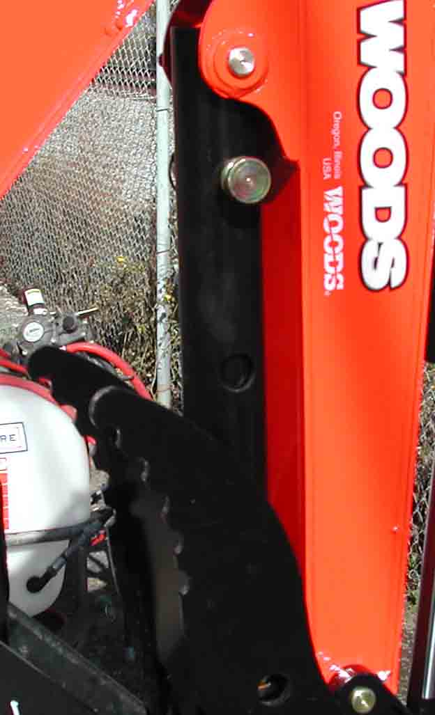

It is not the pins I am talking about, it is the bushings.
This is a photo of a BH80X, and I see it DOES use bushings, even though
there is no hyd thumb option for this model. That is good, even though
it looks like they use only a 3/4" pin. Adding a pin anti-spin feature is not
hard.
As for greasing, putting zerks on your cyl cross tubes is fine. I does look like
you should be able to convert this to hyd with your own cyl, and not have
to deal with Woods.
