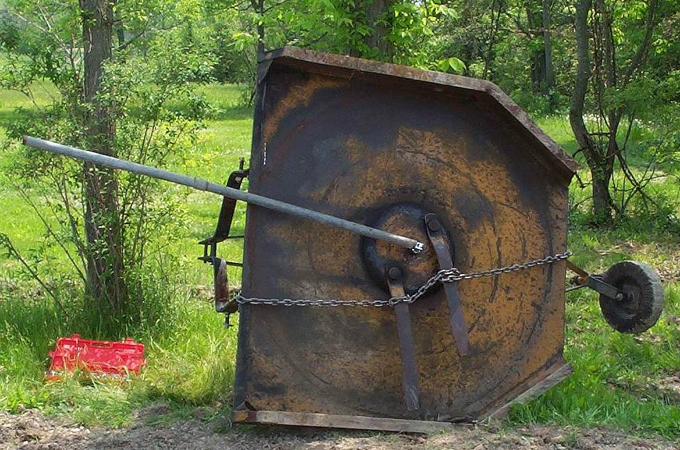

I wouldn't use any adjustable wrench to remove a nut/bolt fastener set @ over 300 ft. lbs. +++ of torque... you'd strip the fastener or slip and whack/hurt yourself bad... /w3tcompact/icons/blush.gif
But, I certainly agree <A target="_blank" HREF=http://www.tractorbynet.com/forumfiles/5-217604-BreakerbarforBrushhogbolts-reduced.jpg>on the breaker bar to turn an average man... into superman... </A>/w3tcompact/icons/wink.gif

   / Woods Brushbull Blades #15
John, I see a box that looks an awful lot like my "China" set sitting off to the side in your photo. I think mine actually say they're made by MIT or MET or something like that, but are all stamped CHINA. Not sure if mine would handle a bar that size. /w3tcompact/icons/shocked.gif Are your's the same or of higher quality. That has to be the biggest bar I've ever seen someone use. Hope it was someone pretty small pushing on it. (no slight intended to our littler people)

Yes sir, that is high quality $39. Harbor Freight 3/4" special... with I believe a Craftsman socket on the end...(don't hold me to the Craftsman though...)
I had to buy a 1 11/16" socket from Craftsman, 'cause the set "jumps" over that size... I have since gotten some "Made in Japan" sockets that are fantastic!
(I told one of my best buddies, they are as nice as his Snap-on's... then he wanted to "beat me up"... /w3tcompact/icons/laugh.gif)
