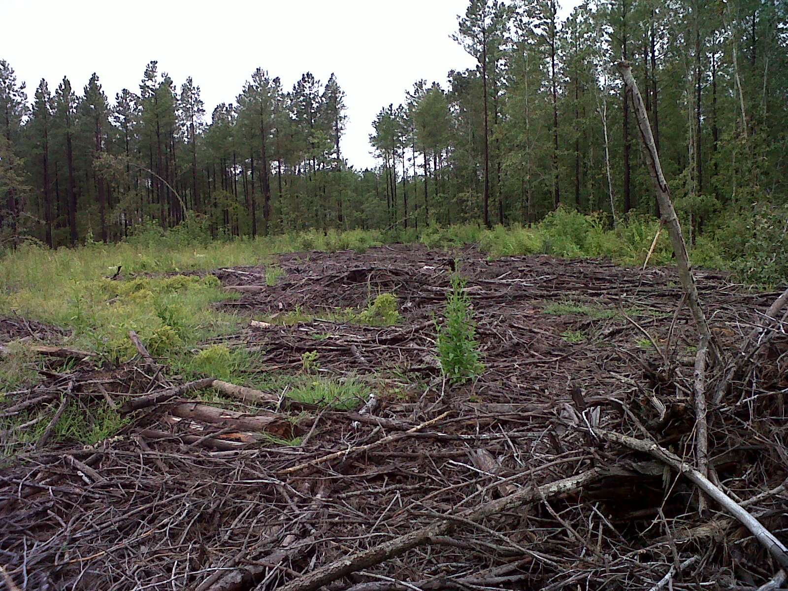

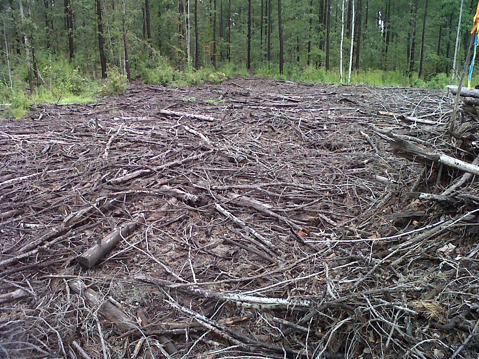

MossflowerWoods said:
That is VERY interesting!!!
It looks like you push in flat, the bottom rakes/rips and the top edge cuts thicker materials.
Then you tilt the bucket down and backdrag both edges to clear.
Right?
Thanks again.
This is some of what I am clearing...
David
You have the correct procedure. If you start using it, you will quickly develop what works best. It's also great for ripping out vines and briars that crawl up trees.

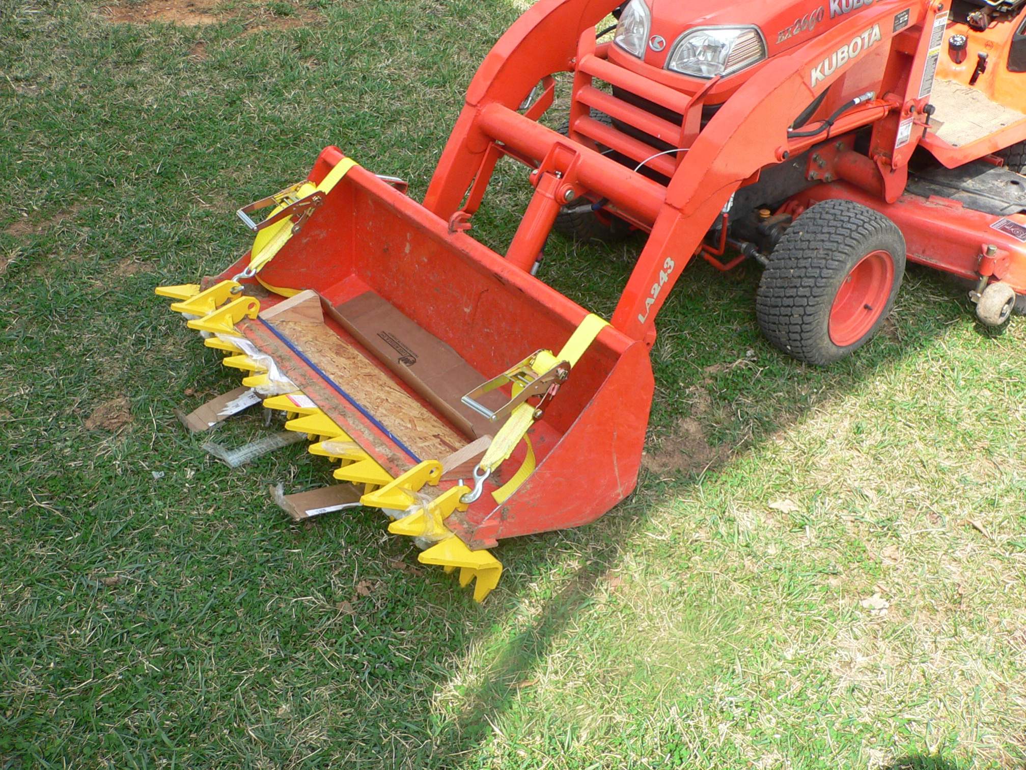

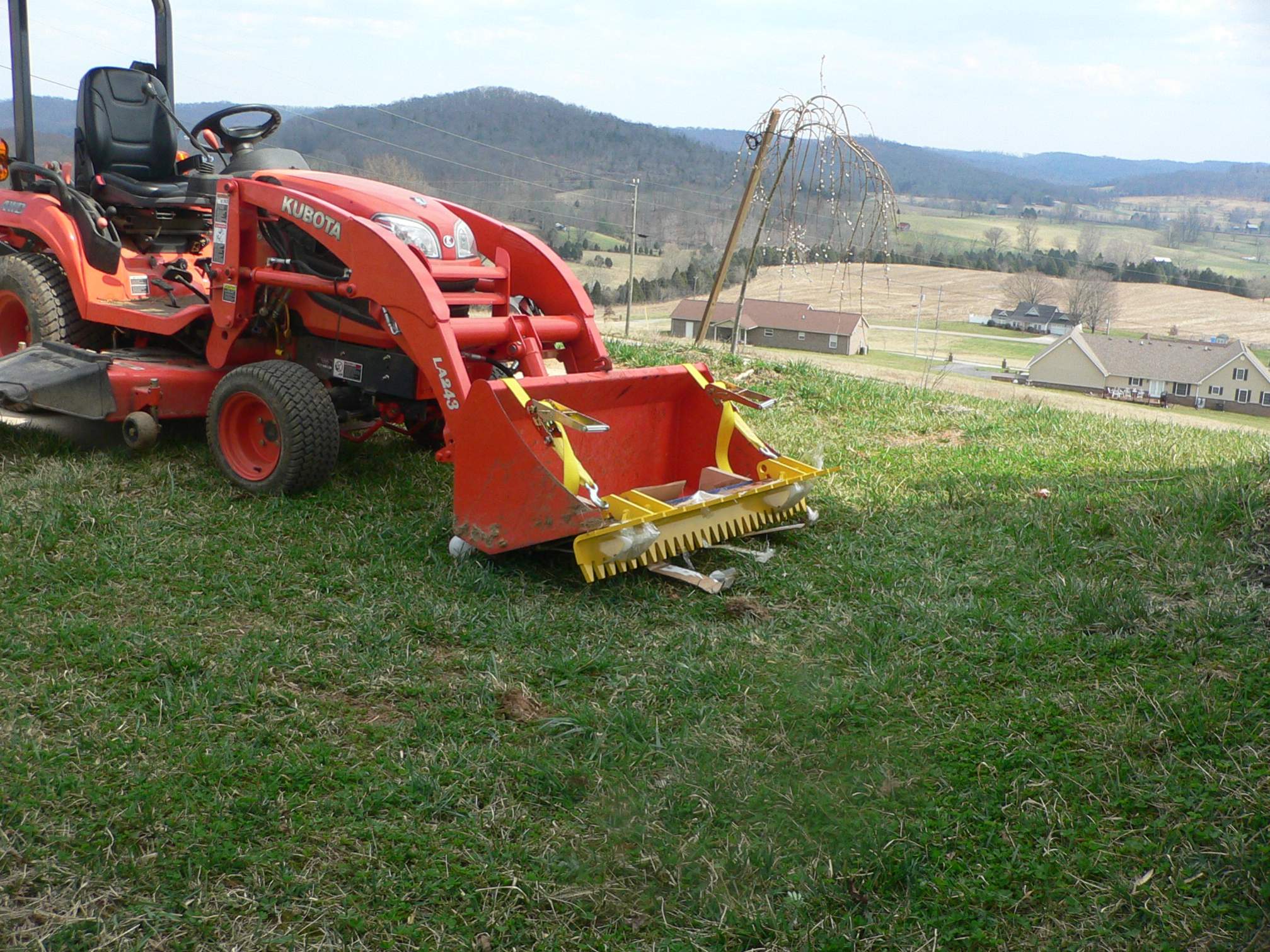

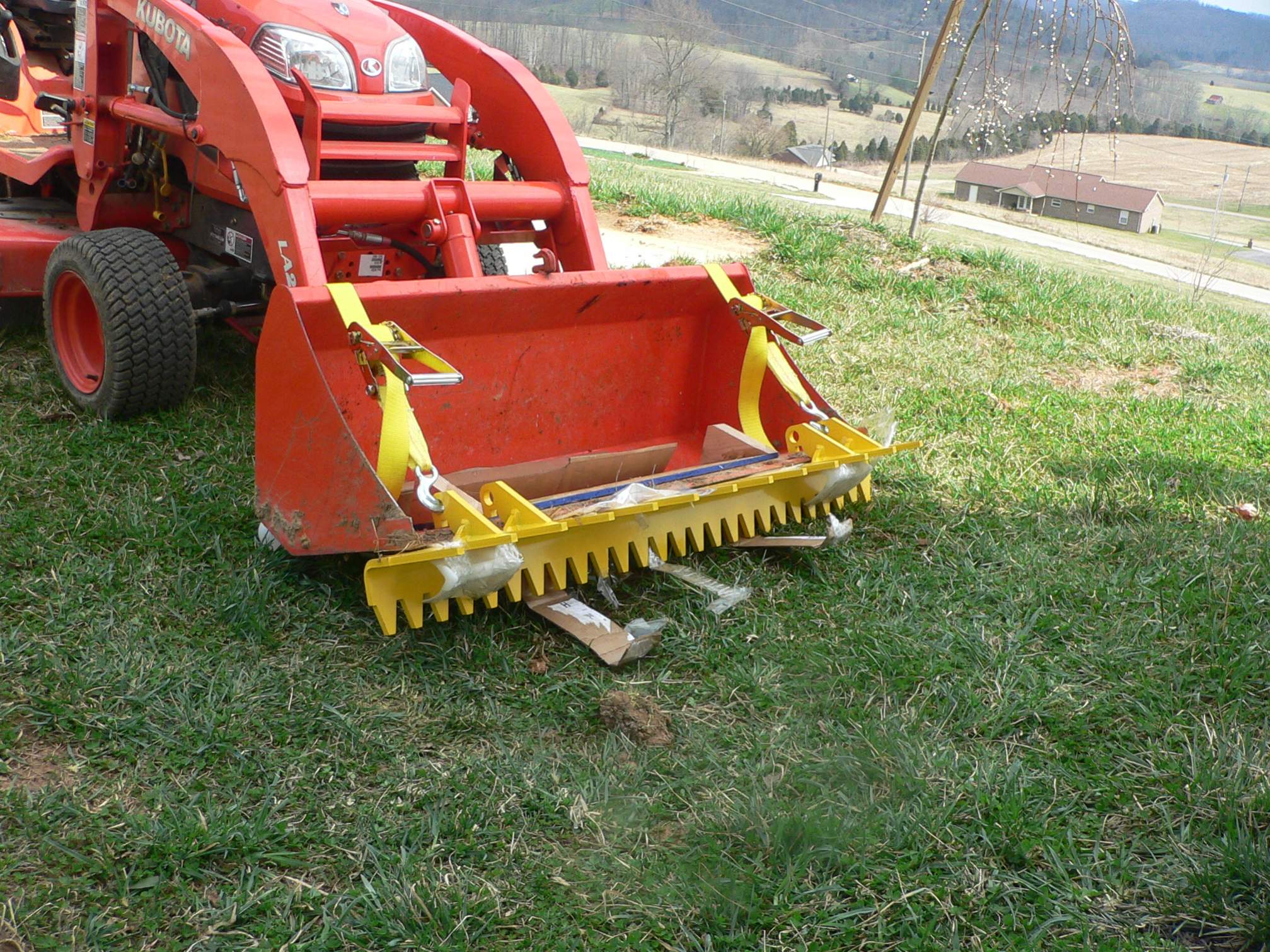

Finally found pictures of RatchetRake on my BX.
This is when I had it on the BX2660 before the BX25.

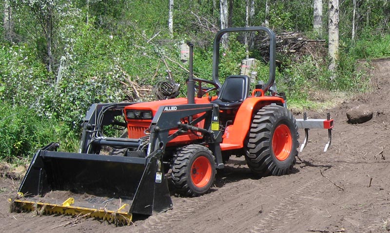

This is my setup for my B8200. I had to mount the Ratchet Rake with (4) 1/2" grade 8 bolts so I could still use my 4-in-1 but it only takes a few minutes to take it off.
If the RR doesn't get it the rippers in the back do. :)

Wow thanks for the pics gonna stop by tractor supply this weekend and check them out!!
