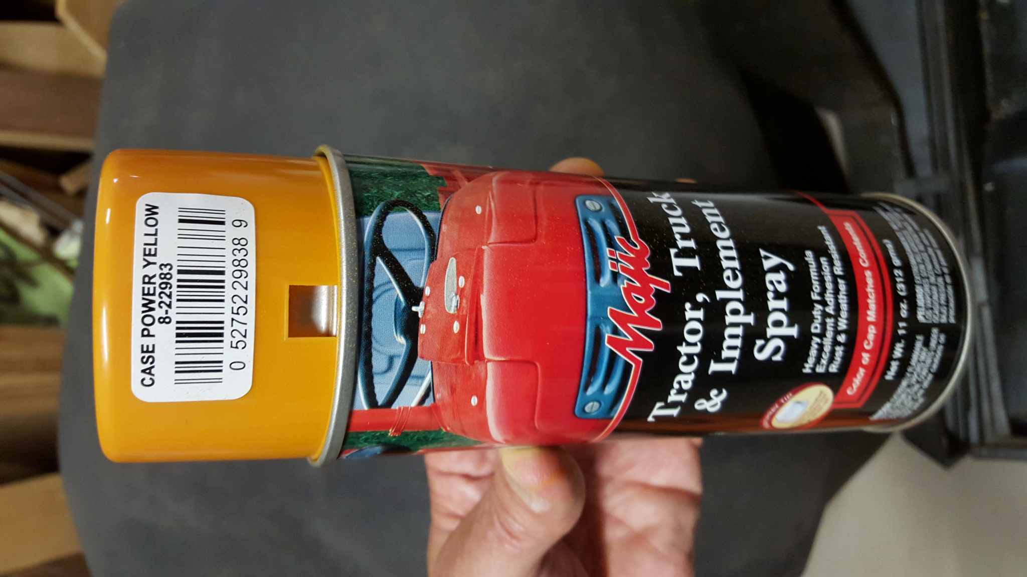

I recently needed to prime and repaint some areas on a Woods HBL84-2 rear blade. Rather than having Woods OEM paint shipped in, I found a very good match in rattle cans at TSC. I'm posting this in case others have a similar need. It's Case Power Yellow 8-22983 by Majic. See pic.

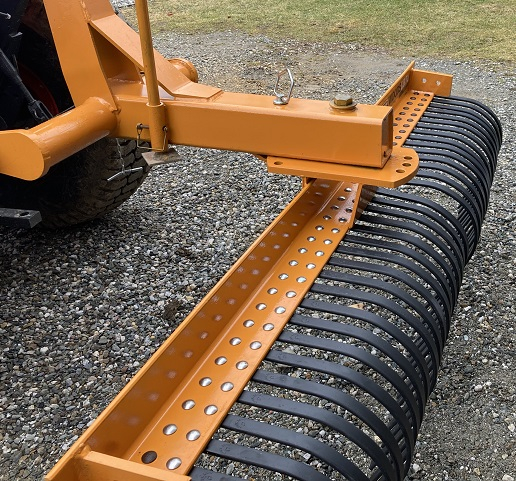

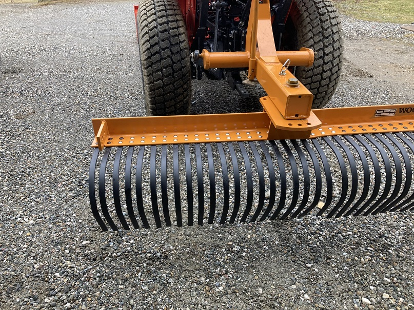

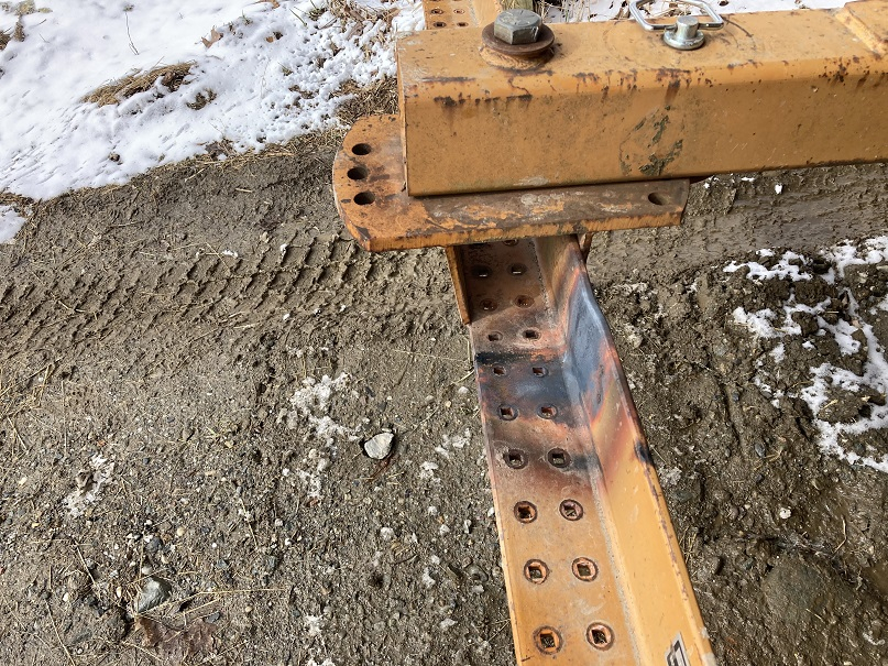

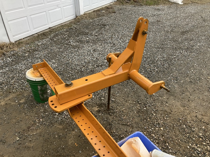

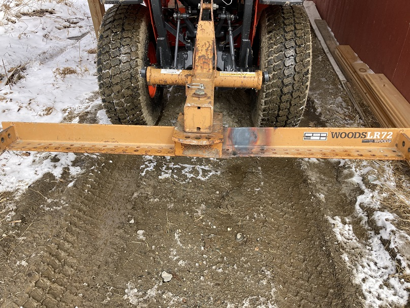

This was a great match for my 30 yr old Woods LR72 york rake. Its been modified over the years and of course bent two ways, but functional. Tines had worn from 27 to 24 inches. Welder fixed the bent angle ($700 new) assembly horizontally, but not vertically for $80, which is a small issue when installing new tines. New tines $300 for 36. Bolts, $75. For less than $500, it will most likely outlive me if I m more careful with wheel supports removed.
