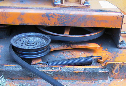

Can you post a picture of the idler and arm & its attaching hardware... I have seen that deck but do not remember just how it attaches...

I will take a picture, but it will take a couple of days. The mowing deck in a pasture some distance away from my home. Today, I decided to bend the arm to see if I could get the idler wheel aligned. The lever does not bend, but it does break. So, the picture will show that damage.

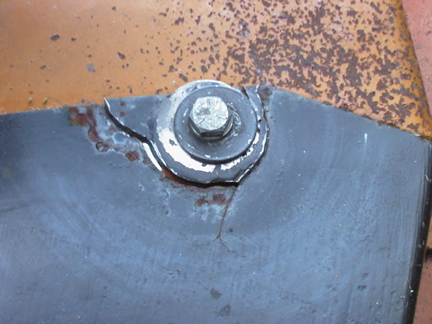

When you say "belt shield", do you mean the black covers on either side that go over the entire belt drive system?

I do mean the black covers on either side that go over the entire belt drive system. Here is a picture of what the vibration has done them.

Here is the picture that you requested.
attachment.php
Yes, the arm is broken. A replacement is on order. Breaking the arm is a result of my trying to fix the problem -- not the problem itself.

I am again trying to follow the instructions for uploading a picture. See if this works.
attachment.php
Paul
Paul,
"Here is the picture that you requested."
No picture... Your other picture is there. KennyV
