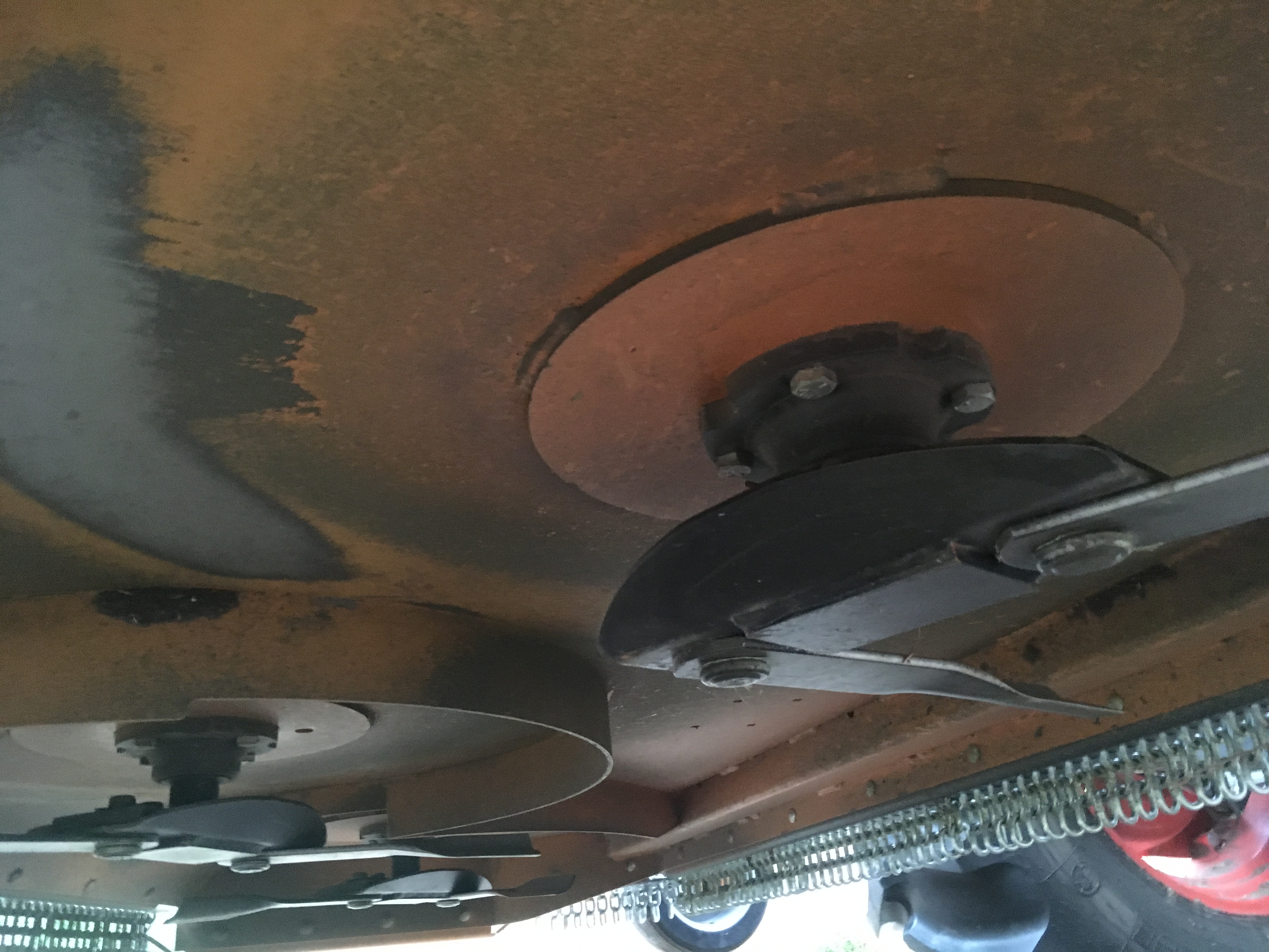

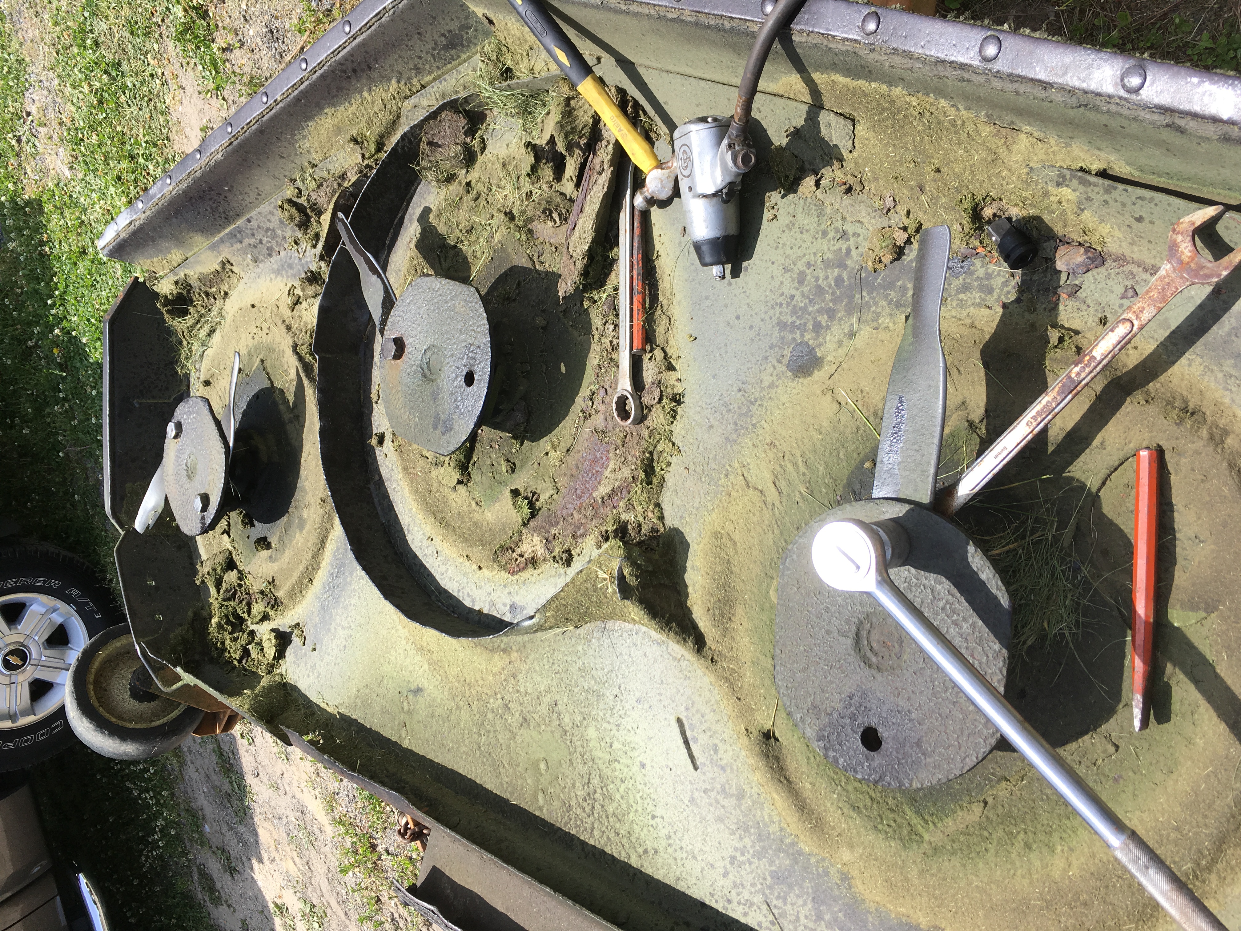

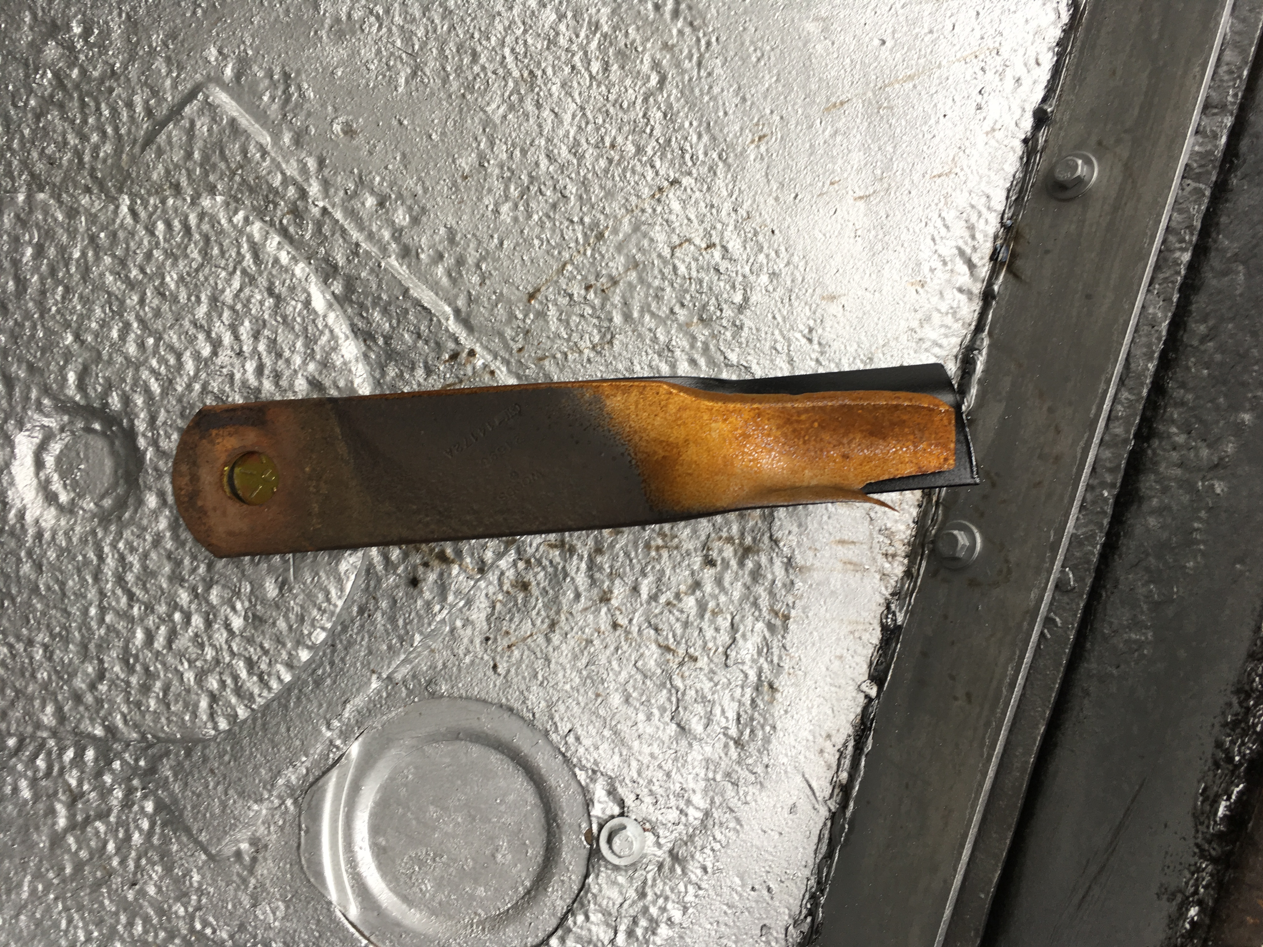

They’re a tough mower. I bought mine used in 05 and it was probably 10 years old then. I’ve put blades on it twice, replaced the seals and bearings in the wheels once, a new Drive belt once, and a year ago added a stiffener plate across the front and welded up a few cracks in the deck. Also painted the underside of the deck. I use it to mow 5 acres weekly. When I bought it the gearbox seal was toast and the previous owner had filled it with grease. I installed a fitting in the plate on top of the gearbox and it gets 50 pumps with the grease gun before every use while greasing the wheels every other use. It’s a great mower and if I ever have to replace it I will get another 990. 6A901E4E-4C40-48E5-AED4-638A8950C5FC.jpeg4CF6745A-AC4C-412C-A820-97746BD75213.jpeg

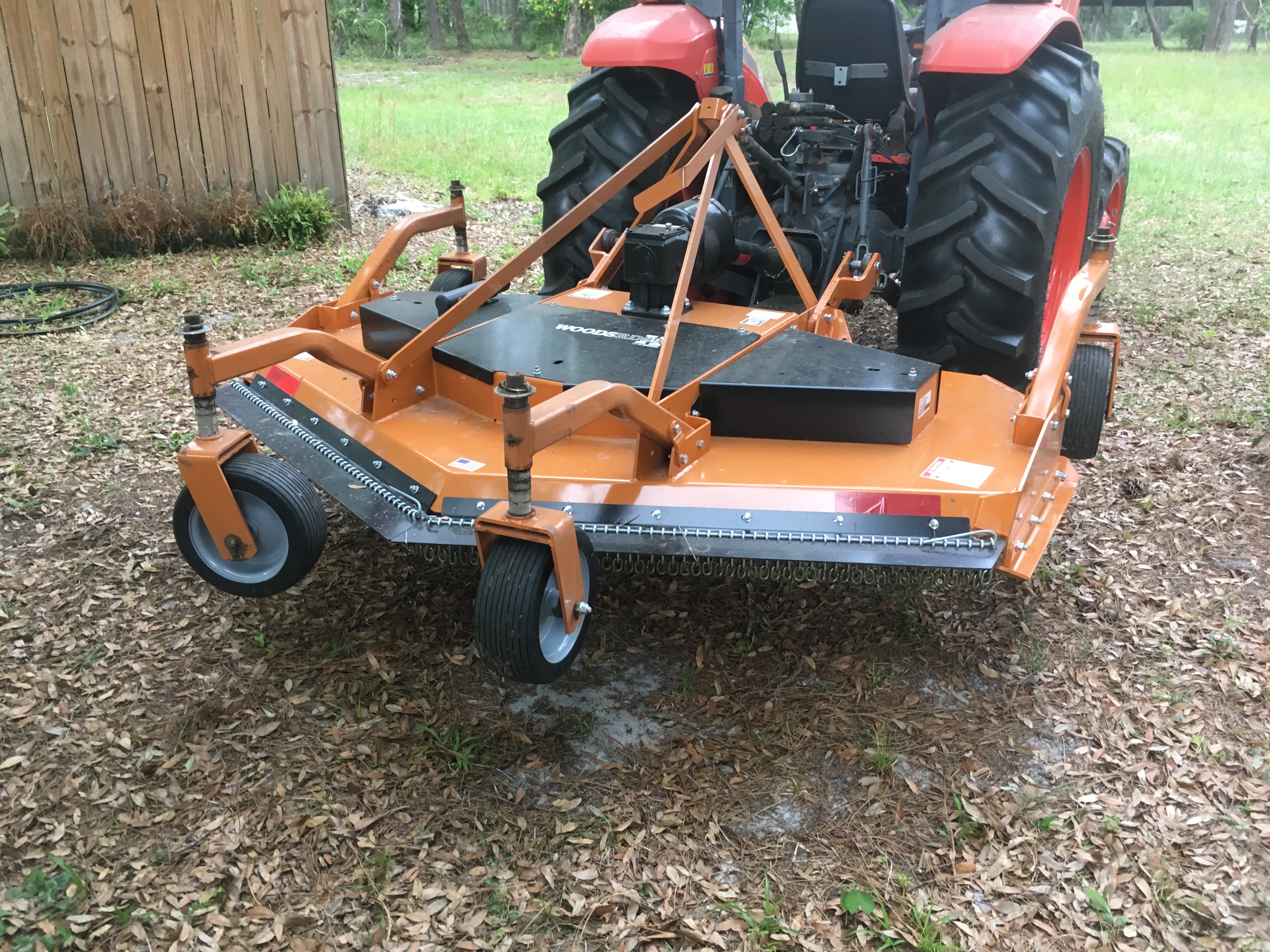

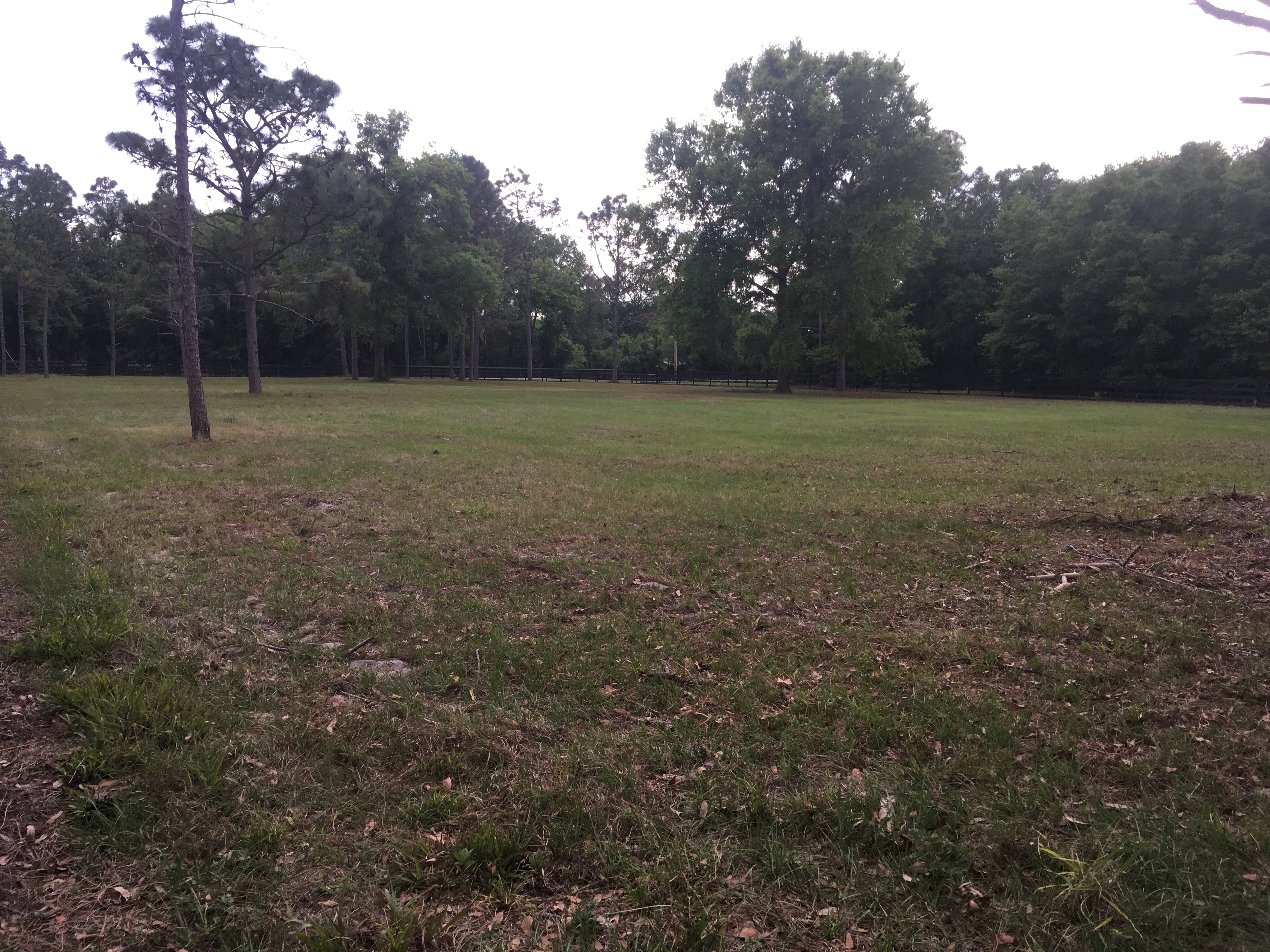

Quick Update on the RD990-X - It is a beefy mower and cuts extremely well. I'm still waiting on the growing season to really get going in central Florida. We've had a dry spring so things aren't really cranking just yet. That being said, I have mowed some light brush and cool season weeds and it has cut very well. The lifting power is unreal. My zero turn struggles to pull up light wispy weeds and this 990 doesn't miss anything. I'm anxious to get it into a realy thick pasture in mid summer to see what it does.
My zero turn is a Toro Titan 54" with 23hp Kawasaki. I mow at 7-8 mph regularly. On the tractor, I'm usually in 4 or 5 out of 8 speeds and averaging 5-7 mpg. I have been able to cut my mowing time by 75%. The 70hp Kubota I'm using uses about 4 times the fuel as the Kawasaki. Since I'm saving so much time my fuel cost is pretty comparable.
I cannot stress enough how stout and well built this mower is. You can see a large 2.5" square rectangular tube running across the front of the mower deck. My 8,000 lbs tractor grunts a little and you can feel it pick up the mower. Here's a few pictures
