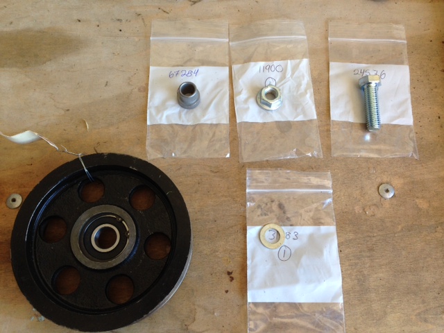

did you order bearing or pully and bearing
I ended up ordering the pully and bearing together as a sellable unit. Thought this would be easier to deal with from an install perspective.

Everything arrived as I had ordered thanks to the wonderful service at Messicks. They have a great selection of Woods parts and the online exploded diagrams are very helpful. Here are the parts I ordered:

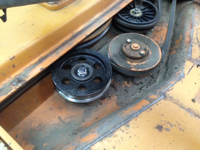

The new idler pully (ordered with the bearing as one piece) installed very nicely and I was able to get the mower working again in no time. I did take the opportunity to do a little clean up as long as I had the covers off.
I still have several weeks left of mowing season, but doing this repair convinced me that I needed to add a couple of "winter" projects to my schedule.
1. Install a compressed air system in my shop with a nice reeled hose near the garage door. This will allow me to easily clean off the mower after every use and hopefully keep the dirt, sand and dust from building up again under the covers. I'm convinced this is what caused the bearing to fail.
2. Since I bought this mower used 3 years ago, I've done very little to it other than keep it greased and the blades sharpened. It's starting to show its age a bit and since I know it is a well built machine with many useful years left, I'm going to do a major maintenance overhaul on it including a very thorough cleaning and new paint job for the covers which are looking pretty rough.
