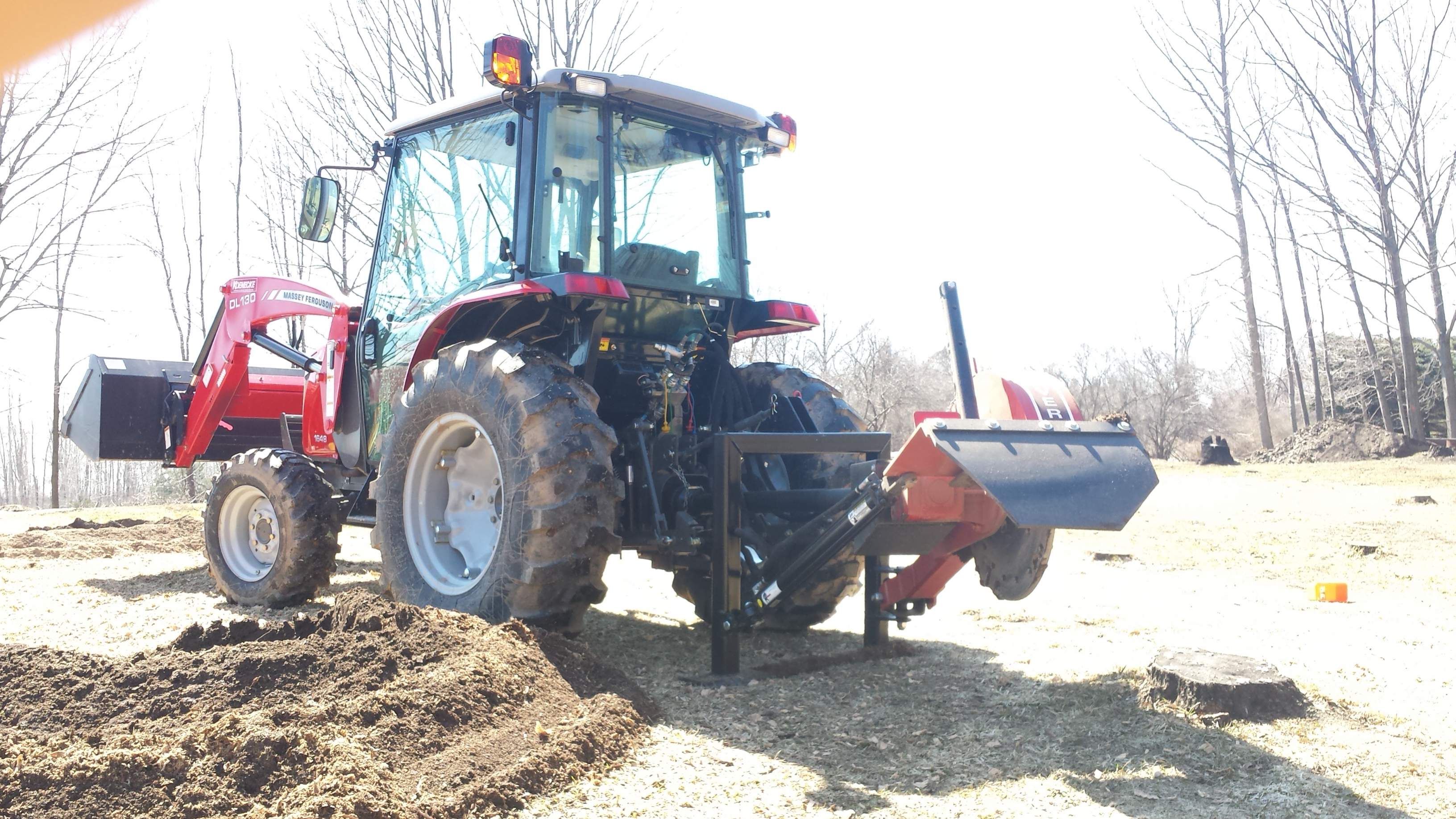

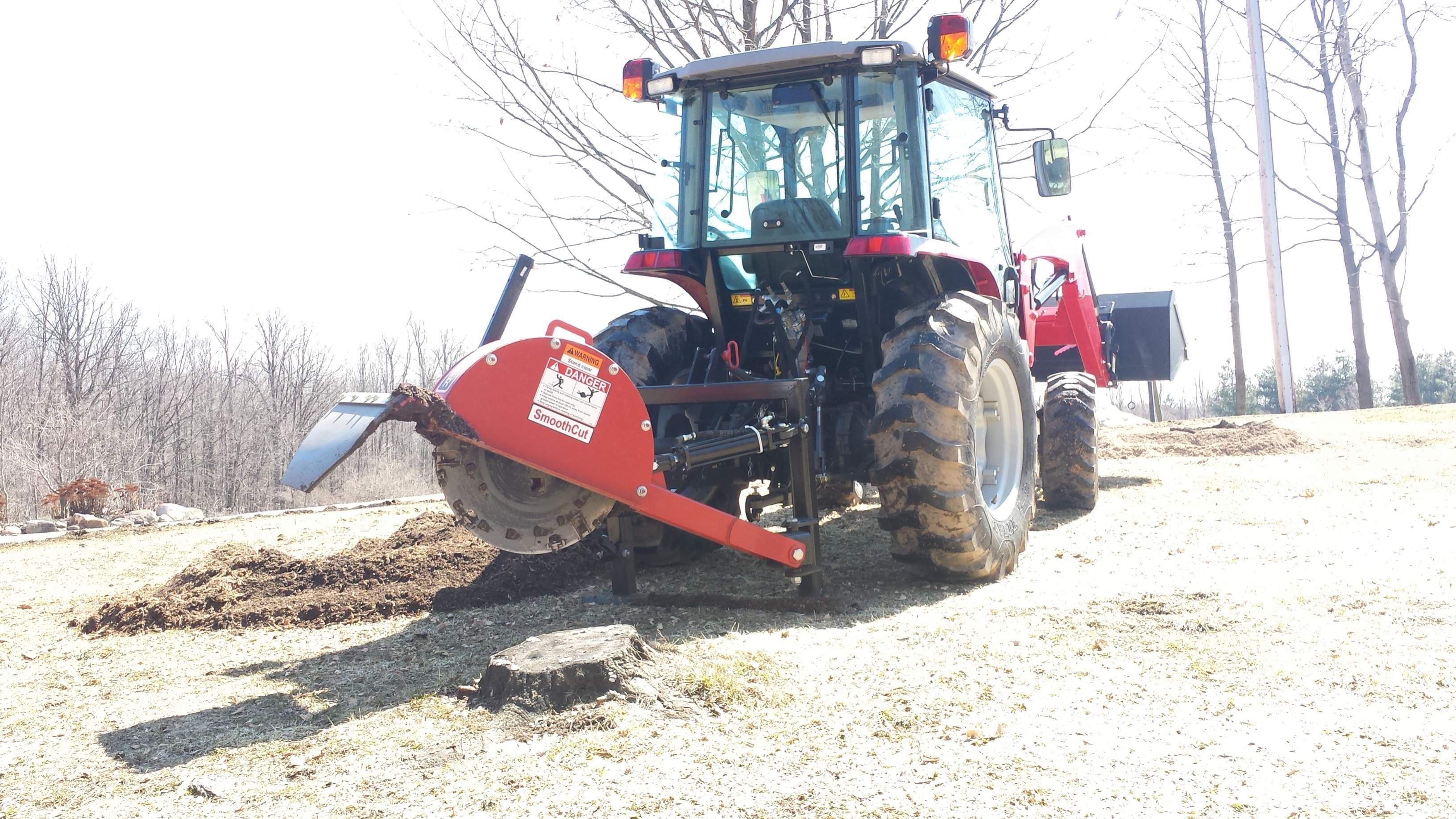

Been some time since I looked at this old thread.
One thing I would recommend is to operate your stump grinder hydraulic cylinders via your loader joystick valve. That would require either removing your loader or using other hydraulic lines to operate the loader. I just used the rear ports and scv valve to operate the lift cylinders and that worked for me.
Operating the stump grinder with the joystick valve is VERY fast and quite intuitive during operation. Works better than a bunch of levers and switches.....IMO.
I likely need to overhaul my grinders joints now. Seems they got loose and sloppy....which makes the grinder jump around too much now. Results in a stalled tractor too often.
I got over 2000 stumps ground from my property with my grinder......so I suppose the joint issue is par for the course.....still.....I wish the joints had held up better.
I still have the original teeth on my unit. The cutting head seems bullet-proof.......I wish I could say the same for the joints.
