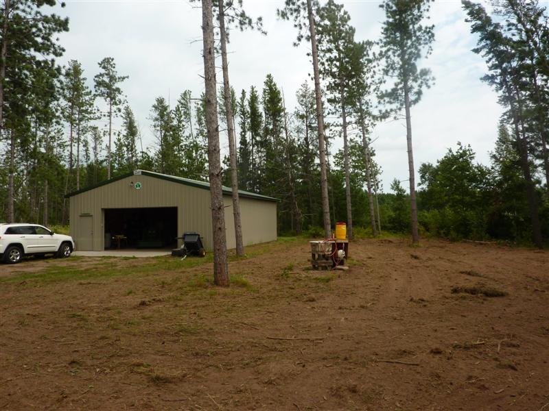

I was just showing a pic of a 1/2 acre area I cleared this summer. It was a nasty tangle of down timber and trees. Took out 30 trees and about 50 stumps (some from logging a few years back). Spread the top soil from my shed and now have a lawn area and a garden area. And....the dead / dying, good-for-nothing, jackpine wont fall on my shed!
Heres a pic.....still some hand-work to do.....but it was a mess in the past. Why dont you rent a grinder for a 1/2 day and see how it goes. I used a rented 25 HP grinder to take out 500 plus stumps before buying my 3 point grinder. Still....if I had rocks.....I dunno.....:confused:
