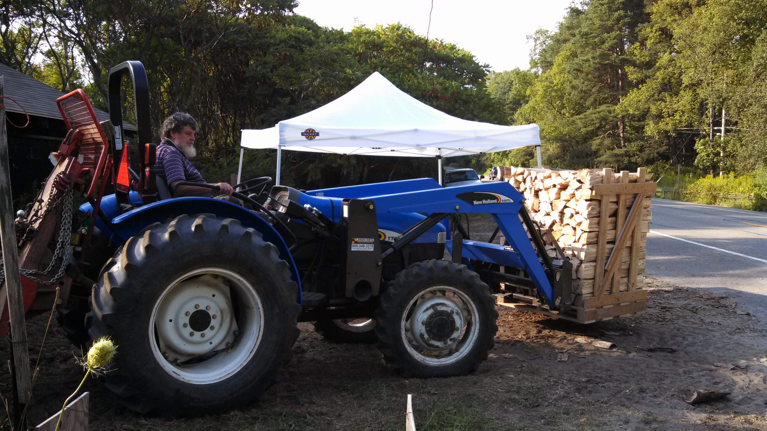

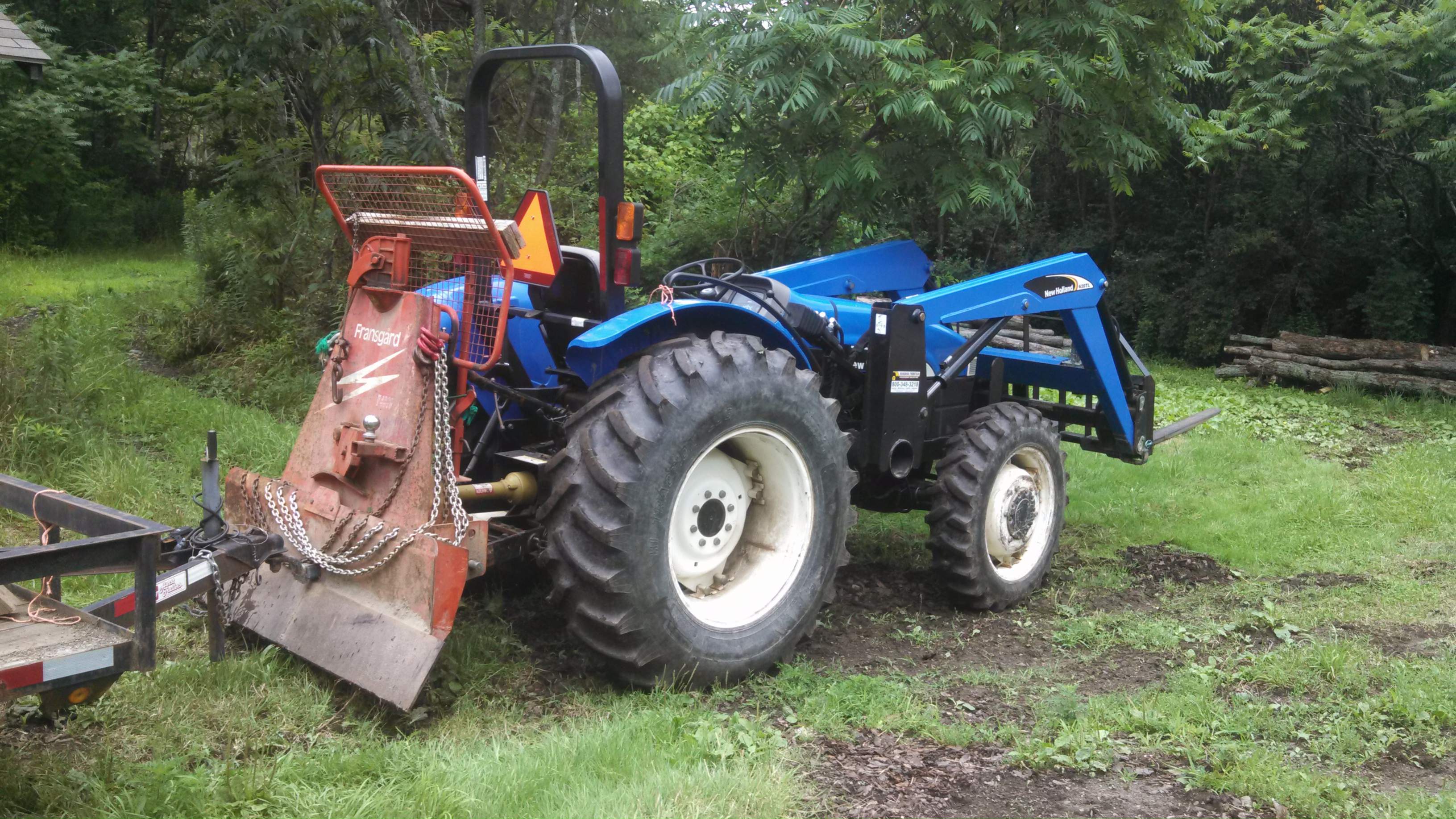

I think I did pretty well on it. I shopped around for quite a while and I was looking at all brands with local dealers, both private sale and dealers. This one was a private sale, I talked the guy down a little. He was looking to buy a compact tractor with a cab.
It is a bare bones utility tractor, though. That model is no longer made but to get into a similar new unit is at least $25,000 and most of the ones I checked out were on a smaller size frame and didn't have the loader capacity or taller front tires I mentioned.
View attachment 358759View attachment 358760
Heres a couple pics, if they show up....
Jbos your pallets look custom made for your size splits
   / Woodslot tractor? 50-70hp #27
Arrow,
yes the pallets I make from rough sawn larch/hemlock. the sides are removable so you can stack them flat on the pallet when empty. They are all made on a jig so they are interchangeable.
90% of the wood I sell is 16" so the pallet is 32" to hold exactly 2 rows deep. The width is 48" and the height is whatever it needed to be to get 42.66 cubic feet, 1/3 cord or "face cord".
