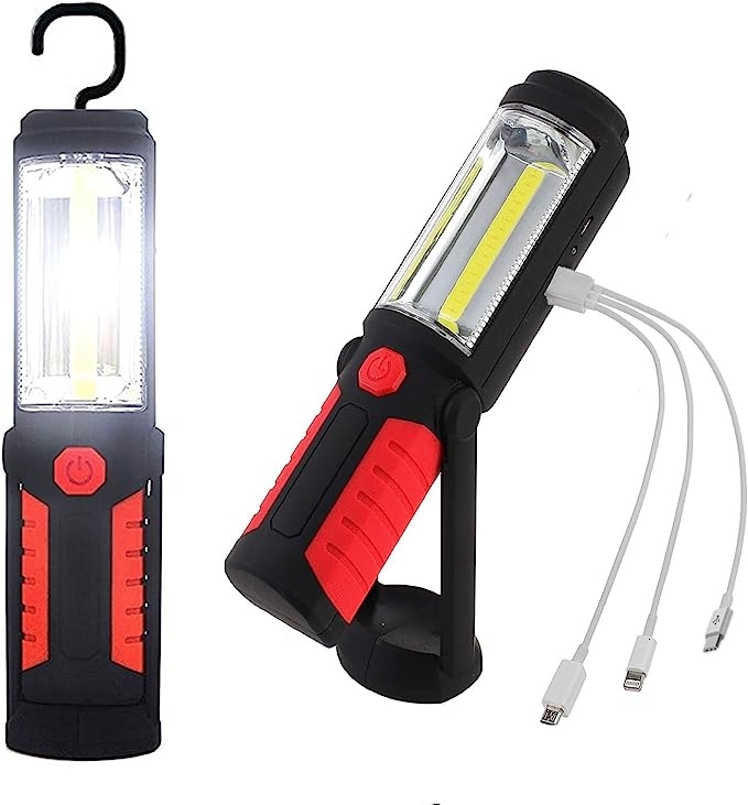

In concept..... But you can always add "work" light as ambient light source..... The brighter your work area the less strain to see weld...
Something like this may be just what you need for more ambient light ...
