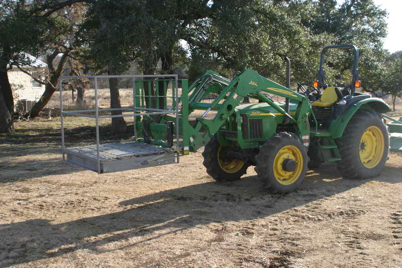

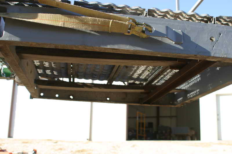

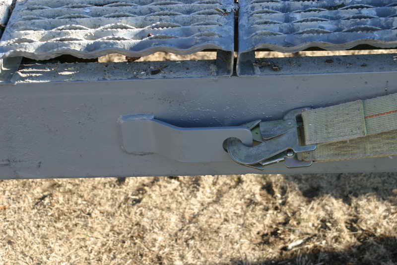

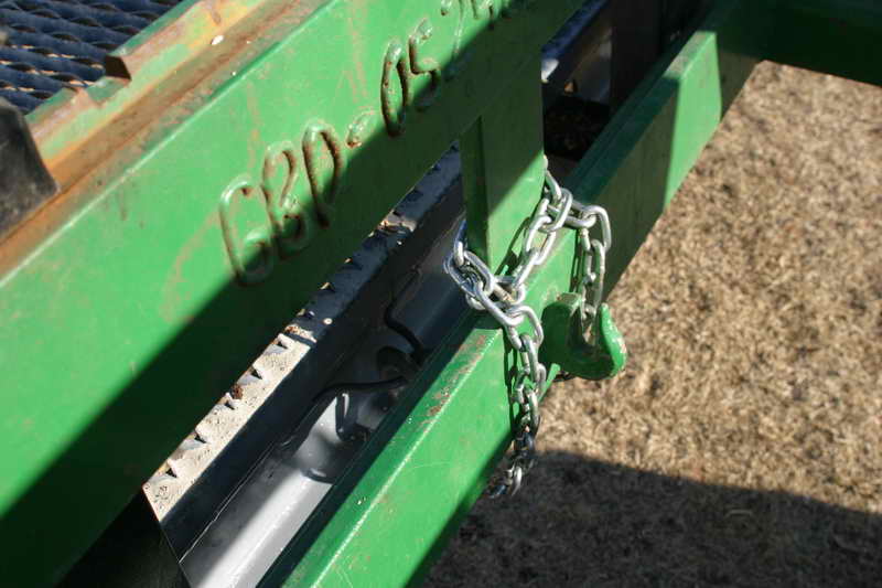

I had this 4'x4' platform lying around that came off a staircase at a concrete plant and I decided to put it to good use. I cut holes to fit my pallet forks, added a railing and called it a work platform. There are anchors welded on each side for straps to hold the platform tight to the pallet forks back carriage and a safety was added chain for back up.

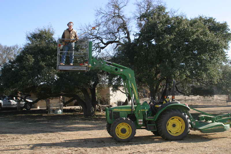

My FEL will lift the bottom of the platform to about 10 feet. Add me and my pole saw and I can now get limbs up to about 20 feet.
I know a FEL isn't design to lift people and I'll take hits from the safety police on this project, but it sure is safer than standing in the bucket while I trim trees.

Looks great gary, I've been wanting to make something like that for my boom pole in my gallery. I like yours be careful and alway have a good operator running the machine

Gary I think you are right about the safety police having a caniption over this. I personally think you did a great job. I spent a lot of years in a steel mill working off of a similar basket to that only attached to a forklift. For everyone that says something bad about your setup I challenge them to point out where a ladder doing the same job is safer. I know the stock one is going to be that a ladder wont fall down if is placed properly. My reply to that is that you can fall off a ladder a lot easier than you can that platform.

The safety police can leave you alone on that one, I have been in the basket on a forklift-many times and none were built as good as that. Tied to the tractor and even has non-skid floor. Great job, thank you for sharing.

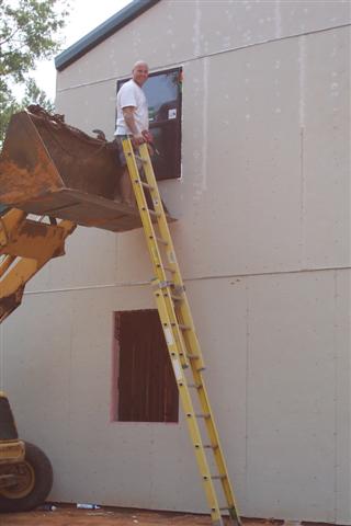

Gary,
Very nice. My problem is that I do most things on my own and the idea of being up there with somebody else driving scares me. Obviously, I don't trust my choices of operators. LOL
My solution is to park the tractor and climb a ladder up to the bucket to have a working platfrom. Could you add a sliding ladder to the side of your platform so that you can work by yourself?

One saftey thought when using it is something that happened to a guy I know. He was trimming some branches on a tree while standing in the FEL. He was either not paying attention, or just didn't see the situation properly. He cut one particular branch that was under tension. It swung around and hit him hard enough to throw him about 20 feet off the FEL. He hit the ground hard and broke several ribs. All he remembers was cutting the branch, then a glimpse of it coming at him. Next thing he knows, he's in the hospital.
Eddie

I'm not the safety police, but I will speculate on the issue.....
The safety issue is a hydraulic leak, busted hose, etc. If a hose or fitting burst while working aloft, you would plummet fast, like gravity. if it was the dump circuit, your bucket would "dump" you.
Installing some pilot-operated check valves at the cylinders and it would remedy that possibility. Any hydraulic manlifts produced for the purpose of lifting a person aloft, must have a proper check valving system.
Always use plenty of rear ballast, too.

I tower climb on occasion and have to get recertified every couple of years. Part of it involves OSHA regs, etc. Jobwise, when you have to use a bucket, you have to be anchored into the bottom of the bucket.
Common sense wise...I think it would be a good idea to strap yourself onto the bottom of your platform. Make sure there is no slack in the line from your waist to the anchor. The guy that Eddie mentioned probably would not have fallen overboard if he was strapped in.
/ Work Platform For FEL #17
Another thing to watch out for is dropping things (branches?) down along the loader arms. Pretty easy for them to slide into the joystick & dump you on the ground.
