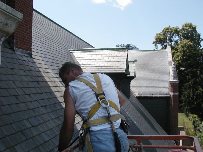

OSHA does not require a velocity fuse in man-up applications. They are built in for safety and the lawyers, but are not a requirement. I would recommend a full body harness. I have the kind that the guys in the church picture have.
