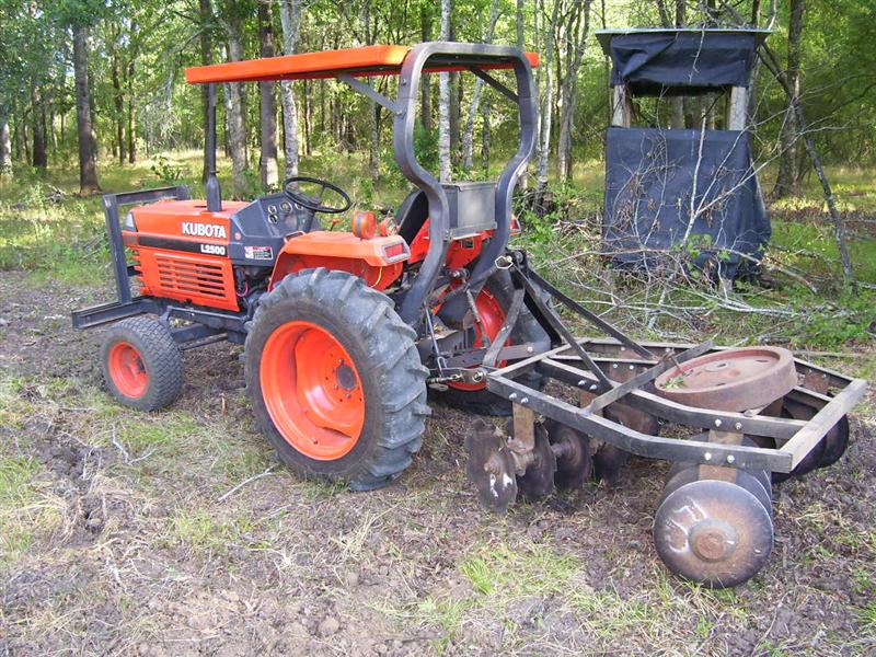

Some pics from Saturday when I was doing mine. The disk is a little 5' 3pt.
First pic is my disk setup, with the weight added in sand it'll bury that tractor.

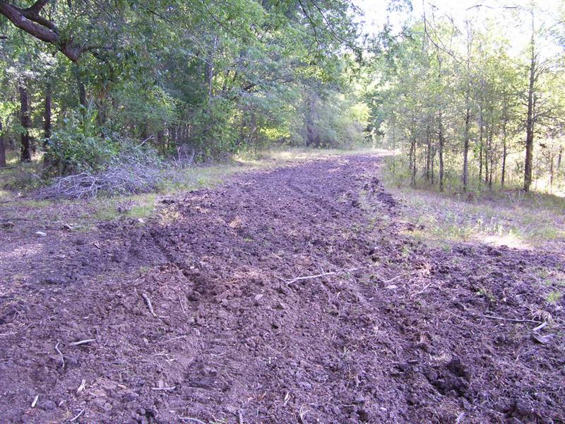

second is some finished disked path, 2 weeks before I ran a sort of homemade 3 shank subsoiler thing. It busted up the black gumbo down to about 4-5 inches. The disk finished the job and cut it up nicely.

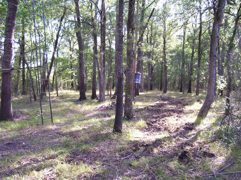

3rd, shot of some never touched wooded gumbo. went over it about 4 times and was good enough to catch some seed. I ran a drag over this to cover the seed.

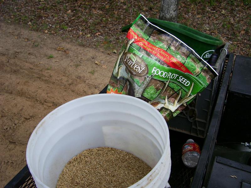

5th...my seed mix and some rye.
