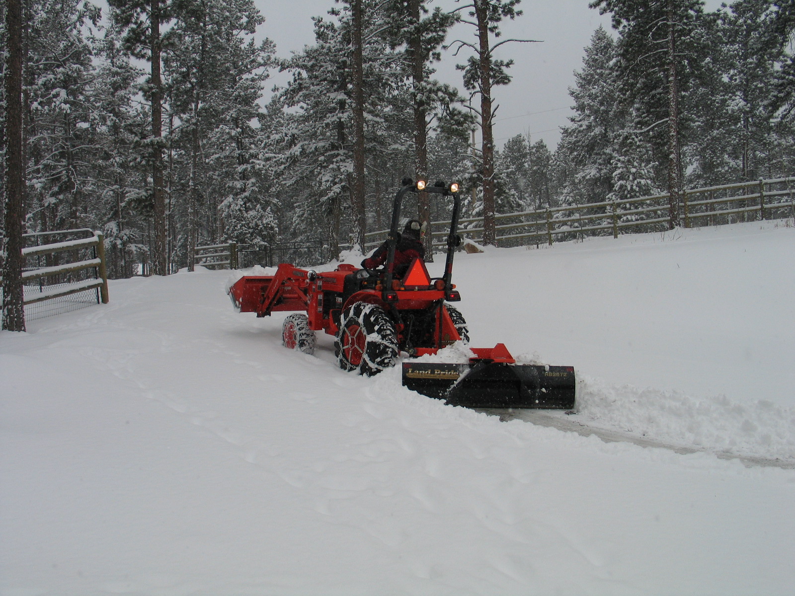

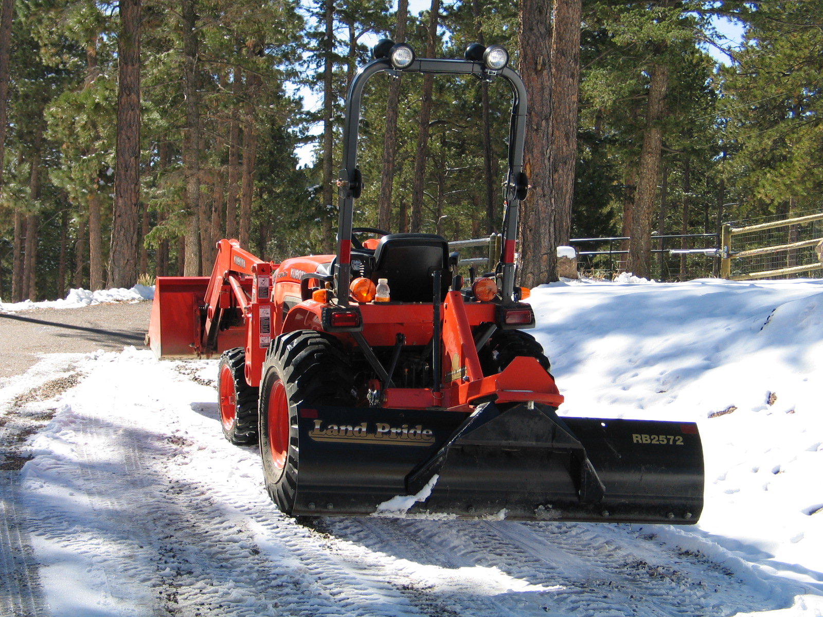

Nice work on mounting the lights Bandit. I like how you put Caplugs in the ends of the tubing, and covers on the threads of your bolts to protect your head from cuts.
Are you going to put the wires in plastic loom? That would finish it off very nicely.
Here are a couple of older pics of the lights wire-loomed (before the FEL plow).
