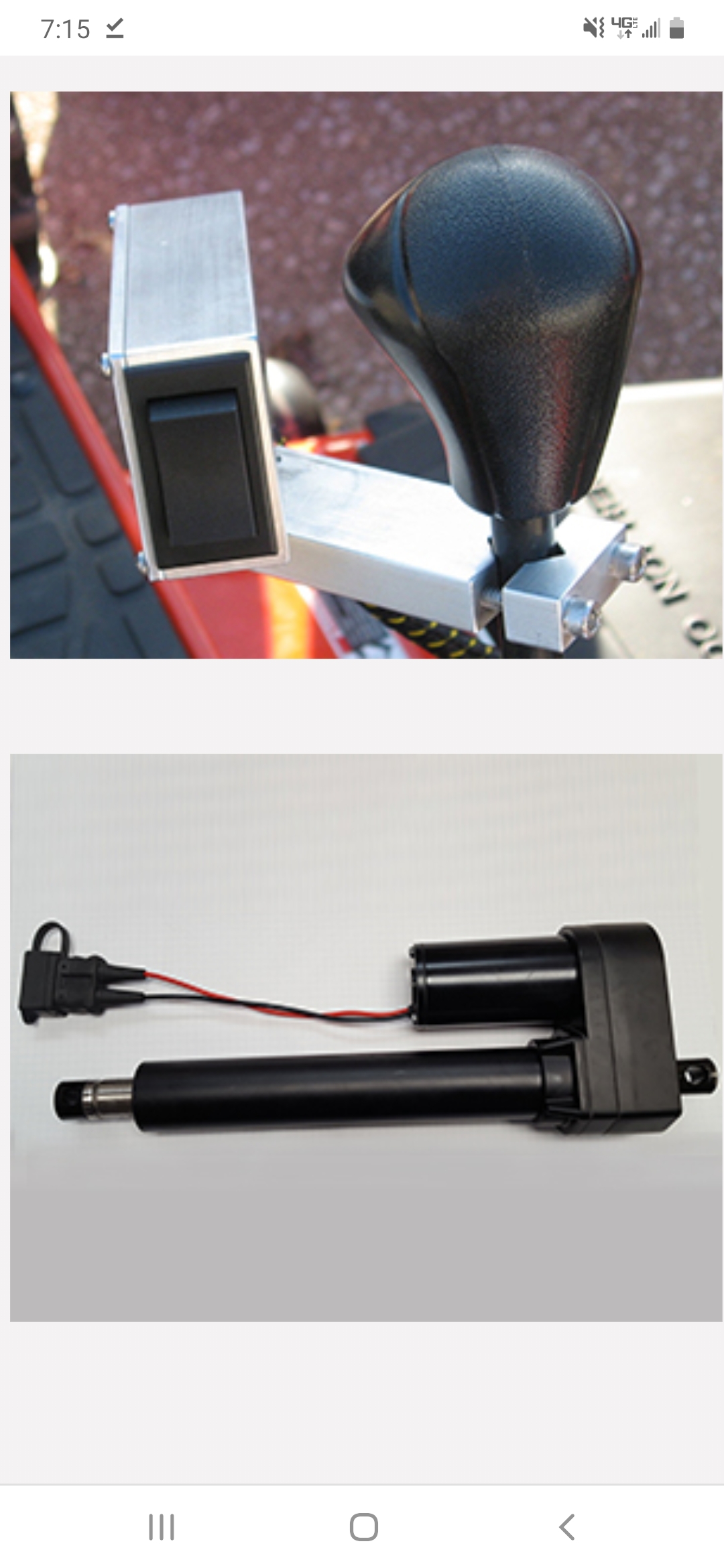

I must say the switch and mount they offer for the loader joystick is about the tackiest I've seen.

They state that "The electric actuator can draw 30 amps" and no where is any written claim of 1000 pounds of force...
I think this grapple needs some operational use with feedback for a while, as they only warranty the electric actuator for 6 months/60 days commercial use.

And consider my SCUT has only small battery (433 CCA) and 40 amp alternator.... Think strenuous use is going to blow out tractors electrical system,... Can see need for bigger battery and maybe upgrade to 100 amp alternator... And at 247 pounds it severely cuts lift capabilities of my GC 1715... And it requires SSQA plate and not any ability be able to added (grapple only) to FEL bucket....
Think a inventive person with some welding skills could make a more practical (FEL mount) unit for a for less...

I have one on my JD3025E and it works great... Lots of down trees to move and old brush! However, the thumb switch is starting to stick, which is likely to wear out the electric actuator... So I turned it in on my warranty to see what they will do.
