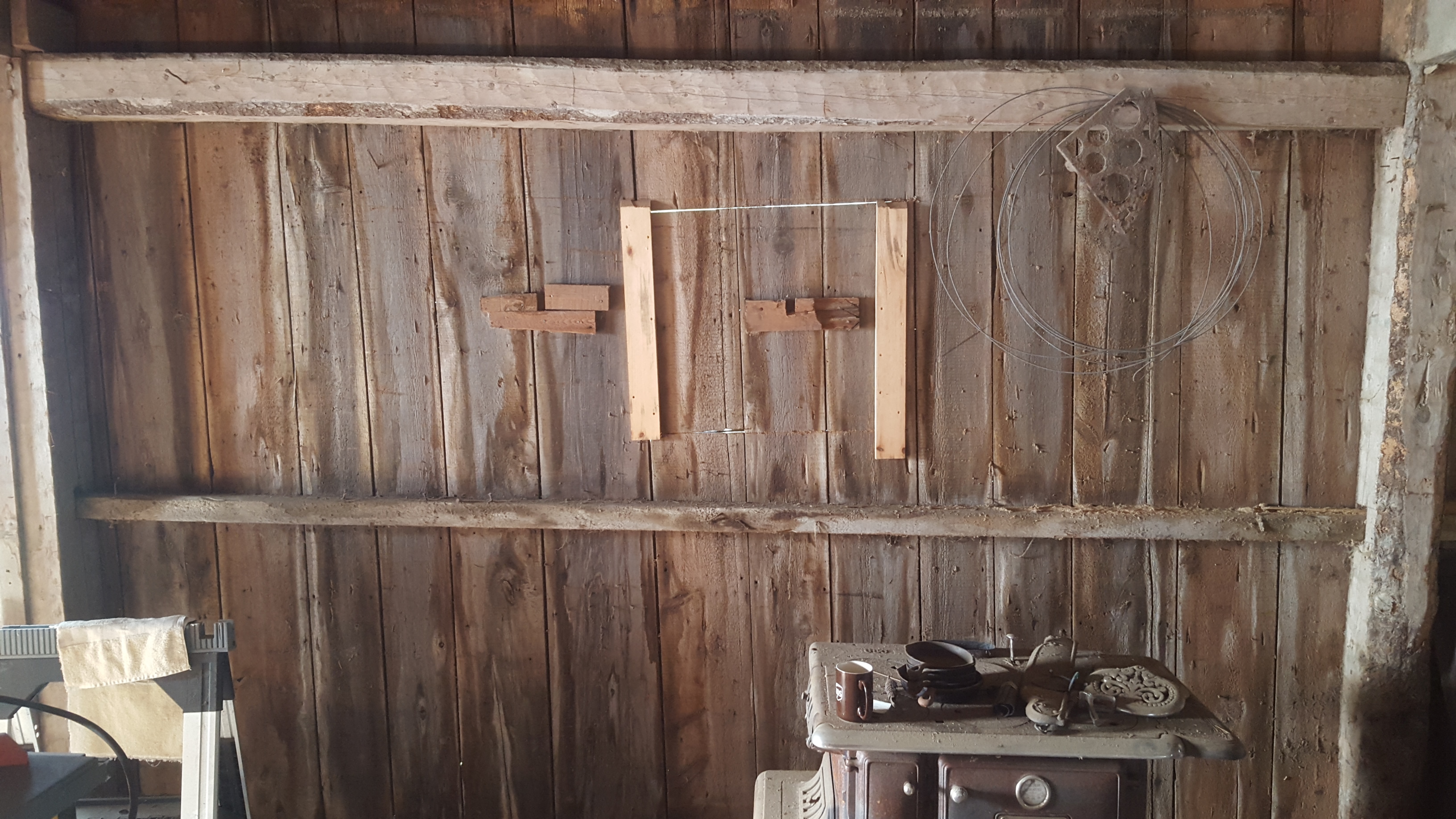

We're enclosing a section of our 150+ year old barn to be a workshop, and we're thinking through insulation. There are two exterior walls to the new workshop that are sheathed in horizontal boards and then sided with shingles. In places there is old (very) tar paper between the sheathing and the shingles. We plan to replace the shingles and may add a WRB at that point, but that won't until next summer at the earliest. We want to insulate now from the inside, and we have access to some reclaimed 4x8 sheets of 1-inch thick rigid yellow polyiso insulation. We plan to panel the interior of the shop with boards.
Thoughts on the installation of the polyiso or other insulation? The interior two walls will also need to be insulated, but those are new walls built between the beams.
Thanks in advance!

WRB :confused3:
/ Workshop Insulation #4
Well, Tyvek is for the outside, but yes I would not go without these days. It's more than just a water barrier. It's an air barrier.
You don't have any wall framing for traditional roll insulation. That leaves only rigid Styrofoam (which has a pretty low R value unless you really increase the thickness) or spray foam. The spray foam would be the best and you could forgo the Tyvek, but all that pretty barn wood would forever be damaged.
I would spray foam it and not worry about it.

If your horizontal exterior backer boards are in good shape and will remain as you update the exterior siding, I guess the trend would be to use sprayed foam...not cheap but the cost is coming down as more people are getting in the business. From what I have read heat loss from a side-wall is not that much if you can eliminate drafts/air infiltration and foam will do that. Biggest heat loss comes from your ceiling I think. There are a lot of people on this site that know a lot more about it than I do so stay tuned for more advice. Interior partition walls...my shop is partitioned between hot and cold with 2x6 framing. I used steel for the interior so my "nailers" run horizontally so as to secure the steel. I spaced the "nailers" 24" OC and used Kraft faced fiberglass on the heated side (readily available in that width). Back side I put up OSB.

Thanks. The VRB will likely be added (on the outside) when we re-shingle the barn next summer (hopefully). For now, I'm really thinking of going with the rigid, as I can get it cheap and double up. If I do that, I'm thinking I should use spacers to create an air gap between the sheathing and the insulation. Thoughts? I have not totally ruled out spray foam (we did that in the attached barn, and it's toasty!), but I'd like to do as little to the barn that compromises any of its historic integrity (we're suckers for that kind of thing).
We used spray foam in the attached barn, and it's awesome. We did ceilings and floor too. It's a pain to then go in and redo and plumbing/electrical though, which is really the only down side (besides the cost and ruining the historic integrity of the structure).

I insulated my pole barn with reclaimed polyiso panels (1.5" and 2" thick). I fitted two layers between the posts, filling gaps/holes with spray foam. Then I put horizontal 2x4 nailers and fitted a final layer. Over that I put 6 mil poly as a vapor barrier and finished the inside with wood paneling and OSB sheets. When I replaced the exterior metal siding, I added tyvek under the metal to finish it off. Seems to be working well. Probably the most significant was adding the metal ceiling (under vapor barrier on the bottom of the trusses with blown in cellulose.
The one thing I would do differently is the electrical. I ran it in the walls and above the ceiling. Now I would run everything in surface mount conduit.
I "paid the guy" to install bright white steel inside my shop and used surface mounted conduit. #1 the EMT qualifies as your ground if properly installed...#2 all wire and connections are readily accessible (I ran 4" boxes around the shop using 2 duplex outlets per box...left side coming from 1 20A breaker, right side from a different 20A breaker). Most likely I have far exceeded the residential code limits but it is a shop and very rarely will one tool be used at the same time. Problem with surface mounting on ribbed steal panels...the ribs stand "proud" about 3/4" so a shim will be required if you don't to make/buy the "offset" fittings. Other than that, my ribbed steel ceiling went up over a thick layer of poly sheeting. Have part of the building that is "cold" and hired an insulation contractor to do "blow-in" to R50 from that side. The builder (no longer with us...RIP) kinda left me a problem in that he installed the ridge vent and ventilated soffits but didn't install any "dams" on the side walls. We installed thick layers of fiberglass batting (R50 in total) around the perimeter and filled the middle with blown in material. When I built it I insisted on radiant in-floor heat that my wife and I installed before the slab got poured. It's hardly cheap to heat as it is but nothing in Wisconsin is cheap to heat and I love the radiant in-floor heat.

Thanks. Would you recap for me the progression you did from interior wood paneling out to siding, please?

We do plan to insulate all shop walls and the ceiling, but I'm not sure what to do about the floor (the barn sits on fieldstone piers with just a tight crawlspace). I'm thinking we'll have plenty of "refreshing air" coming up from the floor.
Floors/crawlspaces can be problematic and there doesn't seem to be any consensus amongst the insulation guys...some say an air gap is needed, others say "pack it full". Wait and see if an expert opines.
