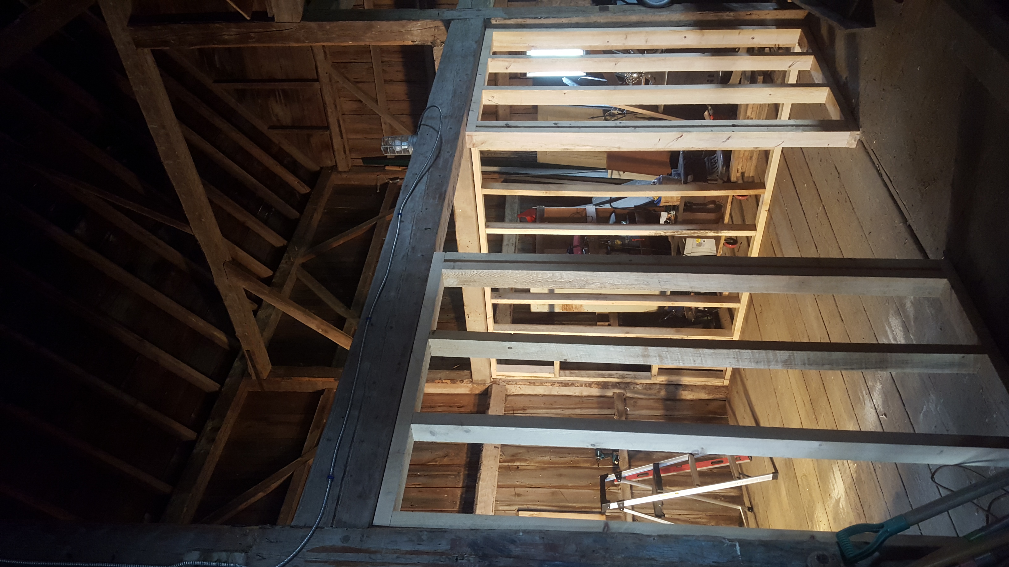

Thanks all! All of this is very helpful. Our three new interior walls are built, and I went the Big Box to get a 250' of 12-2 wire so I can rough in the electric. I noticed they were having a sale on fiberglass insulation, and I was thinking of putting R-13 or R15 in the three interior walls. My studs are rough cut hemlock at an honest 4". I plan to panel the aisle side of the barn with reclaimed barn wood to maintain the character. Thoughts? We have not yet decided how to cover the shop side of the wall or how to insulate the exterior walls.

The old rule was R19 is used on 5.5" material (2x6), R11 on typical 3.5" (2x4). I guess the insulation guys have figured out how to increase the R value on each (R21/R13) With a true 2x4 I guess R15 might work. You haven't mentioned your heating supply yet.

We want to insulate now from the inside, and we have access to some reclaimed 4x8 sheets of 1-inch thick rigid yellow polyiso insulation. We plan to panel the interior of the shop with boards.
Thoughts on the installation of the polyiso or other insulation? The interior two walls will also need to be insulated, but those are new walls built between the beams.
Thanks in advance!
That rigid polly-iso is equal to spray foam, (per inch) good stuff. Cut & fit tightly and use "can foam" to seal the edges & any joints. I used 2 layers of 1.5" and had enough room left for 3.5" of f/g. I would use 2 layers at the exteror walls to put your dew point in the insulation to avoid moisture issues.

So 3" of Pollyiso with R-13 for the exterior walls?
