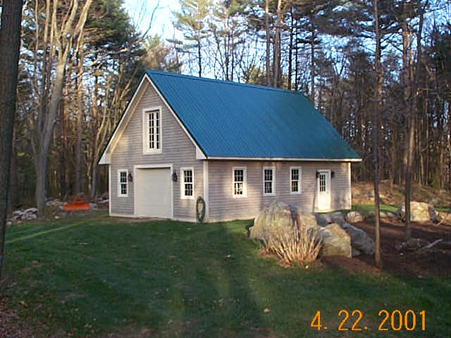

As mentioned above a second story can add a lot of storage space, also for an office, etc..
Regarding the 25' width - this is not 4' O/C also if you add a second floor rafters and materials will be non std length.
I have a 24x36 for shop, TLB storage, and such. I put one door on the back left side and the other in the front gable end with floor trusses and second floor - so no interior posts- makes for a lot easier movement of stuff. With this setup you can easily store a 16' trailer on the back side, put the tractor on the one side with a 20'+ work area on the other.
