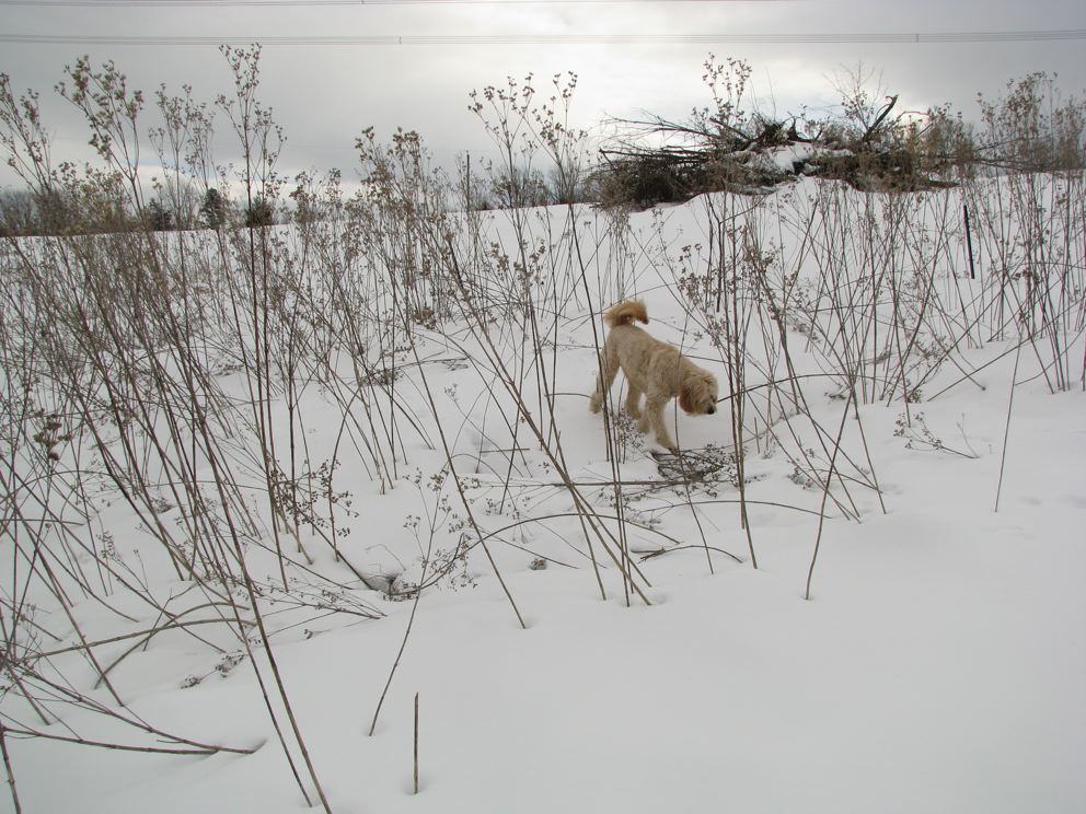

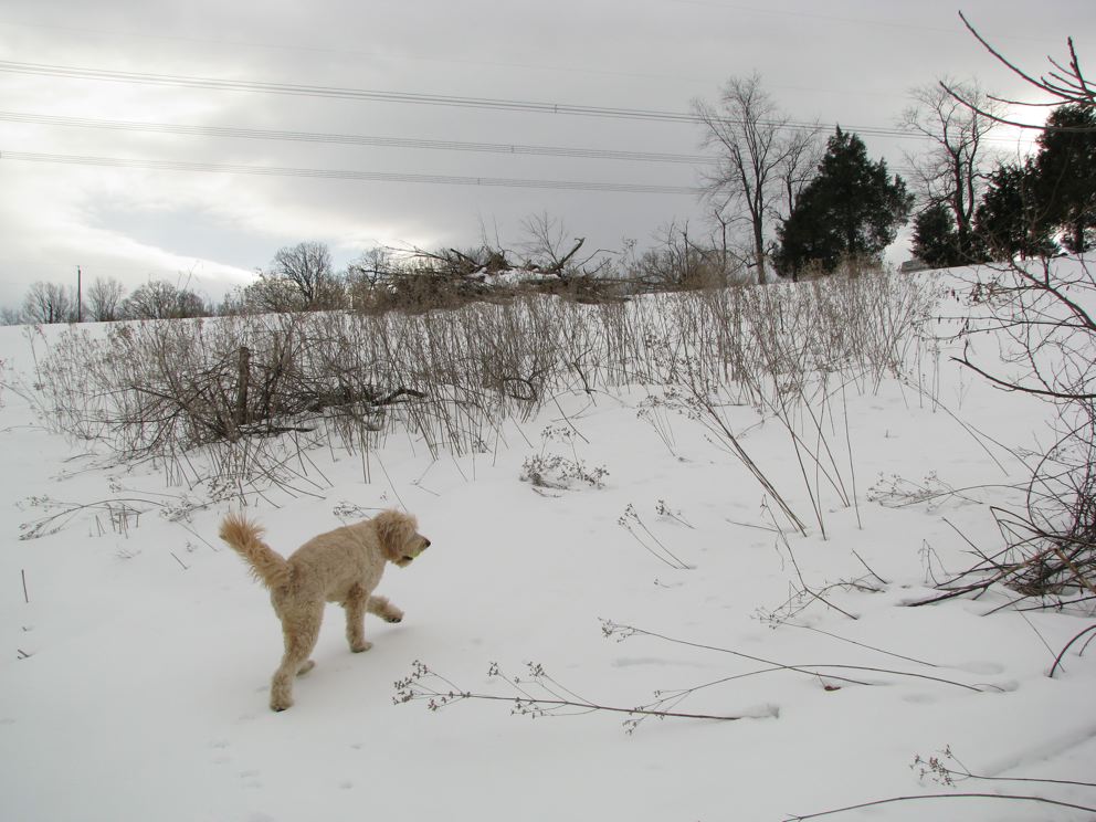

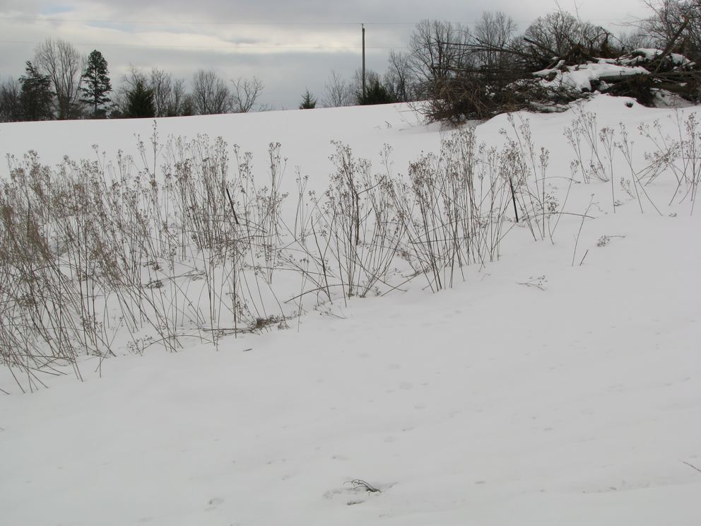

We have about 10" of snow on the ground now, but Ill take a pic this afternoon.. the dips are quite noticeable..
Brian
   / Would a tooth bar do this..
#30
As promised here are a few pics.. I hope they pics show the dips, the snow doesnt give a lot of contrast..
You will notice the area with the tall weeds is the area i want to smooth out.. If you look close you will sea large burn pile at the top of the hill.. From that burn pile down past the small pile of brush is the area that is too rough to ride over..
